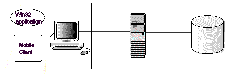

4.3 Starting a Windows 32 Application
When you have a Windows 32 (Win32) machine that is set up to interact with Mobile Server, you have an environment similar to Figure 4-1:
Figure 4-1 Windows 32 Interacting With Mobile Server
Win32 Mobile Client Figure
Figure 4-1 demonstrates how the Mobile Server accesses the Mobile Server Repository, which exists in a back-end database. The Mobile Client and client applications are on the Win32 machine. The Mobile Client database synchronizes with the Mobile Server.

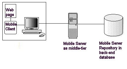

4.4 Starting a Web-Based Application
When you have a Web-based application that is set up to interact with Mobile Server, you have an environment similar to Figure 4-2:
Figure 4-2 Web-Based Application Interacting With Mobile Server
Web-based application graphic

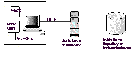

4.5 Starting an Application on Your Pocket PC Device
When you have a Pocket PC (WinCE) application that is set up to interact with Mobile Server, you have an environment similar to Figure 4-3:
Figure 4-3 Pocket PC Application Interacting With Mobile Server
WinCE application graphic

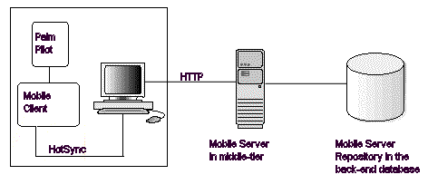

4.6 Starting a Palm OS Application
When you have a Palm OS application that is set up to interact with Mobile Server, you have an environment similar to Figure 4-4:
Figure 4-4 Palm OS Application Interacting With Mobile Server
Palm OS application graphic
To install and use the Palm OS Mobile Client, verify that you have the correct environment, retrieve the sample from the Mobile Server and install it on your machine, as follows:
Instructions for building a Palm OS application are detailed in Chapter 7, "Developing Mobile Applications for Palm OS Devices" in the Oracle Database Lite Developer's Guide.
4.6.1 Verify the Software and Hardware Requirements for the Palm OS Demo
The Palm OS sample application requires the following:
  • Software requirements: Palm Desktop 3.1 of higher and HotSync
  • Hardware requirements: Palm OS 4.0 or higher device and a device cradle
4.6.2 Download the Mobile Client from the Mobile Server
To download the Mobile Client, do the following:
  1. Open the Mobile Client Setup through the Mobile Server, as follows:
    1. In a browser on the Windows machine that supports the Palm OS device, point to the remote Mobile Server host using the URL http://<Mobile Server>/webtogo/.
    2. On the upper right corner, click Setup.
  2. Click Oracle Lite PALM.
  3. The Save As dialog box appears. The file name field displays the executable setup file for the selected platform. Save the executable to a local directory on your Windows machine.
4.6.3 Install the Palm OS Mobile Client
You install the Mobile Client on your Palm OS device by performing the following steps:
  1. Navigate to the local directory on the Windows machine that supports the Palm OS device and double-click the Mobile Client setup.exe.
    This copies the Mobile Client libraries into the Palm download folder.
  2. Execute a HotSync and select the appropriate user. This installs the Palm libraries onto the Palm OS device.
  3. On the Palm OS device, launch Mobile Sync application by double-clicking on mSync.
  4. On the Mobile Sync dialog box, enter the following:
    • Username: JUNIUS
    • Password: JUNIUS
    • Check the Save Password checkbox
    • IP address of the Mobile Server
    Click Sync.
  5. Click the OK button when synchronization succeeds. The download of the Mobile Client is complete.
