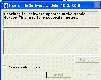

3.4 Initiating Updates of Oracle Database Lite Software from the Client
On Windows clients, you can initiate a request for software updates from the Mobile Server by executing the Oracle Lite Update tool, as shown in Figure 3-3. To execute, choose Oracle Lite Update from the Oracle Database Lite Programs list.
Figure 3-3 Updating Oracle Database Lite Software
Oracle Lite Software Update GUI
When updates are located, you can select items that you do not want to update and click Remove. When all updates are satisfactory, click Install. When you are finished, click Exit.
If you check the Disable Auto Update checkbox, then you must execute this tool to receive software updates in the future. You can also disable automatic updates from the Mobile Manager. See Section 8.4.3, "Allowing Software Upgrades to All Mobile Devices in a Platform" for more information.
