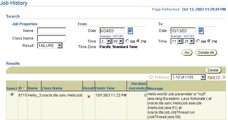

7.2.4 Managing the Job History List
The number of current registered jobs in the Job History list is listed on the Job Scheduler home page under the Status Date line. Click on the number displayed to bring up the Job History page. The Job History page enables you to provide criteria to search, sort, and manage the job history based on job properties—such as name, class name, result, or a specific date and time. Based on your search criteria, the Job History page displays job history details under the Results section.
Figure 7-2 displays the Job History page.
Figure 7-2 Job History Page
You can sort the messages by any of the headers. For example, to sort the job history details by name, click Name in the header title region. It toggles between A-Z and Z-A.
To delete a single job, select the job and click Delete. To delete all job history entries that match your search criteria, click Search and Delete.

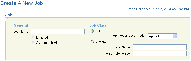

7.3.1 Creating a New Job
In order to create a new job, you create the schedule of how often and when an existing application is executed. To create this schedule, navigate to the Job Scheduler Administration screen and click Create A New Job.
Figure 7-3 displays the top section of the Create a New Job page. Give the job a name, select the checkbox for Enabled to enable the job (or leave blank to leave disabled), and select the checkbox for Save to Job History if you want a record of this application executing.
Under the Job Class section, if this is for the MGP process, then select if this is for Apply Only or Apply and Compose. The MGP process can be modified to perform only application of new and modified records from the clients. This is beneficial for applications that never have to update information from the back-end server database. Choosing Apply Only saves performance if it is relevant for your application. For example, if you had a company that performed a lot of updates throughout the day, but no one needed to know the new information until the next day, you could schedule an MGP process to perform Apply Only all day to update the repository, and schedule another MGP process that executes only at night with Apply/Compose to perform the last updates and then bring down all of the days modifications to all of the users.
If this is not for an MGP process, then enter the class name to be executed for this job and any parameter values. Since you design the class, enter the parameter as you have designed the parameter format. There are two default jobs, which are described in Section 7.3.5, "Default Jobs".
Figure 7-3 Create a New Job - Top Section

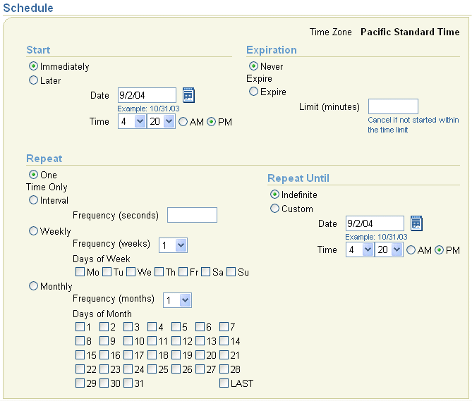

Figure 7-4 displays the bottom section of the Create a New Job page, which is where you define when and how often your job executes.
Figure 7-4 Create a New Job - Bottom Section
Enter data in the Create a New Job page as described in the following tables.
Table 7-1 describes data that must be entered in the Start section.
Table 7-1 Start Details Description - Schedule Section
Field Description Required
Immediately To start the job immediately, select this option. Optional
Later To start the job at a later time, select this option and specify the date and time when this job is to start. Optional
Table 7-2 describes data that must be entered in the Expiration section.
Table 7-2 Expiration Details Description - Schedule Section
Never Expire To ensure that the chosen job schedule does not expire—that is, this job always executes—select this option. Optional
Expire If you want the job to expire after a specified number of minutes—even if it has not execute yet—then specify the number of minutes in this field.
The Job Scheduler cancels jobs that do not start at the specified time. However, it does not stop jobs that have already started.
Optional
Table 7-3 describes how often the job executes in the Repeat section.
Table 7-3 Repeat Details Description - Repeat Section
One Time Only The job executes only once. Optional
Interval The job executes after a specified interval has passed. The interval duration between execution of the job is defined in seconds. Optional
Weekly The job executes on the specified day of the week. You can specify an interval of whether this executes weekly (1 in the Frequency pulldown), every other week (2 in the Frequency pulldown) and so on. Optional
Monthly The job executes on a specified day of the month. Same as above, but with the months of the year. Optional
Table 7-4 defines whether the chosen schedule repeats indefinitely or whether you want it to execute only on a certain date/time.
Table 7-4 Repeat Until Details Description - Repeat Section
Indefinite To repeat the job schedule indefinitely, select this option. Optional
Custom To specify how long this job executes until, specify the date and time of when the job is canceled. Optional
To implement the job schedule after specifying changes to the schedule, click OK. To retain or restore previous job schedule values, click Cancel.
