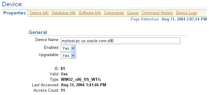

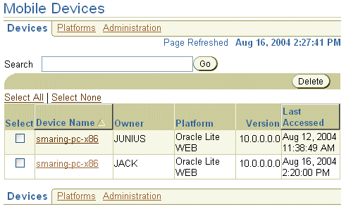

8.3 Viewing Device Information
From the Mobile Devices screen, as shown inFigure 8-2, select the device that you want to know more about.
Figure 8-3 shows the specific device page that comes up when you select the device that you are interested in. The Properties screen is the first set of information available.
Figure 8-3 Mobile Device Properties and Information
All of the device information
On the Mobile Device Properties screen, you are told the following about the device:
Each of the tabs at the top provides more information about the device. Use this information to determine what sort of administration each one needs in order to continue to operate smoothly. You can use this information to tell what needs to be upgraded on each device. The following sections covers each of these tabs.

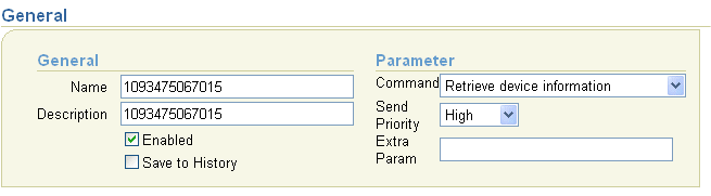

  2. As shown in Figure 8-5, configure the following:
    • The name and descriptor are unique identifiers. You can modify them to your own unique identifiers.
    • Choose the command that you want to schedule from the Parameter Command pull-down list.
    • Check the Enabled box to enable or disable the command. If disabled, the command cannot be executed.
    • Check Save to History if you want to keep a log of when this is executed and the results, which are printed to the Command History screen.
    • Choose from the Priority pull-down list if this is to be high, medium, or low priority. This determines in what order the scheduled commands are executed.
    • Enter any expected parameter values, separated by semi-colons, in the Extra Parameter field. For example, if you chose the Synchronize databases command and you wanted a fast refresh, you would enter 'fast' in the Extra parameter field.
      You cannot use fast refresh synchronization with high priority restricting predicate.

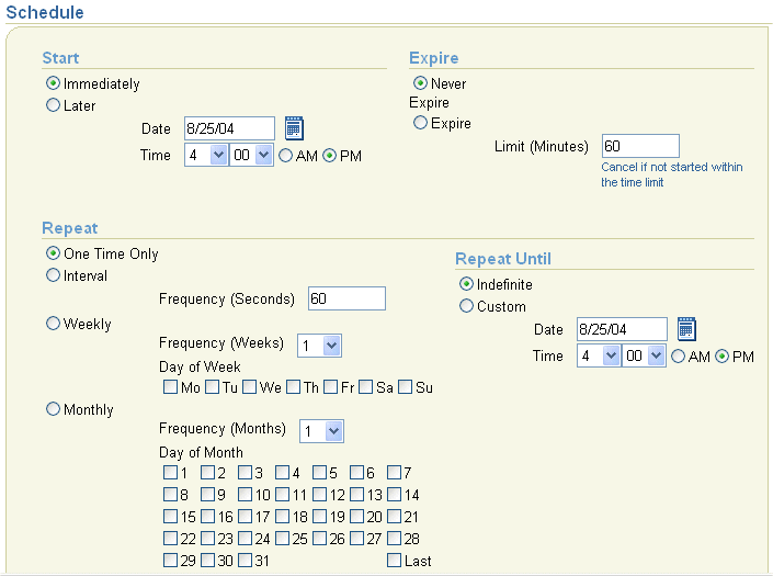

  3. As Figure 8-6 shows, enter the timing that the command is to execute. Choose when it is to start, when it will expire (if it does not execute within a certain time frame), how often it will repeat, and a date and time that it will repeat until.
    Figure 8-6 Timing Section of the Command Scheduler
    Schedule Commands
  4. Click Apply. The Mobile Manager displays a confirmation message.

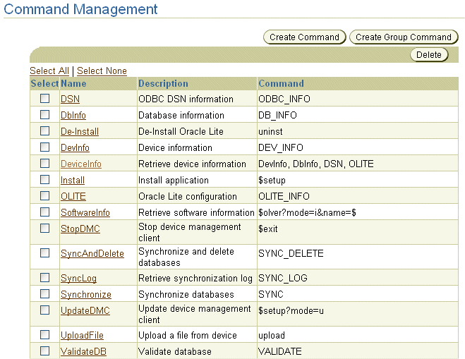

8.6.2 Modifying Existing Commands
To view the available commands, select the Mobile Devices tab on the Mobile Manager. Navigate to the Administration page and click the Command Management link. As Figure 8-7 displays, the Command Management page appears.
Figure 8-7 Command Management Page
The Command Management page.
Using the Command Management page, you can modify existing device commands and create new device commands. To modify existing commands, do the following:

8.6.3 Creating New Commands
You can create commands using the OTL scripting language, as described in Section 8.11, "Defining Device Manager Commands With the Device Manager OTL Tag Language". These commands are then used to perform activity on the Mobile devices, but controlled by the administrator within the Mobile Manager.
You can create a command with a single or multiple OTL script commands. Each is created in a different manner, as described in the following sections:
To create new commands, click Create Command. Enter a unique Command ID, Command String, and Description in the corresponding fields. Click the Create button. The Mobile Manager displays a confirmation message.
To create a command that has several lines, you must perform the following:
  1. Create a file with an .otl extension with the OTL commands in it. Place this file in the ORACLE_HOMEmobile_oc4j\j2ee\mobileserver\applications\mobileserver\setup\dmc\otl directory.
  2. With any editor, add all OTL commands that you want executed within the file. See Section 8.11, "Defining Device Manager Commands With the Device Manager OTL Tag Language" for a full description of the OTL scripting language.
  3. Within Mobile Manager, navigate to the Command Management page.
  4. Click Create Command.
  5. In the Name field, pick a short name to identify the command within Mobile Manager.
  6. In the Command field, put the name of the OTL file, without the .otl extension.
  7. In the Description field, type in a sentence describing accurately the purpose of the command.
  8. Click OK.
  9. Back on the Command Management screen, select the command that you just created.
  10. Click Syntax Check to ensure that you entered in your OTL commands correctly.
  11. Click Apply.
  12. If you ask the user to enter parameters, then add the parameter definitions. See Section 8.6.2.1, "Adding Parameters to Mobile Device Commands" for a full description.
  13. Push the OTL script to device.
You have now successfully created a new command. You can now execute this command against your Mobile devices. See Section 8.6.1, "Scheduling or Sending Commands" for information on how to execute the command.

8.6.5 Enabling or Disabling Mobile Device Commands
By default, all commands are enabled, which means that you can execute the command. If you want to disable a command, so that it can no longer be executed, do the following:
  1. From the Mobile Devices page, click Administration.
  2. Choose Command Management.
  3. Select the command that you want to enable or disable.
  4. Select either Yes for enable or No for disable on the Enabled pull-down.
  5. Click Apply.

8.7.3 Controlling Device Software Updates
The administrator can control what software updates occur either through modifying the Upgradable switch in the Mobile Manager or by programmatically defining what types of updates can occur. There are two types of software update that you can control, as detailed in the following sections:
8.7.3.1 Enabling Software Updates for the Oracle Lite Platform
You can disable the Oracle Database Lite platform updates for the devices through one of two methods:
  • Setting Upgradable to No—Change the value of Upgradable in the Mobile Manager GUI to No, as follows:
    1. Select the Mobile Devices tab in Mobile Manager.
    2. Select the Platform tab to display all Oracle Lite Platforms.
    3. Click Oracle Lite WIN32 platform to display its properties.
    4. Change the value of Upgradable to No. Click OK.
  • Setting the UPDATE_SOFTWARE attribute in the Resource Manager to false. This has to be set programmatically on the Resource Manager object, as follows:
    rs.setAttribute (ResourceConst.UPDATE_SOFTWARE, "false");
If you want to disable any application updates, but continue to allow Oracle Database Lite platform updates, then set the UPDATE_SOFTWARE_APPS attribute to false.
For example, to set the UPDATE_SOFTWARE_APPS attribute to false, do the following:
rs.setAttribute (ResourceConst.UPDATE_SOFTWARE_APPS, "false");
For a full example of how to set the Resource Manager attributes, see ORACLE_HOME\Mobile\Server\samples\devmgr\java\AppUpdate.java.

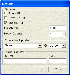

8.8 Using the Device Management Client GUI to Manage Device on Client-side
On any client—except for the Palm clients—you can manage the Mobile device client software, as shown in Figure 8-8.
Figure 8-8 Using the Oracle Lite Device Manager to Manage Your Device
To bring up the Device Manager GUI, choose Oracle Lite Device Manager from the Oracle Database Lite Programs list. The main screen provides information about the following: platform with type of platform, language, and version, the owner/user of this device, the name of the device, and the URL of where the device is installed.
