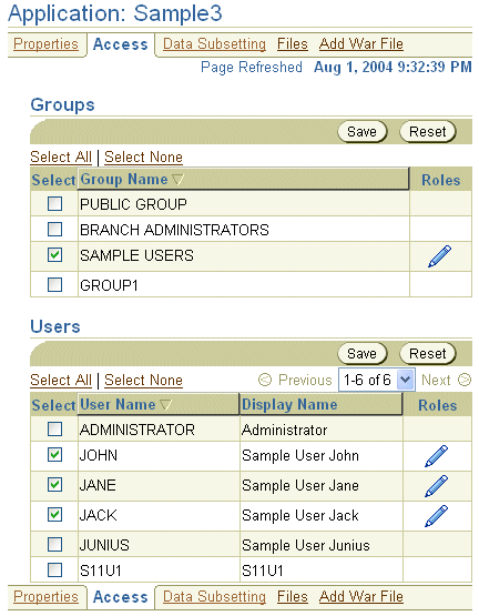

Similar to Data Subsetting, you can set the access privileges for the application either from the Users page or from the Applications page—except for groups. Groups can only be given access to applications from the Applications page. See Section 5.2.1, "Grant or Revoke Application Access to Users" for directions on how to manage the access privileges from the user page.
The Mobile Server Administrator grants access privileges to Mobile applications by designating the users that can access these applications. This section enables an administrator to grant or revoke application access to users and groups. Topics include:
The administrator can grant access to applications for specific users within the Mobile Manager, as follows:
Navigate to the Applications page. Click the specific application that you wish to modify. The Properties page appears.
Click Access. The Access page displays a list of users and groups for this application.
Select the checkbox next to each user or group that you wish to give access to for this particular application.
Click Save.
As Figure 4-3 displays, the Access page displays a list of available users and groups for the Sample3 application. Select the users or groups that you want Sample3 to have access to and click Save. In this example, the administrator granted access for the Sample3 application to the SampleUsers group and to the users: John, Jane, and Jack.
Note: Once you provide access to a group, all users in that group have access to this application. |
