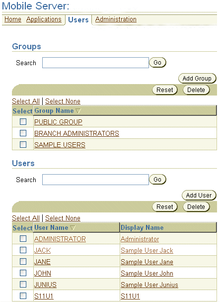

5.1.2 Displaying Users
You can see what users and groups have been created with all information relevant to users—such as user names and so on. If you are using OID as your repository, then the users that exist within OID are also displayed, but are not enabled for Mobile Server. You can enable these users within OID by checking the Enabled box next to the name on the Users screen.
To display individual users, logon to the Mobile Manager and click the Mobile Manager link in the Workspace. As displayed in Figure 5-1, the Mobile Servers Farm page is displayed.
Figure 5-1 Mobile Server Farms Page
The Mobile Server Farms page.
Click your Mobile Server name link. Your Mobile Server home page appears. Click the Users link. As Figure 5-2 displays, the Users page lists existing groups and individual users.
Searching Group Names or User Names
To search for a group name or individual user name, enter the group name or user name in the Search field and click Go. The Users page displays the search result under the Group Name or User Name column.

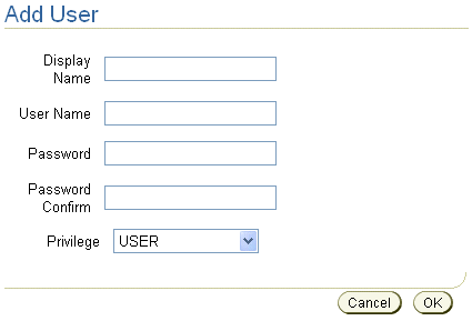

5.1.3 Adding New Users
To add a new user, navigate to the Users page and click Add User. As Figure 5-3 displays, the Add User page appears and lists the requisite criteria to register user properties.
To register user properties for new users, Table 5-1 describes values that must be entered in the Add User page.
Table 5-1 Add User Page Description
Field Description
Display Name Name used to display as Mobile Server user name.
User Name Name used to logon to the Mobile Server.
Password Optional. Password used to logon to the Mobile Server.
Password Confirm Optional. To confirm the above mentioned password, re-enter your password.
Privilege Lists available privileges for the Mobile Server user.
  • The Administrator option provides privileges to modify Mobile Server resources.
  • The User option provides access for registered users to the Mobile Server.
For a description of each privilege type, see Section 5.1.1, "What Are Mobile Server Users?"
Enter the user information as described in the above table and click OK.
User names and passwords can only contain single-byte characters and cannot contain characters such as ', ", @ ,% or blank spaces.

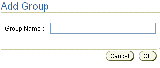

5.1.4 Adding New Groups
If you have several users that require access to the same application, you can bypass adding access rights for each user by including these users in a group. Once all of the users are included in a group, then assign access to the intended application to the group; at this point, all users in the group have access to the application.
As an administrator, you can add a new group that accesses the Mobile Server. To add a new group, navigate to the Users page and click Add Group. As Figure 5-4 displays, the Add Group page appears and lists the requisite criteria to register user group properties.
Enter the new group name in the Group Name field and click OK.

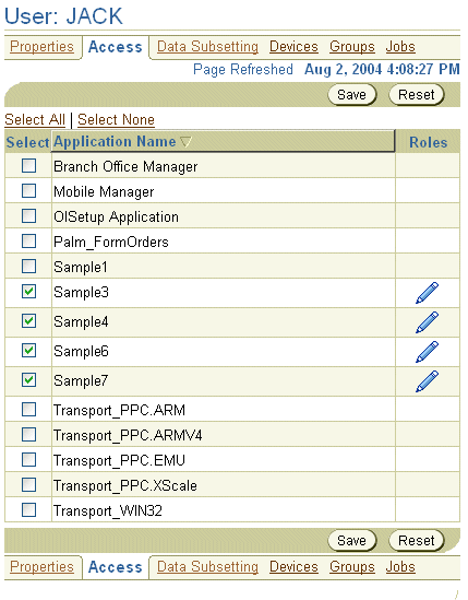

5.2.1 Grant or Revoke Application Access to Users
This section enables an administrator to grant or revoke application access to users and groups. Topics include:
Grant Application Access to Users
The administrator can grant access to applications for specific users within the Mobile Manager, as follows:
  1. Navigate to the Users page. Click the specific user name to which you wish to give access. This user's Properties page appears.
  2. Click Access. The Access page displays a list of published applications.
  3. Select the checkbox next to each application that you wish to give access to for this particular user.
  4. Click Save.
As Figure 5-5 displays, the Access page displays a list of available applications for the user Jack. Select the applications that you want Jack to have access to and click Save. In this example, Jack is given access to Sample1, Sample3, Sample4, Sample6, and Sample7 applications.
Figure 5-5 Granting Application Access
This image displays the Access page.

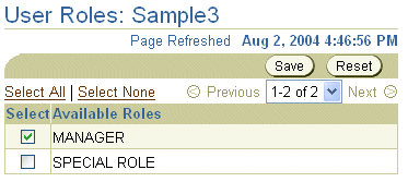

5.4 Assigning Application Roles to Users
When the developers design any Web-to-Go application, they can include functionality that is enabled based on the role that the user is assigned. For example, if you have a manager and employee role in an application, the user who is assigned the manager role may have other options available to view on the application GUI. These options would not show up for those users who are assigned the employee role. See Section 4.2.2, "Application Roles" and Section 2.5.5, "Granting Roles" in the Oracle Database Lite Developer's Guide for information on how to programmatically create and grant these roles.
Once the application is deployed, all roles are displayed and can be assigned to any user in the Mobile Manager. You can assign roles either through the Mobile Manager or through the wsh script. This section describes how to assign users to certain roles for a Web-to-Go application.
Figure 5-5 displays the User page for Jack. Notice that there is a column for Roles. If you click the pencil icon in this column, you can see the roles that have been created in the application. For example, if we click on the pencil icon for the Sample3 application, as shown in Figure 5-7, we see that two roles have been created in this application: Manager and Special Role. Select the checkbox next to any of the roles to which you want Jack to be added. In this case, the Manager role is checked, so Jack will be added to the Manager role.
Figure 5-7 Add Jack to the Sample3 Application Manager Role
Add User to Role
