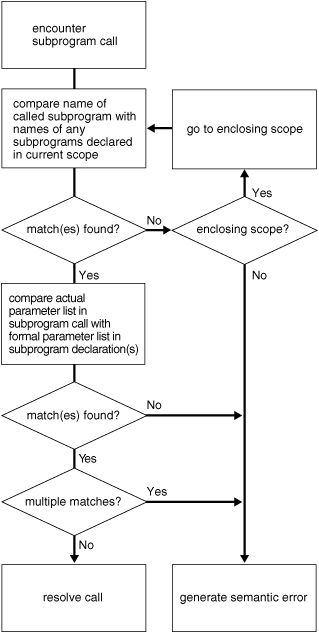

You can declare subprograms in any PL/SQL block, subprogram, or package. The subprograms must go at the end of the declarative section, after all other items.
You must declare a subprogram before calling it. This requirement can make it difficult to declare several nested subprograms that call each other.
You can declare interrelated nested subprograms using a forward declaration: a subprogram spec terminated by a semicolon, with no body.
Although the formal parameter list appears in the forward declaration, it must also appear in the subprogram body. You can place the subprogram body anywhere after the forward declaration, but they must appear in the same program unit.

Figure 8-1 shows how the PL/SQL compiler resolves subprogram calls. When the compiler encounters a procedure or function call, it tries to find a declaration that matches the call. The compiler searches first in the current scope and then, if necessary, in successive enclosing scopes. The compiler looks more closely when it finds one or more subprogram declarations in which the subprogram name matches the name of the called subprogram.
To resolve a call among possibly like-named subprograms at the same level of scope, the compiler must find an exact match between the actual and formal parameters. They must match in number, order, and datatype (unless some formal parameters were assigned default values). If no match is found or if multiple matches are found, the compiler generates a semantic error.
Example 8-10 calls the enclosing procedure swap
from the function balance
, generating an error because neither declaration of swap
within the current scope matches the procedure call.

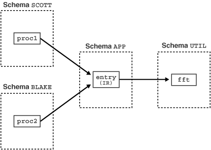

A definer's rights subprogram operates under the security domain of its owner, no matter who is executing it. The owner must have the privileges needed to access schema objects referenced by the subprogram.
You can write a program consisting of multiple subprograms, some with definer's rights and others with invoker's rights. Then, you can use the EXECUTE
privilege to restrict program entry points. That way, users of an entry-point subprogram can execute the other subprograms indirectly but not directly.
Suppose user UTIL
grants the EXECUTE
privilege on subprogram FFT
to user APP
GRANT EXECUTE ON util.fft TO app;
Now, user APP
can compile functions and procedures that call subprogram FFT
. At run time, no privilege checks on the calls are done. As Figure 8-2 shows, user UTIL
need not grant the EXECUTE
privilege to every user who might call FFT
indirectly.
Since subprogram util.fft
is called directly only from invoker's rights subprogram app.entry
, user util
must grant the EXECUTE
privilege only to user APP
. When UTIL.FFT
is executed, its current user could be APP
, SCOTT
, or BLAKE
even though SCOTT
and BLAKE
were not granted the EXECUTE
privilege.
