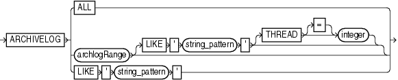

archlogRange::=
A subclause used to specify an archived log or range of archived redo logs files for use in backup, restore, recovery, and maintenance operations.
When backing up archived redo logs, RMAN can perform archived log failover automatically. RMAN backs up the log when at least one archived log corresponding to a given log sequence number and thread is available. Also, if the copy that RMAN is backing up contains corrupt blocks, then it searches for good copies of these blocks in other copies of the same archived logs.
Specifying a range of archived redo logs does not guarantee that RMAN includes all redo data in the range: for example, the last available archived log file may end before the end of the range, or an archived log file in the range may be missing from all archiving destinations. RMAN includes the archived redo logs it finds and does not issue a warning for missing files.

environment variables to specify the format for the time, see Oracle Database Reference.Syntax Element | Description |
ALL |
Specifies all available archived logs. |
LIKE ' string_pattern ' |
Specifies all archived logs that match the specified string_pattern . The same pattern matching characters that are valid in the LIKE operator in the SQL language can be used to match multiple files.
See Also: Oracle Database Oracle Clusterware and Oracle Real Application Clusters Administration and Deployment Guide to learn about using RMAN in a RAC configuration |

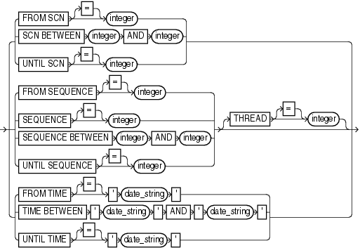

FROM SCN = integer |
Specifies the beginning SCN for a sequence of archived redo log files. If you do not specify the UNTIL SCN parameter, RMAN will include all available log files beginning with SCN specified in the from SCN parameter. |
SCN BETWEEN integer AND integer |
Specifies a range of SCNs. SCN BETWEEN integer1 AND integer2 is exactly equivalent to FROM SCN integer1 UNTIL SCN integer2 . |
UNTIL SCN = integer |
Specifies the ending SCN for a sequence of archived redo log files. If you do not specify the FROM SCN parameter, then RMAN will start with the earliest available archived log.
If the database is open when you run |
FROM SEQUENCE integer |
Specifies the beginning log sequence number for a sequence of archived redo log files. If you do not specify the UNTIL SEQUENCE parameter, RMAN will include all available log files beginning with log sequence number specified in the FROM SEQUENCE parameter.
Note: You can specify all log sequence numbers in a thread by using the following syntax, where
... ARCHIVELOG FROM SEQUENCE 0 THREAD thread_number
SEQUENCE |
Specifies either a single log sequence number or a range of sequence numbers. If the database is open when you run BACKUP ARCHIVELOG , and if the SEQUENCE keyword is specified, then RMAN does not run ALTER SYSTEM ARCHIVE LOG CURRENT . |
integer |
Specifies a single log sequence number. |
Specifies a range of log sequence numbers. SEQUENCE BETWEEN integer1 AND integer2 is exactly equivalent to FROM SEQUENCE integer1 UNTIL SEQUENCE integer2 . |
UNTIL SEQUENCE = integer |
Specifies the terminating log sequence number for a sequence of archived redo log files. If you do not specify the FROM SEQUENCE parameter, RMAN uses the lowest available log sequence number to begin the sequence.
FROM TIME = 'date_string ' |
Specifies the beginning date for a sequence of archived redo log files. The clause specifies those logs that could be used in a recovery starting at the indicated time.
The time specified in the string must be formatted according to the Globalization Technology date format specification currently in effect, but can also be any SQL expression with the If you do not specify the Note: The See Also: Oracle Database Reference for information on how to use the |
TIME BETWEEN ' date_string ' AND 'date_string ' |
Specifies a range of times. Note that TIME BETWEEN ' date_string ' AND ' date_string ' is exactly equivalent to FROM TIME ' date_string ' UNTIL TIME ' date_string ' . |
UNTIL TIME = ' date_string ' |
Specifies the end date for a sequence of archived redo log files. The clause specifies those logs that could be used to recover to the indicated time.
The time specified in the string must be formatted according to the Globalization Technology date format specification currently in effect, but can also be any SQL expression with the If you do not specify the If the database is open when you run Note: The See Also: Oracle Database Reference for information on how to use the |
THREAD = integer |
Specifies the thread containing the archived redo log files you wish to include. You only need to specify this parameter when running the database in an Oracle Real Application Clusters (RAC) configuration.
