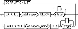

You can either use BLOCKRECOVER CORRUPTION LIST to recover all blocks reported in the V$DATABASE_BLOCK_CORRUPTION view, or specify the datafile number and block number or the tablespace and data block address (DBA) when executing the BLOCKRECOVER command.

bmrBlockSpec |
Specifies the data blocks that require recovery. |
CORRUPTION LIST |
Recovers all blocks listed in the V$DATABASE_BLOCK_CORRUPTION view. This view displays blocks marked corrupt by the most recent BACKUP (with or without the VALIDATE option), VALIDATE, or CREATE CATALOG command. The following types of corruption result in rows added to this view:
DATAFILE datafileSpec |
Specifies a list of one or more datafiles that contain blocks requiring recovery.
See Also: "datafileSpec" |
BLOCK integer |
Specifies the block number of the block requiring media recovery. Typically, the block number is obtained from error message output. |
TABLESPACE tablespace_name |
Specifies the tablespace name or number containing the corrupt blocks. |
DBA integer |
Specifies the data block address (DBA) of the corrupt block. |

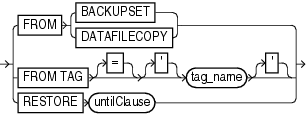

bmrOption |
Specifies various restore options relating to the block recovery. |
FROM BACKUPSET |
Indicates that only backup sets should be restored. |
FROM DATAFILECOPY |
Indicates that only datafile image copies should be restored. |
FROM TAG= 'tag_name' |
Indicates that only the copy of the backup with the specified tag should be restored. Tag names are not case sensitive.
See Also: "BACKUP" to learn how a tag is applied to a copy of a backup. |
RESTORE untilClause |
Specifies that only backups and copies created before the specified time, SCN, or log sequence number should be restored.
