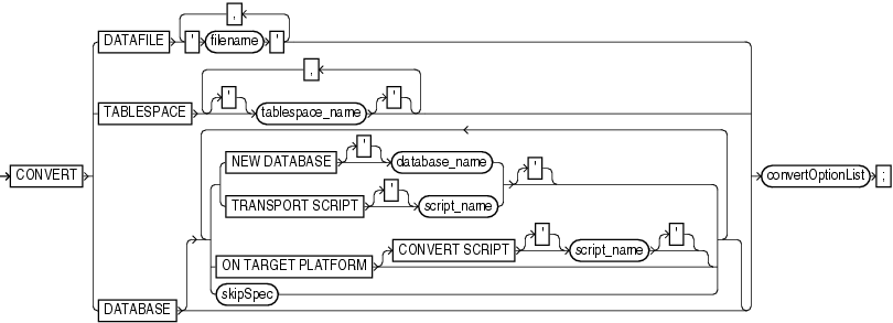

Syntax Element | Description |
DATABASE |
Used to transport entire databases across platforms (where the source and destination platforms have the same endian format). |
NEW DATABASE
Specifies the DB_NAME for the new database produced by the CONVERT DATABASE command. |
ON TARGET PLATFORM |
Specifies that any CONVERT commands required for datafiles should be performed on the destination platform rather than the source database. Useful if you do not want the overhead of the conversion on the source platform, or if you do not know the destination platform (for example, if you are publishing a transportable tablespace to be used by recipients with many different target platforms). |
CONVERT SCRIPT
Specifies the location of the file to contain the convert script generated by CONVERT DATABASE ... ON TARGET PLATFORM . If not specified, the convert script is not generated. |
skipSpec | Specifies that CONVERT DATABASE should skip inaccessible, offline or read-only files during the conversion process. |
TRANSPORT SCRIPT
Specifies the location of the file to contain the transport script generated by CONVERT DATABASE . If omitted, the transport script is not generated. |
DATAFILE
Specifies the name of a datafile that you want to transport into the destination database.
TABLESPACE
Specifies the name of a tablespace in the source database that you want to transport into the destination database on a different platform. CONVERT TABLESPACE can only be used when connected to the source database and converting on the source platform. |

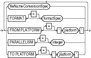

fileNameConversionSpec |
A set of string pairs. Whenever any of the input filenames contains one of the first halves of a pair, anywhere in the filename, it will be replaced with the second half of the same pair.You can use as many pairs of replacement strings as required. You can use single or double quotation marks. |
FORMAT formatSpec |
Specifies the name template for the output file(s). See the BACKUP AS COPY command for the format values that are valid here. |
FROM PLATFORM = platform_name |
Specifies the name of the source platform. This must be one of the platforms listed in the PLATFORM_NAME column of the V$TRANSPORTABLE_PLATFORM view. |
PARALLELISM [=] integer |
Specifies the number of channels to be used to performing the operation. If not used, then channels allocated or configured for disk determine the number of channels. |
TO PLATFORM = platform_name |
Specifies the name of the destination platform as displayed in the V$TRANSPORTABLE_PLATFORM.PLATFORM_NAME output. If used on the destination platform, then this must be the value for the destination platform in V$TRANSPORTABLE_PLATFORM.PLATFORM_NAME . |
