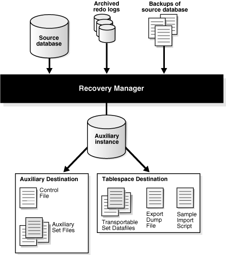

Figure 14-1 RMAN Transportable Tablespace From Backup: Architecture
The elements in the diagram and the process RMAN performs are described in the discussion which follows.
The process by which transportable tablespace sets are created with RMAN is closely related to the process for performing TSPITR, as discussed in Chapter 8, "RMAN Tablespace Point-in-Time Recovery (TSPITR)". If you are familiar with that process, you will find this one similar.The figure contains the following entities:
The Recovery Manager client
The source database, containing the tablespaces to be transported
Archived redo logs and backups from the source database, used in restore and recovery of the tablespaces being transported
The auxiliary instance, an Oracle database instance which is created by RMAN on the same host as the source database, to perform the restore and recovery of the tablespaces, and, if the process succeeds, cleaned up afterwards.
The auxiliary set, which includes datafiles and other files required for the tablespace transport process but which are not themselves part of the recovery set. The auxiliary set typically includes:
A copy of the SYSTEM and SYSAUX tablespaces
Undo tablespaces and datafiles containing rollback or undo segments from the source database
The auxiliary instance has other files associated with it, such as its own control file, parameter file, and online logs, but they are not part of the auxiliary set.
The auxiliary destination, a location on disk where auxiliary set files, such as the parameter file, datafiles (other than those of the tablespaces being transported), control files and online logs of the auxiliary instance can be stored while the RMAN TRANSPORT
TABLESPACE
process is running. If the transport process succeeds, these files are deleted.
Specifying an auxiliary destination is optional; however, if you do not use one, you must ensure that locations are specified for all auxiliary instance files, including all datafiles and online log files, using the initialization parameters of the auxiliary instance.Oracle recommends the use of an auxiliary destination to simplify the use of TRANSPORT
TABLESPACE
. See the rules described in "Customize Other Auxiliary File Locations in TRANSPORT TABLESPACE" for details on the extra steps required if you do not use an auxiliary destination.
The tablespace destination, a location on disk which (by default) contains the datafile copies and other output files when the tablespace transport command completes
The transportable set, which consists of the datafiles from the tablespaces to be transported and an export dump file (generated using Data Pump Export) for use when plugging in the tablespaces at a destination database
The sample import script (generated by RMAN) for use in plugging the tablespaces in at a target database, and an export log containing the output from Data Pump Export
All of these terms will be referenced throughout the remainder of this discussion.
