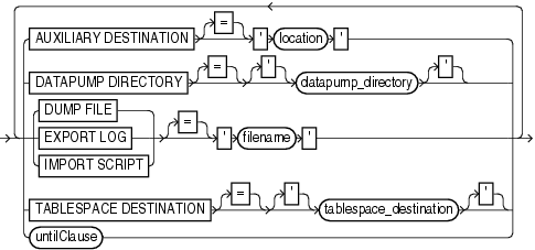

Syntax Element | Description |
tablespace_name |
Specifies the name of each tablespace to transport. |
AUXILIARY DESTINATION |
Optional argument that specifies the location for files for the auxiliary instance. The SET NEWNAME and CONFIGURE AUXNAME can be used to override this argument for individual files, and the DB_FILE_NAME_CONVERT and LOG_FILE_NAME_CONVERT initialization parameters can be used instead of AUXILIARY DESTINATION , if using your own initialization parameter file to customize the auxiliary instance. See Oracle Database Backup and Recovery Advanced User's Guide for details on the interactions among the different methods of naming the auxiliary instance files. |
DATAPUMP DIRECTORY |
Optional argument that specifies a database directory object where Data Pump Export outputs are created. If not specified, files will be created in the location specified by TABLESPACE DESTINATION . See Oracle Database Utilities for more details on Data Pump Export and database directory objects. |
DUMP FILE |
Optional argument that specifies where to create the export dump file. If not specified, the export dump file is named dmpfile.dmp and stored in the location specified by the DATAPUMP DIRECTORY clause or in the tablespace destination. |
EXPORT LOG |
Optional argument that specifies the location of the log generated by Data Pump Export. If omitted, the export log is named explog.log and stored in the location specified by the DATAPUMP DIRECTORY clause or in the tablespace destination. |
IMPORT SCRIPT |
Optional argument that specifies the filename for the sample input script generated by RMAN for use in plugging in the transported tablespace at the destination database. If omitted, the import script is named impscript.sql . The script is stored in the tablespace destination. |
TABLESPACE DESTINATION |
Argument that specifies the directory where the datafiles for the transported tablespaces are left at the end of the tablespace transport operation. |
untilClause |
Optional argument that specifies a past point in time. If specified, RMAN restores and recovers the tablespaces at the auxiliary instance to their contents at that past point in time before export. |
Creating Transporable Tablespaces from Backup with TRANSPORT TABLESPACE: Example In this example, the tablespaces for the transportable set are tbs_2
and tbs_3
, the transportable set files are to be stored at /disk1/transport_dest
, and the transportable tablespaces are to be recovered to the present time:
transport tablespace tbs_2, tbs_3 tablespace destination '/disk1/transportdest' auxiliary destination '/disk1/auxdest' ;
Using TRANSPORT TABLESPACE with a Past Point in Time: Example In this example, the tablespaces for the transportable set are tbs_2
and tbs_3
, and the transportable tablespaces are to be recovered to a specific SCN:
transport tablespace tbs_2, tbs_3 tablespace destination '/disk1/transportdest' auxiliary destination '/disk1/auxdest' UNTIL SCN 251982; ;
Using TRANSPORT TABLESPACE with Custom File Locations: Example This example illustrates the use of the optional arguments of TRANSPORT
TABLESPACE
that control the locations of the Data Pump-related files such as the dump file, as well as the DATAPUMP
DIRECTORY
which in this case references a directory object mypumpdir
TRANSPORT TABLESPACE tbs_2 TABLESPACE DESTINATION '/disk1/transportdest' AUXILIARY DESTINATION '/disk1/auxdest' DATAPUMP DIRECTORY mypumpdir DUMP FILE 'mydumpfile.dmp' IMPORT SCRIPT 'myimportscript.sql' EXPORT LOG 'myexportlog.log';
