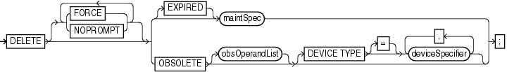

delete::=
maintSpec::=
To delete physical backups and copies as well as do the following:

| Syntax Element | Description |
FORCE |
Deletes specified files (whether or not they exist on the media) and removes repository records. RMAN ignores any I/O errors for the deleted objects. RMAN displays the number of deleted objects at the end of the job. |
NOPROMPT |
Deletes specified files without first listing the files or prompting for confirmation. The DELETE NOPROMPT command still displays each item as it is deleted.
By default, |
EXPIRED |
Removes only files whose status in the repository is EXPIRED. RMAN marks backups and copies as expired when you run a CROSSCHECK command and the files are absent or inaccessible. To determine which files are expired, run a LIST EXPIRED command.
If for some reason a backup or copy marked |
| maintSpec | Deletes files output by the BACKUP command. For maintSpec options, refer to the parameter descriptions in "maintSpec". |
OBSOLETE |
Deletes backups and datafile copies recorded in the RMAN repository that are obsolete, that is, no longer needed. In addition to obsolete datafile backups, RMAN deletes obsolete archived logs and archived log backups. RMAN determines which backups and copies of datafiles are no longer needed, which in turn determines when logs (and backups of logs) are no longer needed. RMAN considers the creation of a datafile as a backup when deciding which logs to keep.
RMAN first uses the options that you specify with obsOperandList to determine what is obsolete. If you do not specify options in obsOperandList, then RMAN uses the options specified in CONFIGURE Note: Even if you use a |
| obsOperandList | Specifies the criteria for determining which backups and copies are obsolete.
See Also: "obsOperandList" |
DEVICE TYPE deviceSpecifier |
Restricts the deletion to obsolete backups and copies created on the specified device type only.
See Also: "deviceSpecifier" |
