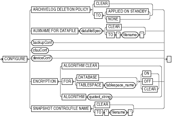

| Syntax Element | Description |
ARCHIVELOG DELETIONPOLICYTO ( APPLIED ON STANDBY | NONE | CLEAR ) |
Governs archived redo log deletion policy for the flash recovery area. Possible settings are:
AUXNAME FOR DATAFILE datafileSpec TO 'filename' |
Configures the auxiliary filename for the specified target datafile to 'filename'. For example, you can set the auxiliary name for datafile 2 to /df2.f, and then unspecify this auxiliary name by running CONFIGURE AUXNAME FOR DATAFILE 2 CLEAR.
If you are performing TSPITR or running the For example, use this command during TSPITR if the datafiles are on raw disk and you need to restore auxiliary datafiles to raw disk for performance reasons. Typically, you set the When renaming files with the See Also: Oracle Database Backup and Recovery Advanced User's Guide to learn how to perform RMAN TSPITR, and Oracle Database Backup and Recovery Advanced User's Guide to learn how to duplicate a database with RMAN |
| backupConf | Configures default backup options such as duplexing, optimization, excluding tablespaces, backup set sizes, and retention policies. |
| cfauConf | Configures control file autobackup settings |
| deviceConf | Configures default backup settings for devices, such as the default backup device, channel configurations for devices, default backup types for each device, and parallelism. |
ENCRYPTION |
Used to specify encryption settings for the database or tablespaces within the database, which apply unless overridden using the SET command. Options specified for an individual tablespace take precedence over options specified for the whole database. |
ALGORITHM
Specifies the default algorithm to use for encryption, when writing encrypted backup sets. Possible values are listed in V$RMAN_ENCRYPTION_ALGORITHMS. With CLEAR, resets the database to the default algorithm, which is AES128. |
FOR
Specifies whether to use encryption for the database or specified tablespaces. With FOR DATABASE, the effect is as follows:
Configured settings for a tablespace always override configuration set at the database level. With
With |
SNAPSHOT CONTROLFILE NAME [ TO 'filename' | CLEAR ] |
Configures the snapshot control file filename to 'filename'. If you run CONFIGURE SNAPSHOT CONTROLFILE NAME CLEAR, then RMAN sets the snapshot control file name to its default.
The default value for the snapshot control file name is platform-specific and dependent on the Oracle home. For example, the default on some UNIX system is See Also: Oracle Database Backup and Recovery Advanced User's Guide for more information about snapshot control files |

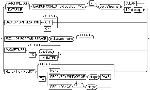

{ARCHIVELOG | DATAFILE} BACKUP COPIES FOR DEVICE TYPE [=] deviceSpecifier [CLEAR |TO integer] |
Specifies the number of copies of each backup set for DATAFILE (both datafiles and control files) or ARCHIVELOG files on the specified device type, from 1 (default) to 4. If duplexing is specified in the BACKUP command or in a SET BACKUP COPIES command, then the CONFIGURE setting is overridden.
Note: Control file autobackups on disk are a special case and are never duplexed. RMAN always writes one and only copy. Note: RMAN raises an error if you try to duplex backups to the flash recovery area. You cannot duplex backups to the flash recovery area. |
BACKUP OPTIMIZATION [CLEAR | OFF | ON ] |
Toggles backup optimization ON or OFF (default). Specify CLEAR to return optimization to its default value of OFF.
Optimization does not back up a file to a device type if the identical file is already backed up on the device type. For two files to be identical, their content must be exactly the same. You can override backup optimization by using the RMAN does not signal an error if optimization causes all files to be skipped during a backup. Note that Backup optimization is enabled when all of the following conditions are met:
The retention policy has an effect on which files backup optimization skips. See Also: Oracle Database Backup and Recovery Advanced User's Guide for a description of how RMAN determines that it can skip the backup of a file |
EXCLUDE FOR TABLESPACE tablespace_name [ CLEAR ] |
Excludes the specified tablespace from BACKUP DATABASE commands. Note that you cannot exclude the SYSTEM tablespace. By default, each tablespace is not excluded, that is, the exclude functionality is disabled. The exclusion is stored as an attribute of the tablespace, not the individual datafiles, so the exclusion applies to any files that are added to this tablespace in the future. If you run CONFIGURE ... CLEAR on a tablespace after excluding it, then it returns to the default configuration of "not excluded."
You can still back up the configured tablespace by explicitly specifying it in a |
MAXSETSIZE [ CLEAR | TO [ sizeSpec | UNLIMITED ] |
Specifies the maximum size of each backup set created on a channel. By default MAXSETSIZE is set to UNLIMITED, meaning that it is disabled.
Note: This option is ignored by |
RETENTION POLICY |
Specifies a persistent, ongoing policy for datafile and control file backups and copies that RMAN marks as obsolete, that is, not needed and eligible for deletion. As time passes, RMAN marks backups and copies as obsolete according to the criteria you specify in the retention policy. RMAN does not automatically delete any backups or copies: manually run the DELETE OBSOLETE command to remove obsolete files. By default, RETENTION POLICY is configured to REDUNDANCY 1.
For backups, the basic unit of the retention policy is a backup set (not a backup piece) or image copy. For example, |
CLEAR |
Resets the retention policy to its default (REDUNDANCY = 1). |
TO RECOVERY WINDOW OF integer DAYS |
Specifies a time window in which RMAN should be able to recover the database. The window stretches from the current time (SYSDATE) to the point of recoverability, which is the earliest date to which you want to recover. The point of recoverability is SYSDATE - integer days in the past. |
TO REDUNDANCY integer |
Specifies that RMAN should retain integer backups or copies of each datafile and control file. If more than integer backups or copies exist, RMAN marks these extra files as obsolete. Then, RMAN determines the oldest of the retained backups and copies, and marks all archived logs and log backups older than this backup or copy as obsolete. The DELETE OBSOLETE command removes obsolete backups and copies as well as archived log backups and copies. |
TO NONE |
Disables the retention policy feature. RMAN does not consider any backups or copies as obsolete. |

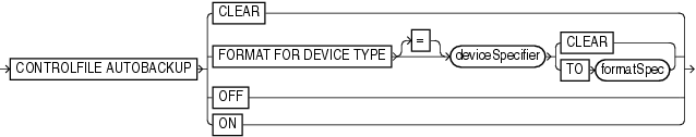

CONTROLFILE AUTOBACKUP |
Controls the control file autobackup feature. By default, this feature is not enabled. |
CLEAR |
Returns the feature to its default setting of OFF. |
FORMAT FOR DEVICE TYPE deviceSpecifier [ CLEAR | TO formatSpec ] |
Configures the default filename format for the control file autobackup on the specified device type. If a flash recovery area is enabled, then RMAN creates the disk autobackup in the flash recovery area. Otherwise, RMAN creates it in an operating system specific location (?/dbs on Unix and Windows).
By default, the initial format is
Specify The formatSpec can specify an Automatic Storage Management disk group. The following example configures a channel for an ASM disk group: CONFIGURE CONTROLFILE AUTOBACKUP FOR DEVICE TYPE DISK TO '+dgroup1'; See Also: "formatSpec", for the semantics of the |
OFF |
Disables the autobackup feature. (OFF is the default value.) When this command is OFF, any BACKUP command that includes datafile 1 (including BACKUP DATABASE) automatically includes the current control file and server parameter file in the backup set. Otherwise, RMAN does not include these files. |
ON |
If CONFIGURE CONTROLFILE AUTOBACKUP is ON (by default it is OFF), then RMAN performs a control file autobackup in the following circumstances:
The first channel allocated during the backup or copy job creates the autobackup and places it into its own backup set; for post-structural autobackups, the default disk channel makes the backup. RMAN writes the control file and the server parameter file to the same backup piece. After the control file autobackup completes, the database writes a message containing the complete path of the backup piece and the device type to the alert log. The default location for the autobackup on disk is the flash recovery area (if configured) or a platform-specific location (if not configured). RMAN automatically backs up the current control file using the default format of |

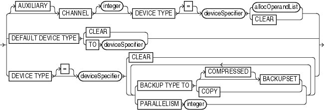

[AUXILIARY] CHANNEL [ integer ] DEVICE TYPE deviceSpecifier |
Specifies the standard or AUXILIARY channel that you are configuring or clearing, as well as the device type (DISK or sbt) of the channel. Either configure a generic channel or specify a channel number, where integer is less than 255.
If you configure a generic channel (that is, if you do not specify a channel number), then RMAN uses the generic settings for every parallelized channel except any channel number that you have explicitly configured. A generic channel setting specifies options for all channels not configured explicitly. For generic channels of a specified device type, a new command erases previous settings for this device type. Assume that you run these commands: CONFIGURE CHANNEL DEVICE TYPE sbt MAXPIECESIZE 1G; CONFIGURE CHANNEL DEVICE TYPE sbt FORMAT 'bkup_%U'; The second command erases the If See Also: Oracle Database Backup and Recovery Advanced User's Guide to learn how configure automatic channels specified by channel number |
| allocOperandList | Specifies control options for the allocated channel. Note that the FORMAT parameter can specify an Automatic Storage Management disk group. The following example configures a channel for an ASM disk group:
CONFIGURE CHANNEL DEVICE TYPE DISK FORMAT '+dgroup1'; See Also: "allocOperandList" |
CLEAR |
Clears the specified channel. For example, CONFIGURE CHANNEL 1 DEVICE TYPE DISK CLEAR returns only channel 1 to its default, whereas CONFIGURE CHANNEL DEVICE TYPE DISK CLEAR returns the generic disk channel to its default. Note that you cannot specify any other channel options (for example, PARMS) when you specify CLEAR. |
DEFAULT DEVICE TYPE [ TO deviceSpecifier | CLEAR ] |
Specifies the default device type for automatic channels. By default, DISK is the default device type. CLEAR returns the default device type to DISK.
By default, the The |
DEVICE TYPE [ = ] deviceSpecifier |
Specifies the device type (disk or sbt) to which to apply the settings specified in this CONFIGURE command. |
CLEAR |
Resets backup type and parallelism settings for this device to their defaults.. |
BACKUP TYPE TO [ COPY | [ COMPRESSED ] BACKUPSET] |
Configures the default backup type for disk or tape backups to either BACKUPSET, COMPRESSED BACKUPSET or COPY.
For sbt devices the The default for If the backup type is set to The default location for disk backups is the flash recovery area, if one is configured; otherwise, backups are stored in a platform-specific location (for Unix and Windows, this is |
PARALLELISM integer |
Configures the device types that are eligible for use in jobs that use automatic channels and sets the degree of channel parallelism (DISK is the default).
The By default, To change the parallelism for a device type to CONFIGURE DEVICE TYPE sbt PARALLELISM 3; CONFIGURE DEVICE TYPE sbt PARALLELISM 2; Note: If you configure |
