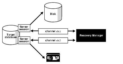

An RMAN channel represents one stream of data to a device type, and corresponds to one server session. Most backup and recovery commands in RMAN are executed by server sessions. As illustrated in Figure 2-1, each channel establishes a connection from the RMAN client to a target or auxiliary database instance by starting a server session on the instance. The server session performs the backup, restore, and recovery.
Figure 2-1 Channel Allocation
Description of Figure 2-1 follows
Description of "Figure 2-1 Channel Allocation"
You can use the CONFIGURE CHANNEL command to configure channels for use with disk or tape in all RMAN sessions using automatic channel allocation, or allocate channels manually within a RUN block. RMAN comes preconfigured with one DISK channel that you can use for backups to disk.
When you run a command that requires a channel without allocating a channel explicitly, then RMAN automatically allocates the channels with the options specified in the CONFIGURE command. For the BACKUP command, RMAN allocates only a single type of channel, such as DISK. For the RESTORE command and maintenance commands (for example, DELETE), RMAN allocates all necessary channels for the device types required to execute the command.
To specify the device type to use for an operation explicitly, use the ALLOCATE CHANNEL command, which must be used within a RUN block, or ALLOCATE CHANNEL FOR MAINTENANCE, which must be executed at the RMAN prompt.
In a Real Application Clusters configuration, there are special considerations regarding channel allocation and backups. See Oracle Database Oracle Clusterware and Oracle Real Application Clusters Administration and Deployment Guide for more details.
How and when the ALLOCATE CHANNEL or CONFIGURE CHANNEL commands cause the media manager to allocate resources is vendor-specific. Some media managers allocate resources when you issue the command; others do not allocate resources until you open a file for reading or writing.
See Also:
Oracle Database Backup and Recovery Reference for ALLOCATE CHANNEL syntax and Oracle Database Backup and Recovery Reference on ALLOCATE CHANNEL FOR MAINTENANCE

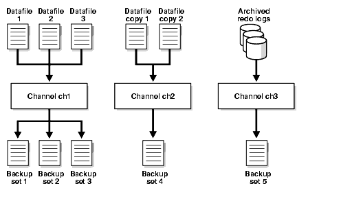

RMAN can perform the I/O required for many commands in parallel, to make optimal use of your hardware resources. To perform I/O in parallel, however, the I/O must be associated with a single RMAN command, not a series of commands. For example, it can be more efficient to back up three datafiles using a command such as:
BACKUP DATAFILE 5,6,7;
rather than issuing the commands
BACKUP DATAFILE 5;
BACKUP DATAFILE 6;
BACKUP DATAFILE 7;
When all three datafiles are backed up in one command, RMAN recognizes the opportunity for parallelism and can use multiple channels to do the I/O in parallel. When three separate commands are used, RMAN can only perform the backups one at a time, regardless of available channels and I/O devices.
The number of channels available (whether allocated in a RUN block or configured in advance) for use with a device at the moment that you run a command determines whether RMAN will read from or write to that device in parallel while carrying out the command. Failing to allocate the right number of channels adversely affects RMAN performance during I/O operations.
As a rule, the number of channels used in carrying out an individual RMAN command should match the number of physical devices accessed in carrying out that command. If manually allocating channels for a command, allocate one for each device; if configuring automatic channels, configure the PARALLELISM setting appropriately.
When backing up to tape, you should allocate one channel for each tape drive. When backing up to disk, allocate one channel for each physical disk, unless you can optimize the backup for your disk topography by using multiple disk channels. Each manually allocated channel uses a separate connection to the target or auxiliary database.
The following script creates three backups sequentially: three separate BACKUP commands are used to back up one file each. Only one channel is active at any one time because only one file is being backed up in each command.
RUN
  ALLOCATE CHANNEL c1 DEVICE TYPE sbt;
  ALLOCATE CHANNEL c2 DEVICE TYPE sbt;
  ALLOCATE CHANNEL c3 DEVICE TYPE sbt;
  BACKUP DATAFILE 5;
  BACKUP DATAFILE 6;
  BACKUP DATAFILE 7;
The following statement uses parallelization on the same example: one RMAN BACKUP command backs up three datafiles, with all three channels in use. The three channels are concurrently active—each server session copies one of the datafiles to a separate tape drive.
RUN

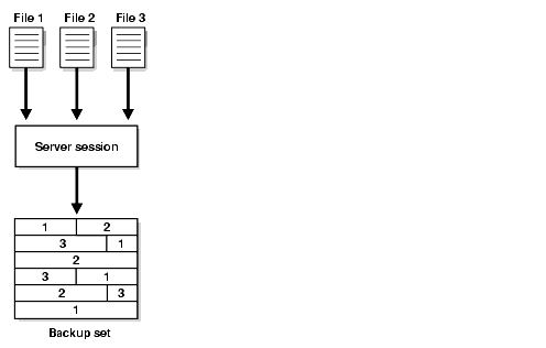

Multiplexed Backup Sets
When creating backup sets, you can multiplex files. In this case, RMAN simultaneously reads multiple files from disk and then writes their blocks into the same backup set. (Image copies, by contrast, are never multiplexed.) For example, RMAN can read from two datafiles simultaneously, and then combine the blocks from these datafiles into a single backup piece.
As Figure 2-2 illustrates, RMAN can back up three datafiles into a backup set that contains only one backup piece. This backup piece contains the intermingled data blocks of the three input files.
Figure 2-2 Datafile Multiplexing
Description of Figure 2-2 follows
Description of "Figure 2-2 Datafile Multiplexing"
Algorithm for Multiplexed Backups
RMAN multiplexing is determined by the following algorithm:
  1. The number of files in each backup set is determined by computing the lesser of the following values:
    • The default number of files in a backup set (16 for archived logs, and 4 for datafiles)
  2. The number of files read by each channel.
    The level of multiplexing is determined by the lesser of the following values:
    • The number of files in the backup set (as calculated by the preceding step)
  3. The default number of files that RMAN reads simultaneously on a single channel (8 files for each channel)
Assume that you are backing up twelve datafiles with one RMAN channel. The number of files in each backup set is 4. To determine the level of multiplexing, compare this value to 8 and take the lesser, which is 4. Because the level of multiplexing is 4, the channel includes blocks from four separate datafiles into each backup set.
See Also:

Manual Parallelization of Backups
When you configure PARALLELISM to greater than 1 or manually allocate multiple channels, RMAN writes multiple backups sets or image copies in parallel. The channels divide the work of backing up the specified files.
You cannot stripe a single backup set across multiple channels.
By default, RMAN determines which channels should back up which database files. You can use the CHANNEL option of the BACKUP command to manually assign a channel to back up specified files. This example shows a parallel backup to the default disk location that uses the default automatic DISK channels:
BACKUP
  (DATAFILE 1,2,3
   CHANNEL ORA_DISK_1)
  (DATAFILECOPY '/tmp/system01.dbf', '/tmp/tools01.dbf'
   CHANNEL ORA_DISK_2)
  (ARCHIVELOG FROM SEQUENCE 100 UNTIL SEQUENCE 102 THREAD 1
   CHANNEL ORA_DISK_3);
You can also manually allocate channels as in the following example:
RUN
  ALLOCATE CHANNEL c1 DEVICE TYPE sbt PARMS="ENV=(BACKUP_SERVER=tape_server1)";
  ALLOCATE CHANNEL c2 DEVICE TYPE sbt PARMS="ENV=(BACKUP_SERVER=tape_server2)";
  ALLOCATE CHANNEL c3 DEVICE TYPE sbt PARMS="ENV=(BACKUP_SERVER=tape_server3)";
  BACKUP
   (DATAFILE 1,2,3
    CHANNEL c1)
     CHANNEL c2)
     CHANNEL c3);
Figure 2-3 shows an example of parallelization in which channel ch1 backs up datafiles, channel ch2 backs up datafile copies, and channel ch3 backs up logs.
Figure 2-3 Parallelization of Backups
Description of Figure 2-3 follows
Description of "Figure 2-3 Parallelization of Backups"
See Also:

In determining the characteristics of the RMAN backup sets, the internal algorithm is influenced by the following factors:
  • The number of input files specified in each backupSpec clause
  • The number of channels that you allocate
  • The default number of files in each backup set (4 for datafiles and 16 for archived logs)
  • The default number of files read simultaneously by a single channel (8)
  • The MAXSETSIZE parameter (specified on the CONFIGURE and BACKUP commands), which specifies a maximum backup set size
The most important rules in the algorithm for backup set creation are:
  • Each allocated channel that performs work in the backup job—that is, each channel that is not idle—generates at least one backup set.
    RMAN writes backup pieces sequentially; striping a backup piece across multiple output devices is not supported. For example, RMAN does not simultaneously write half of a backup piece to one device and the other half to another device, nor can it write the first piece of a backup set to one device and the second piece to another device.
  • RMAN always tries to divide the backup load so that all allocated channels have roughly the same amount of work to do.
  • The default number of datafiles in each backup set is determined by an internal RMAN limit (16 for archived logs, 4 for datafiles).
  • The number of datafiles multiplexed in a backup set is limited by the lesser of the number of files in each backup set and the default number of files read by a single channel simultaneously (8).
  • The maximum size of a backup set is determined by the MAXSETSIZE parameter of the CONFIGURE or BACKUP command.

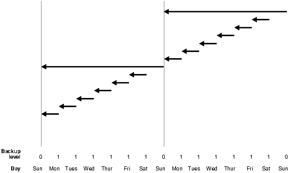

RMAN can create multilevel incremental backups. Each incremental level is denoted by a value of 0 or 1. A level 0 incremental backup, which is the base for subsequent incremental backups, copies all blocks containing data. The only difference between a level 0 incremental backup and a full backup is that a full backup is never included in an incremental strategy.
A level 1 incremental backup can be either of the following types:
  • A differential backup, which backs up all blocks changed after the most recent incremental backup at level 1 or 0
  • A cumulative backup, which backs up all blocks changed after the most recent incremental backup at level 0
Incremental backups are differential by default.
Cumulative backups are preferable to differential backups when recovery time is more important than disk space, because fewer incremental backups need to be applied during recovery.
The size of the backup file depends solely upon the number of blocks modified and the incremental backup level.

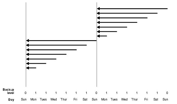

Cumulative Incremental Backups
In a cumulative level 1 backup, RMAN backs up all the blocks used since the most recent level 0 incremental backup. Cumulative incremental backups reduce the work needed for a restore by ensuring that you only need one incremental backup from any particular level. Cumulative backups require more space and time than differential backups, however, because they duplicate the work done by previous backups at the same level.
Figure 2-5 Cumulative Incremental Backups
Description of Figure 2-5 follows
Description of "Figure 2-5 Cumulative Incremental Backups"
In the example shown in Figure 2-5, the following occurs each week:
  • Sunday
    An incremental level 0 backup backs up all blocks that have ever been in use in this database.
  • Monday - Saturday
    A cumulative incremental level 1 backup copies all blocks changed since the most recent level 0 backup. Because the most recent level 0 backup was created on Sunday, the level 1 backup on each day Monday through Saturday backs up all blocks changed since the Sunday backup.

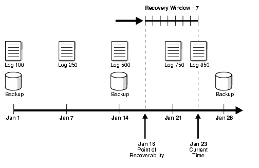

Recovery Window
A recovery window is a period of time that begins with the current time and extends backward in time to the point of recoverability. The point of recoverability is the earliest time for a hypothetical point-in-time recovery, that is, the earliest point to which you can recover following a media failure. For example, if you implement a recovery window of one week, then this window of time must extend back exactly seven days from the present so that you can restore a backup and recover it to this point. You implement this retention policy as follows:
CONFIGURE RETENTION POLICY TO RECOVERY WINDOW OF 7 DAYS;
This command ensures that for each datafile one backup that is older than the point of recoverability must be retained. For example, if the recovery window is 7, then there must always exist one backup of each datafile that satisfies the following condition:
SYSDATE - BACKUP CHECKPOINT TIME >=  7
All backups older than the most recent backup that satisfied this condition are obsolete.
Assume the following retention policy illustrated in Figure 2-6. The retention policy has the following aspects:
  • The recovery window is 7 days.
  • Database backups are scheduled every two weeks on these days:
    • January 1
    • January 15
    • January 29
    • February 12
  • The database runs in ARCHIVELOG mode, and archived logs are saved on disk only as long as needed for the retention policy.
Figure 2-6 Recovery Window, Part 1
Description of Figure 2-6 follows
Description of "Figure 2-6 Recovery Window, Part 1"
As illustrated in Figure 2-6, the current time is January 23 and the point of recoverability is January 16. Hence, the January 14 backup is needed for recovery, and so are the archived logs from log sequence 500 through 850. The logs before 500 and the January 1 backup are obsolete because they are not needed for recovery to a point within the window.

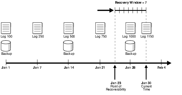

Assume the same scenario a week later, as depicted in Figure 2-7.
Figure 2-7 Recovery Window, Part 2
Description of Figure 2-7 follows
Description of "Figure 2-7 Recovery Window, Part 2"
In this scenario, the current time is January 30 and the point of recoverability is January 23. Note how the January 14 backup is not obsolete even though a more recent backup (January 28) exists in the recovery window. This situation occurs because restoring the January 28 backup does not enable you to recover to the earliest time in the window, January 23. To ensure recoverability to any point within the window, you must save the January 14 backup as well as all archived redo logs from log sequence 500 to 1150.

If backup optimization is enabled, and if a recovery window retention policy is in effect, then when performing SBT backups RMAN always backs up datafiles whose most recent backup is older than the recovery window. For example, assume that:
  • Today is February 21.
  • The most recent backup of tablespace tools to tape is January 3.
  • Tablespace tools is read-only.
On February 21, when you issue a command to back up tablespace tools to tape, RMAN backs it up even though it did not change after the January 3 backup (because it is read-only). RMAN makes the backup because no backup of the tablespace exists within the 7-day recovery window.
This behavior allows the media manager to expire old tapes. Otherwise, the media manager would be forced to keep the January 3 backup of tablespace tools indefinitely. By making a more recent backup of tablespace tools on February 21, RMAN allows the media manager to expire the tape containing the obsolete January 3 backup.
