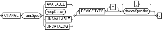

| Syntax Element | Description |

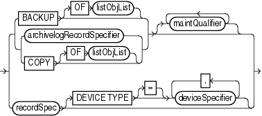

| maintSpec | Specifies which files you want to CHANGE. Refer to "maintSpec" for descriptions of the options in this caluse. |
AVAILABLE |
Changes the status of a backup or copy to AVAILABLE in the repository. View the status in the LIST output or recovery catalog views. |
| keepOption | Changes the exemption status of a backup or copy in relation to the configured retention policy. For example, specify CHANGE ... NOKEEP to make a backup that is currently exempt from the retention policy eligible for OBSOLETE status.
You can also specify Note: You cannot use keepOption with flash recovery area files. See Also: "keepOption" |
UNAVAILABLE |
Changes the status of a backup or copy to UNAVAILABLE in the repository. View the status in the LIST output or recovery catalog views. This option is provided for cases when the file cannot be found or has migrated offsite. RMAN does not use a file that is marked UNAVAILABLE in a RESTORE or RECOVER command. If the file is later found or returns to the main site, then use the AVAILABLE option to update its status. |
UNCATALOG |
Removes references to a datafile copy, backup piece, or archived redo log from the recovery catalog, and updates records in the target control file to status DELETED. The CHANGE ... UNCATALOG command does not touch physical backups and copies. Use this command to notify RMAN when a file is deleted by some means other than a DELETE command.
Caution: If you resynchronize from a backup control file, or upgrade the recovery catalog, then records previously removed from the RMAN repository with |
DEVICE TYPE deviceSpecifier |
Executes the CHANGE for the specified device type only (see "deviceSpecifier"). This option is valid only if you have configured automatic channels and have not manually allocated channels. For example, if you run CHANGE UNCATALOG...DEVICE TYPE DISK, then RMAN only uncatalogs files on disk. |
