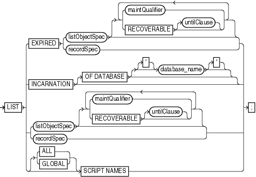

list::=
To display information about backup sets, proxy copies, and image copies recorded in the repository. The LIST command displays the files against which you can run CROSSCHECK and DELETE commands. Use this command to list:
Backups and copies that do not have the status AVAILABLE in the RMAN repository
Backups and copies of datafiles that are available and can possibly be used in a restore operation
Specified archived logs, backup sets, backup pieces, control file copies, datafile copies, and proxy copies
Backups and copies restricted by tag, completion time, recoverability, or device
Incarnations of a specified database or of all databases known to the repository
Stored scripts in the recovery catalog
RMAN records the output to either standard output or the message log, but not to both at the same time. You can control how the output is organized (BY BACKUP or BY FILE) as well as the level of detail in the output (VERBOSE or SUMMARY).
See Also:
Oracle Database Backup and Recovery Basics to learn how to make lists and reports, and "cmdLine"Execute LIST only at the RMAN prompt.
RMAN must be connected to the target database. If RMAN is connected in NOCATALOG mode, then the database must be mounted. If RMAN is connected to a recovery catalog, then the target instance must be started but the target database does not need to be mounted.
| Syntax Element | Description |
EXPIRED |
Displays backup sets, proxy copies, and image copies marked in the repository as EXPIRED, that is, "not found."
To ensure that |
RECOVERABLE |
Specifies datafile backups or copies whose status in the repository is AVAILABLE and which can be used for restore and recovery in the target database's current incarnation. This list includes all backups and copies except the incremental backups that have no valid parent to which the incremental can be applied. |
| untilClause | Specifies an end time, SCN, or log sequence number. See "untilClause". |
| recordSpec | Specifies the object or objects that you are listing. Refer to "recordSpec". |
INCARNATION |
Displays information about the incarnations of a database. Whenever you open a database with the RESETLOGS option, then you create a new incarnation of the database. So, if LIST INCARNATION displays n incarnations of a database, then you have reset the online logs for this database n-1 times.
The See Also: Table 2-19 for an explanation of the column headings of the |
OF DATABASE 'database_name' |
Specifies the name of the database. If you do not specify the OF DATABASE option, then the command lists all databases registered in the recovery catalog. |
| maintQualifier | Restricts the range of the listing. Refer to "maintQualifier". |
SCRIPT NAMES |
Lists names of RMAN stored scripts in the currently connected recovery catalog, along with any descriptive comments.
Without You must connect to a target database and a recovery catalog to list names for scripts defined for that target database. |
ALL |
RMAN lists all global and local scripts defined for all databases in the connected recovery catalog.
You must be connected to a recovery catalog to use |
GLOBAL |
RMAN lists only global scripts defined in the connected recovery catalog.

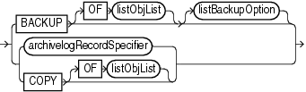

listObjectSpec |
Specifies the type of object or objects that you are listing.
See Also: "recordSpec" |
BACKUP |
Displays information about BACKUP output: backup sets (including detail on backup pieces), proxy copies, and image copies. |
BACKUPSET |
Displays only information about backup sets, backup pieces, and proxy copies. The output displays a unique key for each. The LIST BACKUPSET command defaults to BY BACKUP.
By default, RMAN lists both usable and unusable backups, even those that cannot be restored, are expired or unavailable, or are incrementals that cannot be restored because their parent full backup or copy no longer exists. To see only backups that can be used for recovery, use the See Also: "LIST Output" for an explanation of the column headings of the |
COPY |
Displays only information about datafile copies, archived redo logs, and image copies of archived redo logs. By default, LIST COPY displays copies of all database files and archived redo logs. Both usable and unusable image copies are included in the output, even those that cannot be restored or are expired or unavailable.
See Also: Table 2-16 and Table 2-18 for an explanation of the column headings of the LIST |
OF listObjList |
Restricts the list of objects operated on to the object type specified in the listObjList clause. If you do not specify an object, then LIST defaults to OF DATABASE CONTROLFILE ARCHIVELOG ALL.
Note: The See Also: "listObjList" |
| archivelogRecordSpecifier | Displays information about a range of archived redo logs. |
listBackupOption |
Specifies whether to list summary information about backups or detailed information.
BY BACKUP |
Lists backup sets, then the contents of each backup set (pieces and files), and then proxy copies. This is the default option for LIST BACKUP.
If you specify the |
VERBOSE |
Gives detailed description of contents of each backup set (default). |
SUMMARY |
Gives a one-line summary for each datafile (when using BY FILE) or backup (when using BY BACKUP). |
BY FILE |
Lists a datafile, then its backup sets, and then proxy copies. |
