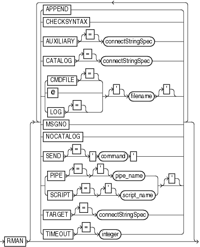

cmdLine::=
To start RMAN from the operating system command line. Use these arguments to:
Connect to the target, recovery catalog, or auxiliary database.
On some platforms, you may not want to connect at the operating system command line because the credentials can be visible to other users on the system. For example, on many Unix systems the output of theps
command can show the complete command line used to start RMAN, including any credentials provided on the command line. The CONNECT command is an alternative method that avoids this problem.Specify whether you are using RMAN without a recovery catalog.
Run a command file (text file containing commands) or stored script (from the recovery catalog) on startup, and exit on completion, instead of starting an interactive session.
Start an interactive session which only checks commands entered for correct syntax, or perform a syntax check on the contents of a command file.
Specify the file in which RMAN records the results of processed commands.
Append output to the existing RMAN log file.
Send a command to the media manager.
Cause RMAN to print message numbers in the RMAN output.
If you start RMAN without specifying either CATALOG
or NOCATALOG
on the command line, then RMAN makes no connection to a repository. If you run a command that requires the repository, and if no CONNECT
CATALOG
command has been issued yet, then RMAN automatically connects in the default NOCATALOG
mode. After that point, the CONNECT
CATALOG
command is not valid in the session.
See Also:
Oracle Database Backup and Recovery Basics to learn how to connect RMAN to database instancesUse these arguments at the operating system command line rather than at the RMAN prompt.
Syntax Element | Description |
APPEND |
Causes new output to be appended to the end of the message log file. If you do not specify this parameter, and if a file with the same name as the message log file already exists, then RMAN overwrites it. |
AUXILIARY = connectStringSpec |
Specifies a connect string to an auxiliary database, for example, AUXILIARY SYS/change_on_install@dupdb .
See Also: "connectStringSpec" |
CATALOG = connectStringSpec |
Specifies a connect string to the database containing the recovery catalog, for example, CATALOG rman/rman@inst2 .
CHECKSYNTAX |
Causes RMAN to start in a mode where commands entered are checked for syntax errors, but no other processing is performed. If used with a CMDFILE or @ argument, the RMAN client starts, checks all commands in the file, then exits. If used without specifying a command file, then RMAN prompts the user for input and parses each command until the user exits the RMAN client.
RMAN reports an |
CMDFILE = 'filename' |
Parses and compiles all RMAN commands in a file and then sequentially executes each command in the file. RMAN exits if it encounters a syntax error during the parse phase or if it encounters a runtime error during the execution phase. If no errors are found, then RMAN exits after the job completes.
If the first character of the filename is alphabetic, then you can omit the quotes around the filename. The contents of the command file should be identical to commands entered at the RMAN prompt. Note: If you run a command file at the RMAN prompt rather than as an option on the operating system command line, then RMAN does not run the file as a single job. RMAN reads each line sequentially and executes it, only exiting when it reaches the last line of the script. |
@ filename |
Equivalent to CMDFILE . |
LOG = 'filename' |
Specifies the file where RMAN records its output, that is, the commands that were processed and their results. If you do not specify this argument, then RMAN writes its message log file to standard output. The RMAN output is also stored in the V$RMAN_OUTPUT view (a memory-only view for jobs in progress) and in V$RMAN_STATUS (a control file view for completed jobs and jobs in progress).
The |
MSGNO |
Causes RMAN to print message numbers, that is, RMAN- xxxx , for the output of all commands. By default, RMAN does not print the RMAN- xxxx prefix. |
NOCATALOG |
Indicates that you are using RMAN without a recovery catalog.
Note: If you do not specify either |
SEND = ' command ' |
Sends a vendor-specific command string to all allocated channels.
See Also: Your media management documentation to determine whether this feature is supported, and "SEND" |
PIPE = 'pipe_name' |
Invokes the RMAN pipe interface. RMAN uses two public pipes: one for receiving commands and the other for sending output. The names of the pipes are derived from the value of the PIPE parameter. For example, you can invoke the RMAN pipe interface with the following options: PIPE rpi TARGET SYS/pwd@tdb .
RMAN opens the following pipes in the target database:
All messages on both the input and output pipes are of type See Also: Oracle Database Backup and Recovery Advanced User's Guide to learn how to pass commands to RMAN through a pipe |
SCRIPT = 'script_name' |
Once connected to the target database and recovery catalog (which must be specified using the TARGET and CATALOG options), RMAN will run the named stored script from the recovery catalog against the target database. If there are both a global script.and a local stored script on the target database with the name script_name , RMAN will run the local script.
The single-quotes around the stored script name are required when the script name either begins with a number or is an RMAN reserved word. You should avoid creating script names that begin with a number or that match RMAN reserved words. See "CREATE SCRIPT" for more details about stored scripts. |
TARGET = connectStringSpec |
Specifies a connect string to the target database, for example, TARGET SYS/mypassword@inst1 .
TIMEOUT = integer |
Causes RMAN to exit automatically if it does not receive input from an input pipe within integer seconds. The PIPE parameter must be specified when using TIMEOUT .
