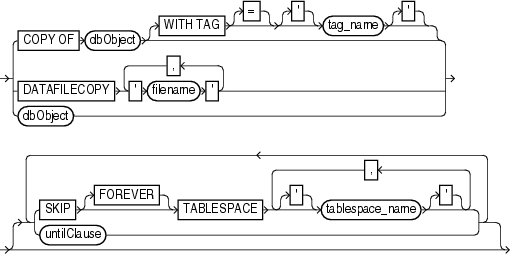

| Syntax Element | Description |
COPY OF |
Applies incremental backups to the specified image copy to roll it forward to any time equal to or before the most recent incremental backup of the file. The existing image copy is overwritten, and remains in a fuzzy state during the recovery. RECOVER COPY is a method for updating a copy and is not a media recovery of a current database file. This command is meant to be used in conjunction with the BACKUP... FOR RECOVER OF COPY syntax, to implement a strategy using incrementally updated backups.
The following requirements must be met:
RMAN selects one suitable copy if there are multiple possible copies to which the incrementals can be applied to carry out the operation. Note: RMAN issues a warning (not an error) if it cannot recover to the specified time (or current time if none is specified) because no incrementals are available. |
WITH TAG 'tag_name' |
Specifies a tag name to identify the image copy to be rolled forward. |
DATAFILECOPY |
Applies incremental backups to the specified datafile image copy. Refer to description of RECOVER COPY OF.. |
SKIP [FOREVER] TABLESPACE |
Specifies tablespaces that should not be recovered, which is useful for avoiding recovery of tablespaces containing only temporary data or for postponing recovery of some tablespaces. The SKIP clause takes the datafiles in the specified tablespaces offline before starting media recovery. These files are left offline after the media recovery is complete.
If you perform incomplete recovery, then |
| untilClause | Specifies a past time, SCN, or log sequence number for termination of the RECOVER command. When used with one or more tablespaces, indicates a TSPITR operation for the named tablespaces. It cannot be used with RECOVER DATAFILE. It should not be used for RECOVER DATABASE (see "Restrictions and Usage Notes" for details). After DBPITR, you must open the database with the RESETLOGS option.
See Also: "untilClause" |
DATABASE |
Specifies that the entire database is to be recovered. By default, RMAN performs complete recovery. For incomplete recovery, specify an untilClause. |
DATAFILE datafileSpec |
Specifies a list of one or more datafiles to recover. Specify datafiles by either filename (by using a quoted string) or absolute datafile number (by using an integer).
If you are using the control file as the exclusive repository for RMAN metadata, then the filename must be the name of the datafile as recorded in the control file. If you are using a recovery catalog, then the filename of the datafile must be the most recent name recorded in the catalog, even if the name in the control file has been updated more recently. For example, assume that a datafile was renamed in the control file. The instance then fails before you can resynchronize the catalog. Specify the old name of the datafile in the RECOVER command, because this is the name recorded in the catalog. See Also: "datafileSpec" |
TABLESPACE 'tablespace_name' |
Specifies tablespaces by tablespace name. |

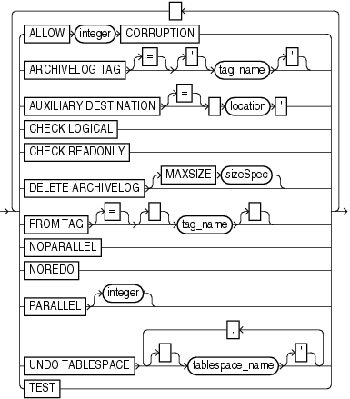

recoverOptionList |
Specifies various recovery options. |
ARCHIVELOG TAG = tag_name |
Specifies the tag for an archived log backup to be used during recovery. If the tagged backup does not contain all the necessary logs for recovery, RMAN uses logs or incremental backups as needed from whatever is available. Note that tag names are not case sensitive and display in all uppercase. |
AUXILIARY DESTINATION [ = ] 'location' |
Can only be used when performing TSPITR. Used to automate the management of auxiliary set files during TSPITR. Specifies a location where auxiliary set datafiles, control files and online logs are created during TSPITR if another location for an individual file is not explicitly specified.
If you do not specify See also: The chapter on TSPITR in Oracle Database Backup and Recovery Advanced User's Guide for more details about the auxiliary destination. |
CHECK LOGICAL |
Tests data and index blocks that pass physical corruption checks for logical corruption, for example, corruption of a row piece or index entry. If RMAN finds logical corruption, it logs the block in the alert.log and server session trace file.
The If the total number of physical and logical corruptions detected for a file is less than its |
CHECK READONLY |
Checks the headers of read-only files to ensure that they are current before omitting them from the recovery. |
DELETE ARCHIVELOG [MAXSIZE integer [K|M|G]] |
Deletes archived logs restored from backups or copies that are no longer needed. RMAN does not delete archived logs that were already on disk before the RESTORE command started.
If you do not specify Note: If archived redo logs are restored to the flash recovery area then the |
FROM TAG = tag_name |
Specifies the tag for an incremental backup to be used during recovery. If the tagged backup does not contain all the necessary incrementals for recovery, then RMAN uses logs or incremental backups as needed from whatever is available. Note that tag names are not case sensitive and display in all uppercase.
See Also: "BACKUP" to learn how a tag can be applied to an individual copy of a duplexed backup set, and to learn about the default filename format for backup tags |
NOREDO |
Suppresses the application of redo logs during recovery. Only incremental backups are applied.
One use of this option is in updating full backups of Note: Incremental backups of Another use is in updating standby or duplicate databases. Incremental backups created with the |
TEST |
Use the TEST clause to conduct a trial recovery. A trial recovery is useful if a normal recovery procedure has encountered some problem. It lets you look ahead into the redo stream to detect possible additional problems. The trial recovery applies redo in a way similar to normal recovery, but it does not write changes to disk, and it rolls back its changes at the end of the trial recovery.
Note: You can use this clause only if you have restored a backup taken since the last RESETLOGS operation. Otherwise, the database returns an error. |
UNDO TABLESPACE |
Only for use with RECOVER TABLESPACE.
During TSPITR, RMAN needs information about which tablespaces had undo segments at the TSPITR target time. This information is usually available in the recovery catalog, if one is used. If there is no recovery catalog, or if the information is not found in the recovery catalog, RMAN proceeds assuming that the set of tablespaces with undo segments at the target time is the same as the set of tablespaces with undo segments at the present time. If this assumption is not correct, TSPITR fails with an error. In such a case, use this clause to provide a list of tablespaces with undo segments at the target time. |
ALLOW integer CORRUPTION |
The ALLOW integer CORRUPTION clause lets you specify, in the event of logfile corruption, the number of corrupt blocks that can be tolerated while allowing recovery to proceed.
When you use this clause during trial recovery (that is, in conjunction with the |
NOPARALLEL |
Specifies not to perform recovery in parallel. Parallel execution is the default for RECOVER. |
PARALLEL [integer] |
Specifies to perform recovery in parallel (the default).
By default, the database determines the optimal degree of parallelism, which is the number of parallel threads used in the recovery operation. It is generally not necessary for you to specify the degree of parallelism. However, you can specify the degree of parallelism directly by including the For more complete information on |
