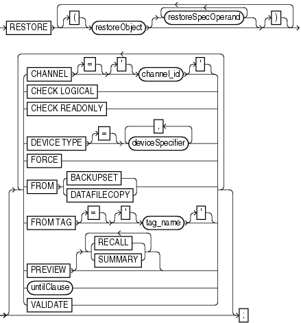

restore::=
Description of restore.gif follows

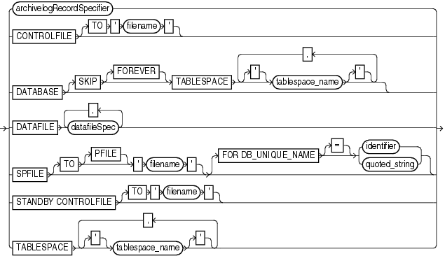

restoreObject::=
Description of restoreobject.gif follows

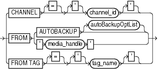

restoreSpecOperand::=
Description of restorespecoperand.gif follows

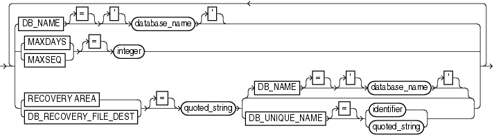

autoBackupOptList::=
Description of autobackupoptlist.gif follows

restore
Syntax Element Description
CHANNEL 'channel_id' Refer to the restoreSpecOperand clause.
CHECK LOGICAL Tests data and index blocks that pass physical corruption checks for logical corruption, for example, corruption of a row piece or index entry. If RMAN finds logical corruption, it logs the block in the alert.log and server session trace file.
If the total number of physical and logical corruptions detected in a file is less than its MAXCORRUPT setting, the RMAN command completes and the database populates the V$DATABASE_BLOCK_CORRUPTION view with corrupt block ranges. If MAXCORRUPT is exceeded, the command terminates without populating the views.
If the initialization parameter DB_BLOCK_CHECKSUM=TRUE, and if MAXCORRUPT and NOCHECKSUM are not set, then specifying CHECK LOGICAL detects all types of corruption that are possible to detect.
Note: The MAXCORRUPT setting represents the total number of physical and logical corruptions permitted on a file.
CHECK READONLY Checks the read-only datafiles to make sure they exist, are readable, and have the appropriate checkpoint. If any of these conditions is not met, then RMAN restores the files—whether or not they are read-only. By default, RMAN does not restore read-only files when you issue the RESTORE DATABASE command.
DEVICE TYPE deviceSpecifier Allocates automatic channels for the specified device type only. For example, if you configure automatic disk and tape channels, and issue RESTORE...DEVICE TYPE DISK, then RMAN allocates only disk channels.
See Also: "deviceSpecifier"
FORCE Overrides the restartable restore feature and restores all files regardless of whether they need to be restored. If you do not specify FORCE, then RMAN restores a file only if its header information does not match the information in the control file.
FROM [ BACKUPSET | DATAFILECOPY ] Specifies whether RMAN should restore from a DATAFILECOPY on disk or a BACKUPSET. By default RESTORE chooses the most recent backup set or file copy, that is, the file copy or backup set that needs the least media recovery.
FROM TAG = 'tag_name' Refer to the restoreSpecOperand clause.
PREVIEW
[ SUMMARY | RECALL ]
When PREVIEW or PREVIEW SUMMARY is appended to any RESTORE command, instead of performing the restore RMAN will report the backups (on disk or sequential media) it will use during the restore. The output will be in the same format as is generated by the LIST BACKUPS and LIST BACKUPS... SUMMARY commands.
Some media managers provide status information to RMAN about which backups are vaulted, that is, stored in a remote location such as a secure storage facility, and which therefore cannot be used without retrieving media. The output of RESTORE identifies such backups, if the media manager provides the necessary information.
When used with the RECALL option, RESTORE... PREVIEW initiates a request for the retrieval of backup media needed for the specified restore operation from remote storage.
See Also: "LIST", and specifically the BACKUPS and SUMMARY options.
untilClause Limits the selection to backup sets or file copies that are suitable for a point-in-time recovery to the specified time. In the absence of any other criteria, RMAN selects the most current file copy or backup set to restore. Note that the time specified in the untilClause must fall within the current incarnation.
See Also: "untilClause"
VALIDATE Lets RMAN decide which backup sets, datafile copies, and archived logs need to be restored, and then scans them to verify their contents. No files are restored. Use VALIDATE to verify that the backups required to restore the specified files are intact and usable.
restoreObject
restoreObject Specifies the objects to be restored. The RESTORE command restores full backups, incremental backups (level 0 only), or copies of datafiles, control files, and archived redo logs.
archivelogRecordSpecifier Restores the specified range of archived redo logs. The default restore location is DB_RECOVERY_FILE_DEST (if one of LOG_ARCHIVE_DEST_n is configured to USE_DB_RECOVERY_FILE_DEST either implicitly or explicitly). Otherwise, the default restore filenames are constructed with the LOG_ARCHIVE_FORMAT and LOG_ARCHIVE_DEST_1 parameters of the target database. These parameters combine in a port-specific fashion to derive the name of the restored log. You can override the default location with the SET ARCHIVELOG DESTINATION command.
Because the RECOVER command automatically restores archived logs as needed, you should seldom need to restore logs manually. Possible reasons for manually restoring archived logs are to speed up recovery or to stage the logs to multiple destinations.
See Also: "archivelogRecordSpecifier"
Note: The database can be started, mounted, or open for this operation.
CONTROLFILE Restores the current control file for a primary database.
See Also: Table 2-27 for restrictions and usage notes.
Note: You must always run the RECOVER command after restoring a control file, and must also always open the database with the RESETLOGS option.
DATABASE [ SKIP [ FOREVER ] TABLESPACE tablespace_name ] Restores all datafiles in the database except those that are offline or read-only. Unlike BACKUP DATABASE, RESTORE DATABASE does not automatically include the control file and the server parameter file—you must issue additional RESTORE CONTROLFILE and RESTORE SPFILE commands to restore these files.
If you specify the CHECK READONLY option, then RMAN examines the headers of all read-only datafiles and restores any that need restoring.
Use an optional SKIPTABLESPACE 'tablespace_name' argument to avoid restoring specified tablespaces, which is useful when you want to avoid restoring tablespaces containing temporary data.
If you specify SKIP FOREVER TABLESPACE, then RMAN specifies the DROP option of ALTER DATABASE DATAFILE ... OFFLINE when taking the datafiles that belong to the tablespace offline before the restore. The DROP option indicates that RMAN does not intend to recover these files and intends to drop their tablespaces from the database after the database is opened again. In other words, FOREVER indicates that RMAN never intends to do anything with the skipped tablespaces again.
DATAFILE datafileSpec Restores the datafiles specified by filename or absolute datafile number.
See Also: "datafileSpec"
SPFILE [TO [PFILE] 'filename'] Restores a primary or standby server parameter file to the location from which it was backed up (default), or to a different location specified by the TO clause. RMAN cannot overwrite a server parameter file currently in use by the target database.
Specify UNTIL or TAG options of RESTORE to restore older versions of the server parameter file. By default RMAN restores the most current server parameter file.
If the server parameter file is lost, connect to the target (and catalog if used) and then run SET DBID. Run STARTUP FORCE NOMOUNT before running RESTORE SPFILE (with FROM AUTOBACKUP if in NOCATALOG mode). Then run STARTUP FORCE to restart the database with the restored server parameter file.
See Also: "Restrictions and Usage Notes for the SET DBID Command"
[FOR DB_UNIQUE_NAME 'DB_UNIQUE_NAME'] The FOR DB_UNIQUE_NAME clause for RESTORE SPFILE is only useful in a Data Guard environment.
In a Data Guard environment, the primary and standby nodes may have different channel configurations for communicating with their associated SBT backup and disk devices. If both the primary and standby databases are known to the recovery catalog, then the configuration settings for both databases are recorded in the recovery catalog. Because the two databases have the same DB_NAME, the records in the recovery catalog can only be distinguished using the value of the DB_UNIQUE_NAME initialization parameter for the primary and standby databases.
RMAN cannot determine the DB_UNIQUE_NAME initialization parameter for the target database if the SPFILE of the target database is not available, as is the case when restoring the SPFILE from backup. Therefore, RMAN cannot choose the correct channel configurations to use when restoring the SPFILE from backup at the target node. In such a circumstance, RMAN returns an RMAN-6758 error.
The FOR DB_UNIQUE_NAME clause of the RESTORE command is used to specify the DB_UNIQUE_NAME in this situation. With the DB_UNIQUE_NAME , RMAN is able to locate the correct configuration settings for the node on which the SPFILE is being restored, and can use them to access backup devices.
Note: Using RESTORE SPFILE when the DB_NAME is not unique in the recovery catalog produces an RMAN-6758 error.
See Also: Oracle Data Guard Concepts and Administration for a detailed procedure for restoring the SPFILE in a Data Guard environment.
STANDBY CONTROLFILE [ TO 'filename' ] Restores the current control file for a standby database.
TABLESPACE 'tablespace_name' Restores all datafiles in the specified tablespaces.
The translates the tablespace name internally into a list of datafiles. If you rename a tablespace (for example, from users to customers), then so long as an additional tablespace with the old name (users) has not been created, you can use either the old name (users) or the new name (customers) for the tablespace. RMAN detects that the tablespace has changed its name and updates the recovery catalog on the next resynchronization.
restoreSpecOperand
restoreSpecOperand Specifies options for the restoreObject clause.
Note: These parameters override the parameters with the same name at the RESTORE command level.
CHANNEL 'channel_id' Specifies the case-sensitive name of a channel to use for this restore operation. If you do not specify a channel, then RESTORE uses any available channel allocated with the correct device type.
FROM AUTOBACKUP [autoBackupOptionList] Restores a control file autobackup. You can only specify this option on the RESTORE CONTROLFILE and RESTORE SPFILE commands. When restoring either type of file in NOCATALOG mode, the FROM AUTOBACKUP clause is required.
RMAN begins the search on the current day or on the day specified with the SET UNTIL. On the first day searched, the search begins with sequence number 256 (or the sequence number specified by MAXSEQ, if provided) and counts back to sequence 0. If no autobackup is found in the current or SET UNTIL day, RMAN checks preceding days, starting with sequence 256 and counting back to 0. The search continues up to MAXDAYS days (default of 7, maximum of 366) prior to the current or SET UNTIL day. If no autobackup is found within MAXDAYS days, then RMAN signals an error and the command stops.
FROM 'media_handle' Specifies the name of the control file copy or backup piece containing a control file. The media_handle can be any backup piece that contains a backup of a control file: the control file backup does not need to be an autobackup.
FROM TAG [=] 'tag_name' Overrides the default selection of the most recent backups or file copy available. The tag restricts the automatic selection to backup sets or file copies that were created with the specified tag. If multiple backup sets or file copies have a matching tag, then RMAN selects the most recent one. Note that tag names are not case sensitive.
See Also: "BACKUP" for a description of how a tag can be applied to an individual copy of a duplexed backup set, and for a description of the default filename format for tags
autoBackupOptList
autoBackupOptList Parameters that control the search for a control file autobackup.
DB_NAME = 'database_name' Provides a DB_NAME to be used in searching for control file autobackups.
MAXDAYS = integer Limits the search for a control file autobackup to within the specified number of days in the past.
MAXSEQ = integer Specifies the highest sequence number for the control file autobackup search.
(RECOVERY AREA| DB_RECOVERY_FILE_DEST) = password Specifies path to flash recovery area to search for autobackups. RECOVERY AREA and DB_RECOVERY_FILE_DEST are synonyms.
DB_NAME = database_name Provides the DB_NAME of the database in the specified flash recovery area that is the target of the restore operation.
DB_UNIQUE_NAME = { identifier | quoted-string } Provides the DB_UNIQUE_NAME of the database in the specified flash recovery area that is the target of the restore operation.
