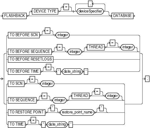

| Syntax Element | Description |
DEVICE TYPE deviceSpecifier |
Allocates automatic channels for the specified device type only. For example, if you configure automatic disk and tape channels, and issue FLASHBACK...DEVICE TYPE DISK, then RMAN allocates only disk channels. RMAN may need to restore redo logs from backup during the flashback database process. Changes between the last flashback log and the target time must be re-created based on the archived redo log. If no automatic channels are allocated for tape and a needed redo log is on tape, the FLASHBACK operation will fail.
See Also: "deviceSpecifier" |
DATABASE |
Returns the database to the specified point. Query OLDEST_FLASHBACK_SCN and OLDEST_FLASHBACK_TIME in V$FLASHBACK_DATABASE_LOG to display the approximate lowest SCN and time to which you can flash back. View the current database SCN in V$DATABASE.CURRENT_SCN. |
TO RESTORE POINT = ' restore_point_name |
Returns the database to the SCN associated with the specified restore point. This can be an ordinary restore point or a guaranteed restore point. |
TO SCN = integer |
Returns the database to the point up to (and including) the specified SCN. By default, the provided SCN resolves to the current or ancestor incarnation. The DBA can override the default by using the RMAN RESET DATABASE INCARNATION command to set the recovery target incarnation. |
TO BEFORE SCN = integer |
Returns the database to its state just before the specified SCN. Any changes at an SCN lower than that specified are applied, but if there is a change associated with the specified SCN it is not applied. By default, the provided SCN resolves to the current or ancestor incarnation. The DBA can override the default by using the RMAN RESET DATABASE INCARNATIONcommand to set the recovery target incarnation. |
TO SEQUENCE = integer THREAD = integer |
Specifies a redo log sequence number and thread as an upper limit. RMAN applies changes up to (and including) the last change in the log with the specified sequence and thread number. |
TO BEFORE SEQUENCE = integer [THREAD = integer] |
Specifies a redo log sequence number and thread as an upper limit. RMAN applies changes up to (but not including) the last change in the log with the specified sequence and thread number. |
TO TIME = 'date_string' |
Returns the database to its state at the specified time. You can use any SQL DATE expressions to convert the time to the current format, for example, FLASHBACK DATABASE UNTIL TIME 'SYSDATE-7'. |
TO BEFORE TIME = 'date_string' |
Similar to the TO TIME clause, but returns the database to its state including all changes up to but not including changes at the specified time. |
TO BEFORE RESETLOGS |
Returns the database to its state including all changes up to the SCN of the lastOPEN RESETLOGS. |
