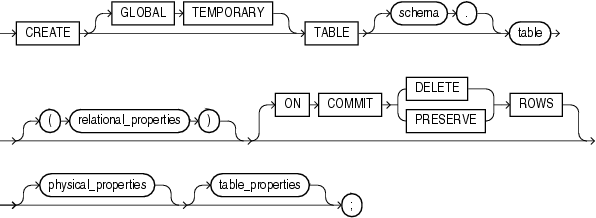

create_table::=
Description of create_table.gif follows
(relational_table::=, object_table ::=, XMLType_table ::=)
relational_table::=
Description of relational_table.gif follows
Each of the clauses following the table name is optional for any given relational table. However, for every table you must at least specify either column names and datatypes using the relational_properties clause or an AS subquery clause using the table_properties clause.
(relational_properties::=, physical_properties::=, table_properties::=)

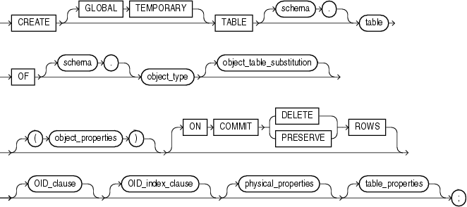

object_table ::=
Description of object_table.gif follows
(object_table_substitution ::=, object_properties::=, oid_clause::=, oid_index_clause::=, physical_properties::=, table_properties::=)

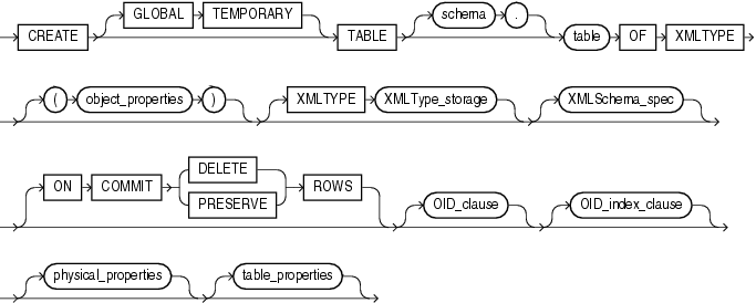

XMLType_table ::=
Description of XMLType_table.gif follows
(XMLType_storage::=, XMLSchema_spec::=, oid_clause::=, oid_index_clause::=, physical_properties::=, table_properties::=)

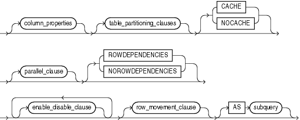

table_properties::=
Description of table_properties.gif follows
(column_properties::=, table_partitioning_clauses ::=, parallel_clause ::=, enable_disable_clause ::=, row_movement_clause ::=, subquery::=)

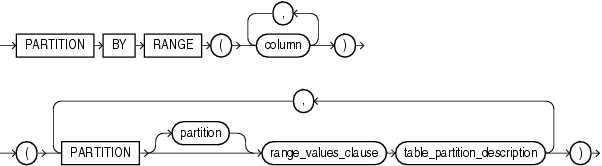

range_partitioning::=
Description of range_partitioning.gif follows
(range_values_clause::=, table_partition_description::=)

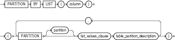

list_partitioning ::=
Description of list_partitioning.gif follows
(list_values_clause::=, table_partition_description::=)

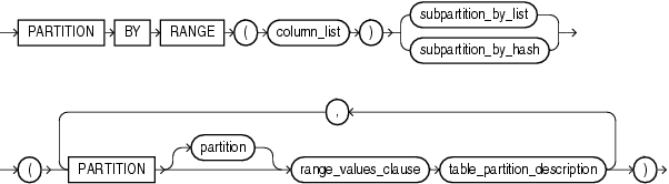

composite_partitioning ::=
Description of composite_partitioning.gif follows
(subpartition_by_list::=, subpartition_by_hash::=, range_values_clause::=, table_partition_description::=)

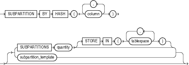

Description of subpartition_by_hash.gif follows
(subpartition_template::=)

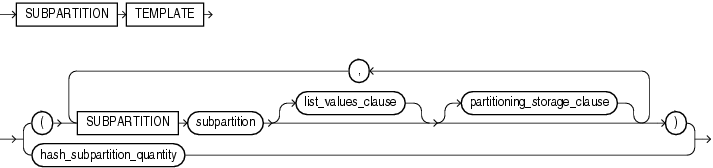

Description of subpartition_template.gif follows
(list_values_clause::=, partitioning_storage_clause::=)

relational_table
GLOBAL TEMPORARY
Specify GLOBAL TEMPORARY to indicate that the table is temporary and that its definition is visible to all sessions with appropriate privileges. The data in a temporary table is visible only to the session that inserts the data into the table.
When you first create a temporary table, its table metadata is stored in the data dictionary, but no space is allocated for table data. Space is allocated for the table segment at the time of the first DML operation on the table. The temporary table definition persists in the same way as the definitions of regular tables, but the table segment and any data the table contains are either session-specific or transaction-specific data. You specify whether the table segment and data are session- or transaction-specific with the ON COMMIT keywords.
You can perform DDL operations (such as ALTER TABLE, DROP TABLE, CREATE INDEX) on a temporary table only when no session is bound to it. A session becomes bound to a temporary table by performing an INSERT operation on the table. A session becomes unbound to the temporary table by issuing a TRUNCATE statement or at session termination, or, for a transaction-specific temporary table, by issuing a COMMIT or ROLLBACK statement.
See Also:
Oracle Database Concepts for information on temporary tables and "Temporary Table Example"
Restrictions on Temporary Tables Temporary tables are subject to the following restrictions:
  • Temporary tables cannot be partitioned, clustered, or index organized.
  • You cannot specify any foreign key constraints on temporary tables.
  • Temporary tables cannot contain columns of nested table.
  • You cannot specify the following clauses of the LOB_storage_clause: TABLESPACE, storage_clause, or logging_clause.
  • Parallel DML and parallel queries are not supported for temporary tables. Parallel hints are ignored. Specification of the parallel_clause returns an error.
  • You cannot specify the segment_attributes_clause, nested_table_col_properties, or parallel_clause.
  • Distributed transactions are not supported for temporary tables.

table_properties
The table_properties further define the characteristics of the table.
column_properties
Use the column_properties clauses to specify the storage attributes of a column.

range_partitioning
Use the range_partitioning clause to partition the table on ranges of values from the column list. For an index-organized table, the column list must be a subset of the primary key columns of the table.
column
Specify an ordered list of columns used to determine into which partition a row belongs. These columns are the partitioning key.
Restriction on Partitioning Key Columns The columns in the column list can be of any built-in datatype except ROWID, LONG, LOB, or TIMESTAMP WITH TIME ZONE. However, columns of TIMESTAMP or TIMESTAMP WITH LOCAL TIME ZONE can be used in the partitioning key.
PARTITION partition
The name partition must conform to the rules for naming schema objects and their part as described in "Schema Object Naming Rules". If you omit partition, then the database generates a name with the form SYS_Pn.
  • You can specify up to a total of 1024K-1 partitions and subpartitions. For a discussion of factors that might impose practical limits less than this number, please refer to Oracle Database Administrator's Guide.
  • You can create a partitioned table with just one partition. However, this is different from a nonpartitioned table. For instance, you cannot add a partition to a nonpartitioned table.
range_values_clause
Specify the noninclusive upper bound for the current partition. The value list is an ordered list of literal values corresponding to the column list in the range_partitioning clause. You can substitute the keyword MAXVALUE for any literal in in the value list. MAXVALUE specifies a maximum value that will always sort higher than any other value, including null.
Specifying a value other than MAXVALUE for the highest partition bound imposes an implicit integrity constraint on the table.
If table is partitioned on a DATE column, and if the date format does not specify the first two digits of the year, then you must use the TO_DATE function with the YYYY 4-character format mask for the year. The RRRR format mask is not supported in this clause. The date format is determined implicitly by NLS_TERRITORY or explicitly by NLS_DATE_FORMAT. Please refer to Oracle Database Globalization Support Guide for more information on these initialization parameters.
See Also:

hash_partitioning
Use the hash_partitioning clause to specify that the table is to be partitioned using the hash method.
Oracle Database assigns rows to partitions using a hash function on values found in columns designated as the partitioning key. You can specify individual hash partitions or you can specify how many subpartitions the database should create.
column Specify an ordered list of columns used to determine into which partition a row belongs (the partitioning key).
individual_hash_partitions  Use this clause to specify individual partitions by name. If you omit the partition name, then the database assigns partition names of the form SYS_Pn.
Restriction on Specifying Individual Hash Partitions The only clause you can specify in the partitioning_storage_clause is the TABLESPACE clause.
If your enterprise has or will have databases using different character sets, use caution when partitioning on character columns. The sort sequence of characters is not identical in all character sets. Please refer to Oracle Database Globalization Support Guide for more information on character set support.
hash_partitions_by_quantity  Alternatively, you can specify the number of partitions. In this case, the database assigns partition names of the form SYS_Pn. The STORE IN clause specifies one or more tablespaces where the hash partitions are to be stored. The number of tablespaces does not have to equal the number of partitions. If the number of partitions is greater than the number of tablespaces, then the database cycles through the names of the tablespaces.
For both methods of hash partitioning, for optimal load balancing you should specify a number of partitions that is a power of 2. Also for both methods of hash partitioning, the only attribute you can specify for hash partitions is TABLESPACE. Hash partitions inherit all other attributes from table-level defaults.

list_partitioning
Use the list_partitioning clause to partition the table on lists of literal values from column. List partitioning is useful for controlling how individual rows map to specific partitions.
list_values_clause The list_values_clause of each partition must have at least one value. No value, including NULL, can appear in more than one partition. List partitions are not ordered.
If you specify the literal NULL for a partition value in the VALUES clause, then to access data in that partition in subsequent queries, you must use an IS NULL condition in the WHERE clause, rather than a comparison condition.
The DEFAULT keyword creates a partition into which the database will insert any row that does not map to another partition. Therefore, you can specify DEFAULT for only one partition, and you cannot specify any other values for that partition. Further, the default partition must be the last partition you define. The use of DEFAULT is similar to the use of MAXVALUE for range partitions.
The string comprising the list of values for each partition can be up to 4K bytes. The total number of values for all partitions cannot exceed 64K-1.
Restrictions on List Partitioning List partitioning is subject to the following restrictions:
  • You cannot subpartition a list partition.
  • You can specify only one partitioning key in column_list, and it cannot be a LOB column.
  • If the partitioning key is an object type column, then you can partition on only one attribute of the column type.
  • Each value in the list_values_clause must be unique among all partitions of table.
Use the composite_partitioning clause to first partition table by range, and then partition the partitions further into hash or list subpartitions. This combination of range partitioning and hash or list subpartitioning is called composite partitioning.
After establishing the type of subpartitioning you want for each composite partition, using the subpartition_by_hash or subpartition_by_list clause, you must define each of the range partitions.
  • You must specify the range_values_clause , which has the same requirements as for noncomposite range partitions.
  • Use the table_partition_description to define the physical and storage characteristics of the each partition. Within the table_partition_description, you can use the partition_level_subpartition clause to define the properties of individual subpartitions.
  • If you omit the partition name, then the database generates a name with the form SYS_Pn.
  • The only characteristic you can specify for a hash or list subpartition or a LOB subpartition is TABLESPACE.
Restriction on Composite Partitioning You cannot specify composite partitioning for an index-organized table. Therefore, the OVERFLOW clause of the table_partition_description is not valid for composite-partitioned tables.
subpartition_template The subpartition_template is an optional element of both range-hash and range-list composite partitioning. The template lets you define default subpartitions for each table partition. Oracle Database will create these default subpartitions in any partition for which you do not explicitly define subpartitions. This clause is useful for creating symmetric partitions. You can override this clause by explicitly defining subpartitions at the partition level, in the partition_level_subpartition clause.
When defining subpartitions with a template, you must specify a name for each subpartition.
When you specify tablespace storage for the subpartition template, it does not override any tablespace storage you have specified explicitly for the partitions of table. To specify tablespace storage for subpartitions, do one of these things:
  • Omit tablespace storage at the partition level and specify tablespace storage in the subpartition template.
  • Define individual subpartitions with specific tablespace storage.
Restrictions on Subpartition Templates Subpartition templates are subject to the following restrictions:
  • For a range-hash composite-partitioned table, you cannot specify the list_values_clause.
  • For a range-list composite-partitioned table, you cannot specify the hash_subpartition_quantity clause.
  • For both range-hash and range-list partitioned tables, the only clause of the partitioning_storage_clause you can specify for subpartitions is the TABLESPACE clause.
Use the subpartition_by_hash clause to indicate that the database should subpartition by hash each partition in table. The subpartitioning column list is unrelated to the partitioning key but is subject to the same restrictions (see column).
You can define the subpartitions using the subpartition_template or the SUBPARTITIONS quantity clause. See subpartition_template. In either case, for optimal load balancing you should specify a number of partitions that is a power of 2.
SUBPARTITIONS quantity Specify the default number of subpartitions in each partition of table, and optionally one or more tablespaces in which they are to be stored.
The default value is 1. If you omit both this clause and subpartition_template, then the database will create each partition with one hash subpartition unless you subsequently specify the partition_level_subpartition clause.
Restriction on Hash Subpartitioning In addition to the restrictions for composite partitioning in general (see composite_partitioning ), for hash subpartitioning in subpartition_template, you cannot specify the list_values_clause.
Use the subpartition_by_list clause to indicate that the database should subpartition each partition in table by literal values from column.
If you omit subpartition_template, then you can define list subpartitions individually for each partition using the partition_level_subpartition clause of table_partition_description. If you omit both subpartition_template and partition_level_subpartition, then the database creates a single DEFAULT subpartition.
Restrictions on List Subpartitioning List subpartitioning is subject to the following restrictions:
In addition to the restrictions for composite partitioning in general (see composite_partitioning ), for list subpartitioning:
  • You can specify only one subpartitioning key column.
  • You must specify the list_values_clause, which is subject to the same requirements as at the table level.
  • In the subpartition_template, you cannot specify the hash_subpartition_quantity clause.
This clause of the table_partition_description is valid only for composite-partitioned tables. This clause lets you specify hash or list subpartitions for partition. This clause overrides the default settings established for range-hash composite partitions in the subpartition_by_hash clause or for range-hash or range-list composite partitions in the subpartition_template.
Notes on Composite Partitions The following notes apply to composite partitions:
  • You can specify the number of subpartitions and optionally one or more tablespaces where they are to be stored. In this case, Oracle Database assigns subpartition names of the form SYS_SUBPn. The number of tablespaces does not have to equal the number of subpartitions. If the number of partitions is greater than the number of tablespaces, then the database cycles through the names of the tablespaces.
  • Alternatively, you can use the subpartition_spec to specify individual subpartitions by name, and optionally the tablespace where each should be stored.
  • If you omit partition_level_subpartition and if you have created a subpartition template, then the database uses the template to create subpartitions. If you have not created a subpartition template, then the database creates one hash subpartition or one DEFAULT list subpartition.
  • If you omit partition_level_subpartition entirely, then the database assigns subpartition names as follows:
    • If you have specified a subpartition template and you have specified partition names, then the database generates subpartition names of the form partition_name underscore (_) subpartition_name (for example, P1_SUB1).
    • If you have not specified a subpartition template or if you have specified a subpartition template but did not specify partition names, then the database generates subpartition names of the form SYS_SUBPn.
  • In partition_spec, the only clause of the partitioning_storage_clause you can specify is the TABLESPACE clause.
For range-hash composite partitions, the list_values_clause of subpartition_spec is not relevant and is invalid.
For range-list composite partitions:
  • The hash_subpartition_quantity is not relevant, so you specify subpartition_spec.
  • Within subpartition_spec, you must specify the list_values_clause for each subpartition, and the values you specify for each subpartition cannot exist in any other subpartition of the same partition.
CACHE | NOCACHE | CACHE READS
Use the CACHE clauses to indicate how Oracle Database should store blocks in the buffer cache. If you specify neither CACHE nor NOCACHE, then:
  • In a CREATE TABLE statement, NOCACHE is the default
  • In an ALTER TABLE statement, the existing value is not changed.
CACHE For data that is accessed frequently, this clause indicates that the blocks retrieved for this table are placed at the most recently used end of the least recently used (LRU) list in the buffer cache when a full table scan is performed. This attribute is useful for small lookup tables.
As a parameter in the LOB_storage_clause, CACHE specifies that the database places LOB data values in the buffer cache for faster access.
Restriction on CACHE You cannot specify CACHE for an index-organized table. However, index-organized tables implicitly provide CACHE behavior.
NOCACHE For data that is not accessed frequently, this clause indicates that the blocks retrieved for this table are placed at the least recently used end of the LRU list in the buffer cache when a full table scan is performed. NOCACHE is the default for LOB storage.
As a parameter in the LOB_storage_clause, NOCACHE specifies that the LOB value either is not brought into the buffer cache or is brought into the buffer cache and placed at the least recently used end of the LRU list. The latter is the default behavior.
Restriction on NOCACHE You cannot specify NOCACHE for an index-organized table.
CACHE READS CACHE READS applies only to LOB storage. It specifies that LOB values are brought into the buffer cache only during read operations but not during write operations.
See Also:
logging_clause for a description of the logging_clause when specified as part of LOB_parameters
parallel_clause
The parallel_clause lets you parallelize creation of the table and set the default degree of parallelism for queries and the DML INSERT, UPDATE, DELETE, and MERGE after table creation.
The syntax of the parallel_clause supersedes syntax appearing in earlier releases of Oracle. Superseded syntax is still supported for backward compatibility but may result in slightly different behavior from that documented.
NOPARALLEL Specify NOPARALLEL for serial execution. This is the default.
PARALLEL  Specify PARALLEL if you want Oracle to select a degree of parallelism equal to the number of CPUs available on all participating instances times the value of the PARALLEL_THREADS_PER_CPU initialization parameter.
PARALLEL integer Specification of integer indicates the degree of parallelism, which is the number of parallel threads used in the parallel operation. Each parallel thread may use one or two parallel execution servers. Normally Oracle calculates the optimum degree of parallelism, so it is not necessary for you to specify integer.
See Also:
parallel_clause for more information on this clause
NOROWDEPENDENCIES | ROWDEPENDENCIES
This clause lets you specify whether table will use row-level dependency tracking. With this feature, each row in the table has a system change number (SCN) that represents a time greater than or equal to the commit time of the last transaction that modified the row. You cannot change this setting after table is created.
ROWDEPENDENCIES Specify ROWDEPENDENCIES if you want to enable row-level dependency tracking. This setting is useful primarily to allow for parallel propagation in replication environments. It increases the size of each row by 6 bytes.
NOROWDEPENDENCIES Specify NOROWDEPENDENCIES if you do not want table to use the row-level dependency tracking feature. This is the default.
See Also:
Oracle Database Advanced Replication for information about the use of row-level dependency tracking in replication environments
MONITORING | NOMONITORING
In earlier releases, you could use these clauses to start or stop the collection of modification statistics on this table. These clauses have been deprecated.
  • If you formerly collected modification statistics on tables by using the DBMS_STATS package in GATHER AUTO or GATHER STALE mode, then you no longer have to do anything. Oracle Database now collects these statistics automatically, and the MONITORING and NOMONITORING keywords in existing code will not cause an error.
  • If, for performance reasons, you do not want to collect modification statistics on any tables, then you should set the STATISTICS_LEVEL initialization parameter to BASIC. Be aware, however, that doing so disables a number of manageability features.

object_table
The OF clause lets you explicitly create an object table of type object_type. The columns of an object table correspond to the top-level attributes of type object_type. Each row will contain an object instance, and each instance will be assigned a unique, system-generated object identifier when a row is inserted. If you omit schema, then the database creates the object table in your own schema.
Object tables, as well as XMLType tables, object views, and XMLType views, do not have any column names specified for them. Therefore, Oracle defines a system-generated pseudocolumn OBJECT_ID. You can use this column name in queries and to create object views with the WITH OBJECT IDENTIFIER clause.
Use the object_table_substitution clause to specify whether row objects corresponding to subtypes can be inserted into this object table.
NOT SUBSTITUTABLE AT ALL LEVELS NOT SUBSTITUTABLE AT ALL LEVELS indicates that the object table being created is not substitutable. In addition, substitution is disabled for all embedded object attributes and elements of embedded nested tables and arrays. The default is SUBSTITUTABLE AT ALL LEVELS.
See Also:
object_properties
The properties of object tables are essentially the same as those of relational tables. However, instead of specifying columns, you specify attributes of the object.
For attribute, specify the qualified column name of an item in an object.
oid_clause
The oid_clause lets you specify whether the object identifier of the object table should be system generated or should be based on the primary key of the table. The default is SYSTEM GENERATED.
Restrictions on the oid_clause This clause is subject to the following restrictions:
  • You cannot specify OBJECT IDENTIFIER IS PRIMARY KEY unless you have already specified a PRIMARY KEY constraint for the table.
  • You cannot specify this clause for a nested table.
A primary key object identifier is locally unique but not necessarily globally unique. If you require a globally unique identifier, then you must ensure that the primary key is globally unique.
oid_index_clause
This clause is relevant only if you have specified the oid_clause as SYSTEM GENERATED. It specifies an index, and optionally its storage characteristics, on the hidden object identifier column.
For index, specify the name of the index on the hidden system-generated object identifier column. If you omit index, then the database generates a name.
physical_properties and table_properties
The semantics of these clauses are documented in the corresponding sections under relational tables. See physical_properties and table_properties.
XMLType_table
Use the XMLType_table syntax to create a table of datatype XMLType. Most of the clauses used to create an XMLType table have the same semantics that exist for object tables. The clauses specific to XMLType tables are described in this section.
XMLType_storage
This clause lets you determine how Oracle Database manages the storage of the underlying columns.
OBJECT RELATIONAL Specify OBJECT RELATIONAL if you want the database to store the XMLType data in object relational columns. If you specify OBJECT RELATIONAL, then you must also specify an XMLSchema in the XMLSchema_storage_clause, and you must already have registered the schema using the DBMS_XMLSCHEMA package. Oracle Database will create the table conforming to the registered schema.
CLOB Specify CLOB if you want the database to store the XML data in a CLOB column. If you specify CLOB, then you may also specify either a LOB segment name, or the LOB_parameters clause, or both.
XMLSchema_spec
This clause lets you specify the URL of a registered XMLSchema, either in the XMLSCHEMA clause or as part of the ELEMENT clause, and an XML element name. You must specify an element, although the XMLSchema URL is optional. If you do specify an XMLSchema URL, then you must already have registered the XMLSchema using the DBMS_XMLSCHEMA package.
See Also:

Temporary Table Example The following statement creates a temporary table today_sales for use by sales representatives in the sample database. Each sales representative session can store its own sales data for the day in the table. The temporary data is deleted at the end of the session.
CREATE GLOBAL TEMPORARY TABLE today_sales
   ON COMMIT PRESERVE ROWS
   AS SELECT * FROM orders WHERE order_date = SYSDATE;

XMLType Table Examples The following example creates a very simple XMLType table with one implicit CLOB column:
CREATE TABLE xwarehouses OF XMLTYPE;
Because Oracle Database implicitly stores the data in a CLOB column, it is subject to all of the restrictions on LOB columns. To avoid these restrictions, you can create an XMLSchema-based table, as shown in the following example. The XMLSchema must already have been created (see "Using XML in SQL Statements" for more information):
   XMLSCHEMA "http://www.oracle.com/xwarehouses.xsd"
   ELEMENT "Warehouse";

Range Partitioning Example The sales table in the sample schema sh is partitioned by range. The following example shows an abbreviated variation of the sales table. Constraints and storage elements have been omitted from the example.
CREATE TABLE range_sales
    ( prod_id        NUMBER(6)
    , cust_id        NUMBER
    , time_id        DATE
    , channel_id     CHAR(1)
    , promo_id       NUMBER(6)
    , quantity_sold  NUMBER(3)
    , amount_sold         NUMBER(10,2)
PARTITION BY RANGE (time_id)
  (PARTITION SALES_Q1_1998 VALUES LESS THAN (TO_DATE('01-APR-1998','DD-MON-YYYY')),
   PARTITION SALES_Q2_1998 VALUES LESS THAN (TO_DATE('01-JUL-1998','DD-MON-YYYY')),
   PARTITION SALES_Q3_1998 VALUES LESS THAN (TO_DATE('01-OCT-1998','DD-MON-YYYY')),
   PARTITION SALES_Q4_1998 VALUES LESS THAN (TO_DATE('01-JAN-1999','DD-MON-YYYY')),
   PARTITION SALES_Q1_1999 VALUES LESS THAN (TO_DATE('01-APR-1999','DD-MON-YYYY')),
   PARTITION SALES_Q2_1999 VALUES LESS THAN (TO_DATE('01-JUL-1999','DD-MON-YYYY')),
   PARTITION SALES_Q3_1999 VALUES LESS THAN (TO_DATE('01-OCT-1999','DD-MON-YYYY')),
   PARTITION SALES_Q4_1999 VALUES LESS THAN (TO_DATE('01-JAN-2000','DD-MON-YYYY')),
   PARTITION SALES_Q1_2000 VALUES LESS THAN (TO_DATE('01-APR-2000','DD-MON-YYYY')),
   PARTITION SALES_Q2_2000 VALUES LESS THAN (TO_DATE('01-JUL-2000','DD-MON-YYYY')),
   PARTITION SALES_Q3_2000 VALUES LESS THAN (TO_DATE('01-OCT-2000','DD-MON-YYYY')),
   PARTITION SALES_Q4_2000 VALUES LESS THAN (MAXVALUE))
For information about partitioned table maintenance operations, see Oracle Database Administrator's Guide.

   PARTITION BY LIST (nls_territory) (
   PARTITION asia VALUES ('CHINA', 'THAILAND'),
   PARTITION europe VALUES ('GERMANY', 'ITALY', 'SWITZERLAND'),
   PARTITION west VALUES ('AMERICA'),
   PARTITION east VALUES ('INDIA'),
   PARTITION rest VALUES (DEFAULT));

The following examples creates a partitioned table of customers based on the sample table oe.customers. In this example, the table is partitioned on the credit_limit column and list subpartitioned on the nls_territory column. The subpartition template determines the subpartitioning of any subsequently added partitions, unless you override the template by defining individual subpartitions. This composite partitioning makes it possible to query the table based on a credit limit range within a specified region:
CREATE TABLE customers_part (
   customer_id        NUMBER(6),
   cust_first_name    VARCHAR2(20),
   cust_last_name     VARCHAR2(20),
   nls_territory      VARCHAR2(30),
   credit_limit       NUMBER(9,2))
   PARTITION BY RANGE (credit_limit)
   SUBPARTITION BY LIST (nls_territory)
      SUBPARTITION TEMPLATE
         (SUBPARTITION east  VALUES
            ('CHINA', 'JAPAN', 'INDIA', 'THAILAND'),
          SUBPARTITION west VALUES
             ('AMERICA', 'GERMANY', 'ITALY', 'SWITZERLAND'),
          SUBPARTITION other VALUES (DEFAULT))
      (PARTITION p1 VALUES LESS THAN (1000),
       PARTITION p2 VALUES LESS THAN (2500),
       PARTITION p3 VALUES LESS THAN (MAXVALUE));

Creating Object Tables: Examples Consider object type department_typ:
CREATE TYPE department_typ AS OBJECT
   ( d_name   VARCHAR2(100),
     d_address VARCHAR2(200) );
Object table departments_obj_t holds department objects of type department_typ:
CREATE TABLE departments_obj_t OF department_typ;
