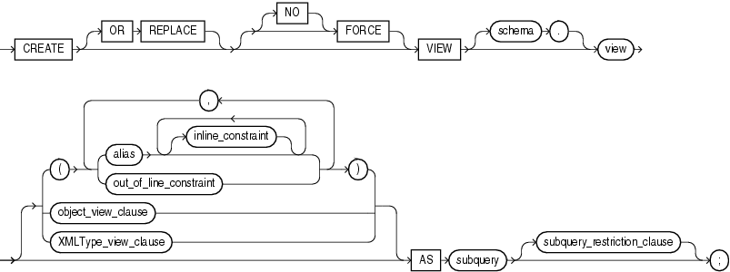

Use the CREATE VIEW statement to define a view, which is a logical table based on one or more tables or views. A view contains no data itself. The tables upon which a view is based are called base tables.
You can also create an object view or a relational view that supports LOBs, object types, REF datatypes, nested table, or varray types on top of the existing view mechanism. An object view is a view of a user-defined type, where each row contains objects, each object with a unique updatableobject identifier.
You can also create XMLType views, which are similar to an object views but display data from XMLSchema-based tables of XMLType.

Specify OR REPLACE to re-create the view if it already exists. You can use this clause to change the definition of an existing view without dropping, re-creating, and regranting object privileges previously granted on it.
INSTEAD OF triggers defined in the view are dropped when a view is re-created.
If any materialized views are dependent on view, then those materialized views will be marked UNUSABLE and will require a full refresh to restore them to a usable state. Invalid materialized views cannot be used by query rewrite and cannot be refreshed until they are recompiled.
See Also:
ALTER MATERIALIZED VIEW for information on refreshing invalid materialized views
Oracle Database Concepts for information on materialized views in general
CREATE TRIGGER for more information about the INSTEAD OF clause
Specify FORCE if you want to create the view regardless of whether the base tables of the view or the referenced object types exist or the owner of the schema containing the view has privileges on them. These conditions must be true before any SELECT, INSERT, UPDATE, or DELETE statements can be issued against the view.
If the view definition contains any constraints, CREATE VIEW ... FORCE will fail if the base table does not exist or the referenced object type does not exist. CREATE VIEW ... FORCE will also fail if the view definition names a constraint that does not exist.
Specify NOFORCE if you want to create the view only if the base tables exist and the owner of the schema containing the view has privileges on them. This is the default.
Specify the schema to contain the view. If you omit schema, then Oracle Database creates the view in your own schema.
Specify the name of the view or the object view.

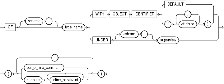

The object_view_clause lets you define a view on an object type.
See Also:
"Creating an Object View: Example"Use this clause to explicitly create an object view of type type_name. The columns of an object view correspond to the top-level attributes of type type_name. Each row will contain an object instance and each instance will be associated with an object identifier as specified in the WITH OBJECT IDENTIFIER clause. If you omit schema, then the database creates the object view in your own schema.
Object tables, as well as XMLType tables, object views, and XMLType views, do not have any column names specified for them. Therefore, Oracle Database defines a system-generated pseudocolumn OBJECT_ID. You can use this column name in queries and to create object views with the WITH OBJECT IDENTIFIER clause.
Use the WITH OBJECT IDENTIFIER clause to specify a top-level (root) object view. This clause lets you specify the attributes of the object type that will be used as a key to identify each row in the object view. In most cases these attributes correspond to the primary key columns of the base table. You must ensure that the attribute list is unique and identifies exactly one row in the view.
Restrictions on Object Views Object views are subject to the following restrictions:
If you try to dereference or pin a primary key REF that resolves to more than one instance in the object view, then the database returns an error.
You cannot specify this clause if you are creating a subview, because subviews inherit object identifiers from superviews.
The the database8i, Release 8.0 syntaxWITH OBJECT OID is replaced with this syntax for clarity. The keywords WITH OBJECT OID are supported for backward compatibility, but Oracle recommends that you use the new syntax WITH OBJECT IDENTIFIER.If the object view is defined on an object table or an object view, then you can omit this clause or specify DEFAULT.
DEFAULT Specify DEFAULT if you want the database to use the intrinsic object identifier of the underlying object table or object view to uniquely identify each row.
attribute For attribute, specify an attribute of the object type from which the database should create the object identifier for the object view.
