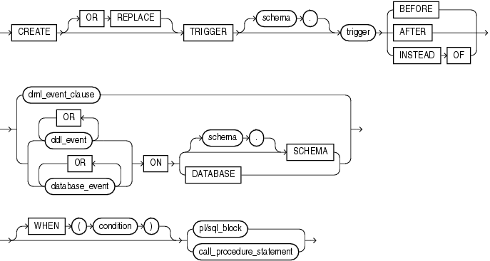

Use the CREATE
TRIGGER
statement to create and enable a database trigger, which is:
A stored PL/SQL block associated with a table, a schema, or the database or
An anonymous PL/SQL block or a call to a procedure implemented in PL/SQL or Java
Oracle Database automatically executes a trigger when specified conditions occur.
When you create a trigger, the database enables it automatically. You can subsequently disable and enable a trigger with the DISABLE
and ENABLE
clause of the ALTER
TRIGGER
or ALTER
TABLE
statement.

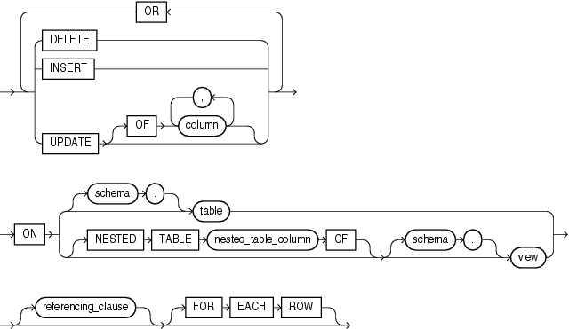

DML_event_clause ::=
Specify OR
REPLACE
to re-create the trigger if it already exists. Use this clause to change the definition of an existing trigger without first dropping it.
Specify the schema to contain the trigger. If you omit schema
, then Oracle Database creates the trigger in your own schema.
Specify the name of the trigger to be created.
If a trigger produces compilation errors, then it is still created, but it fails on execution. This means it effectively blocks all triggering DML statements until it is disabled, replaced by a version without compilation errors, or dropped. You can see the associated compiler error messages with the SQL*Plus command SHOW
ERRORS
If you create a trigger on a base table of a materialized view, then you must ensure that the trigger does not fire during a refresh of the materialized view. During refresh, theDBMS_MVIEW
procedure I_AM_A_REFRESH
returns TRUE
.Specify BEFORE
to cause the database to fire the trigger before executing the triggering event. For row triggers, the trigger is fired before each affected row is changed.

Specify AFTER
to cause the database to fire the trigger after executing the triggering event. For row triggers, the trigger is fired after each affected row is changed.

CREATE MATERIALIZED VIEW LOG for more information on materialized view logsSpecify INSTEAD
OF
to cause Oracle Database to fire the trigger instead of executing the triggering event. INSTEAD
OF
triggers are valid for DML events on views. They are not valid for DDL or database events.

lets you specify one of three DML statements that can cause the trigger to fire. Oracle Database fires the trigger in the existing user transaction.
You cannot specify the MERGE
keyword in the DML_event_clause
. If you want a trigger to fire in relation to a MERGE
operation, you must create triggers on the INSERT
and UPDATE
operations to which the MERGE
operation decomposes.

"Creating a DML Trigger: Examples"Specify DELETE
if you want the database to fire the trigger whenever a DELETE
statement removes a row from the table or removes an element from a nested table.
Specify INSERT
if you want the database to fire the trigger whenever an INSERT
statement adds a row to a table or adds an element to a nested table.
Specify UPDATE
if you want the database to fire the trigger whenever an UPDATE
statement changes a value in one of the columns specified after OF
. If you omit OF
, then the database fires the trigger whenever an UPDATE
statement changes a value in any column of the table or nested table.
For an UPDATE
trigger, you can specify object type, varray, and REF
columns after OF
to indicate that the trigger should be fired whenever an UPDATE
statement changes a value in one of the columns. However, you cannot change the values of these columns in the body of the trigger itself.
Using OCI functions or theDBMS_LOB
package to update LOB values or LOB attributes of object columns does not cause Oracle Database to fire triggers defined on the table containing the columns or the attributes.Restrictions on Triggers on UPDATE Operations The UPDATE
clause is subject to the following restrictions:
You cannot specify UPDATE
OF
for an INSTEAD
OF
trigger. Oracle Database fires INSTEAD
OF
triggers whenever an UPDATE
changes a value in any column of the view.
You cannot specify a nested table or LOB column in the UPDATE
OF
clause.

Specify one or more types of DDL statements that can cause the trigger to fire. You can create triggers for these events on DATABASE
or SCHEMA
unless otherwise noted. You can create BEFORE
and AFTER
triggers for these events. Oracle Database fires the trigger in the existing user transaction.
Restriction on Triggers on DDL Events You cannot specify as a triggering event any DDL operation performed through a PL/SQL procedure.
See Also:
"Creating a DDL Trigger: Example"The following ddl_event
values are valid:

Specify one or more particular states of the database that can cause the trigger to fire. You can create triggers for these events on DATABASE
or SCHEMA
unless otherwise noted. For each of these triggering events, Oracle Database opens an autonomous transaction scope, fires the trigger, and commits any separate transaction (regardless of any existing user transaction).
SERVERERROR Specify SERVERERROR
to fire the trigger whenever a server error message is logged.

clause lets you determine the database object on which the trigger is to be created. Specify the schema
and table
or view
name of one of the following on which the trigger is to be created:
Table or view
Object table or object view
A column of nested-table type
If you omit schema
, then Oracle Database assumes the table is in your own schema. You can create triggers on index-organized tables.
Restriction on Schema You cannot create a trigger on a table in the schema SYS

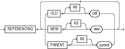

"Creating a SCHEMA Trigger: Example"The referencing_clause
lets you specify correlation names. You can use correlation names in the PL/SQL block and WHEN
condition of a row trigger to refer specifically to old and new values of the current row. The default correlation names are OLD
and NEW
. If your row trigger is associated with a table named OLD
or NEW
, use this clause to specify different correlation names to avoid confusion between the table name and the correlation name.
If the trigger is defined on a nested table, then OLD
and NEW
refer to the row of the nested table, and PARENT
refers to the current row of the parent table.
If the trigger is defined on an object table or view, then OLD
and NEW
refer to object instances.
