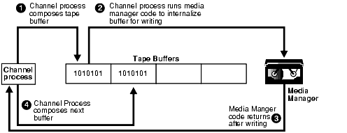

Figure 11-1 shows synchronous I/O in a backup to tape.
The following steps occur:
The channel process composes a tape buffer.
The channel process executes media manager code that processes the tape buffer and internalizes it for further processing and storage by the media manager.
The media manager code returns a message to the server process stating that it has completed writing.
The channel process can initiate a new task.

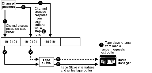

Figure 11-2 shows asynchronous I/O in a tape backup. Asynchronous I/O to tape is simulated by using tape slaves. In this case, each allocated channel corresponds to a server process, which in the explanation which follows is identified as a channel process. For each channel process, one tape slave is started (or more than one, in the case of multiple copies).
A channel process writes blocks to a tape buffer.
The channel process sends a message to the tape slave process to process the tape buffer. The tape slave process executes media manager code that processes the tape buffer and internalizes it so that the media manager can process it.
While the tape slave process is writing, the channel process is free to read data from the datafiles and prepare more output buffers.
Once the tape slave channel returns from the media manager code, it requests a new tape buffer, which usually is ready. Thus waiting time for the channel process is reduced, and the backup is completed faster.
