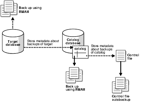

Decide which database you will use to install the recovery catalog schema, and also how you will back up this database.
Do not use the target database to be backed up as the database for the recovery catalog. The recovery catalog must be protected in the event of the loss of the target database.Also, decide whether to operate the catalog database in ARCHIVELOG
mode, which is recommended.

Ensure that the recovery catalog and target databases do not reside on the same disk. If both your recovery catalog and your target database suffer hard disk failure, your recovery process is much more difficult. If possible, take other measures as well to eliminate common points of failure between your recovery catalog database and the databases you are backing up.

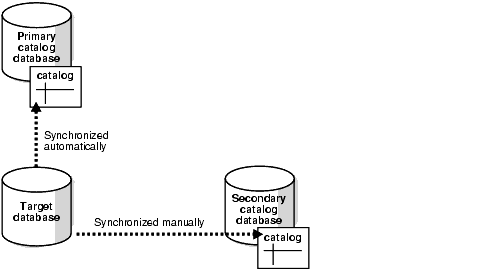

You can register multiple target databases in a single recovery catalog, if they do not have duplicate DBIDs. RMAN uses the DBID to distinguish one database from another.
In general, if you use the DUPLICATE RMAN command or CREATE DATABASE SQL statement, the database created is assigned a unique DBID. If you create a database by some other means, such as a user-managed copy, then the new database may have the same DBID as the one from which it was copied. You will not be able to register both databases in the same recovery catalog until you change the DBID of the copied database using the DBNEWID
utility.
Note that you can also register a single target databases in multiple recovery catalogs.

The recovery catalog database is a database like any other, and is also a key part of your backup and recovery strategy. Protect the recovery catalog as you would protect any other part of your database, by backing it up. The backup strategy for your recovery catalog database should be part of your overall backup and recovery strategy.
Back up the recovery catalog with the same frequency that you back up the target database. For example, if you make a weekly whole database backup of the target database, then back up the recovery catalog immediately after all target database backups, in order to protect the record of the whole database backup. This backup can help you in a disaster recovery scenario. Even if you have to restore the recovery catalog database using a control file autobackup, you can then use the full record of backups in your restored recovery catalog database to restore the target database without using a control file autobackup for the target database.
When backing up the recovery catalog database, you can use RMAN to make the backups. As illustrated in Figure 10-1, you should start RMAN with the NOCATALOG
option so that the repository for the recovery catalog is the control file in the catalog database.
Follow these guidelines when developing an RMAN backup strategy for the recovery catalog database:
Run the recovery catalog database in ARCHIVELOG
mode so that you can do point-in-time recovery if needed.
Set the retention policy to a REDUNDANCY
value greater than 1
Back up the database onto two separate media (for example, disk and tape).
Run BACKUP
DATABASE
PLUS
ARCHIVELOG
at regular intervals, to a media manager if available, or just to disk.
Do not use another recovery catalog as the repository for the backups.
Configure the control file autobackup feature to ON
With this strategy, the control file autobackup feature ensures that the recovery catalog database can always be recovered, so long as the control file autobackup is available.
Figure 10-1 Using the Control File as the Repository for Backups of the Recovery Catalog
See Also:
"Performing Disaster Recovery" for more information for recovery with a control file autobackupNever store a recovery catalog containing the RMAN repository for a database in the same database as the target database or on the same disks as the target database. For example, do not store the catalog for database prod1

You may have a production system in which you want to maintain high availability for the catalog database. For example, you may have 100 target databases registered in the recovery catalog. In case the primary catalog database goes down, you can create redundancy by storing a secondary recovery catalog in a separate database, as illustrated in Figure 10-2. You must register the target database in the secondary catalog.
In this availability scenario, the main catalog is synchronized as normal during regular backups, while the secondary catalog is synchronized periodically with the RESYNC
CATALOG
command. If the primary catalog database goes down or requires routine maintenance, then you can resynchronize the secondary catalog and use it as the new primary catalog during the interim.
Figure 10-2 Registering One Target Database in Two Recovery Catalogs
See Also:
"Creating a Recovery Catalog"The LIST
