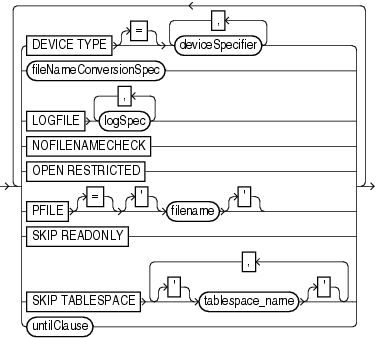

dupOptionList |
Specifies options that apply when creating a duplicate database not intended for use as a standby database. |
DEVICE TYPE deviceSpecifier |
Allocates automatic channels for the specific deviceSpecifier only (for example, DISK or sbt). This option is valid only if you have configured automatic channels and have not manually allocated channels. For example, if you CONFIGURE automatic disk and tape channels, and if you run DUPLICATE...DEVICE TYPE DISK, then RMAN allocates only disk channels.
See Also: "deviceSpecifier" |
| fileNameConversionSpec | Specifies one or more patterns to map original to duplicate filenames.
Note that this parameter overrides the initialization parameter See Also: "fileNameConversionSpec" |
LOGFILE logSpec |
Specifies the online redo logs when creating a nonstandby duplicate database. The syntax is the same used in the LOGFILE option of the CREATE DATABASE statement.
Refer to the description of |
NOFILENAMECHECK |
Prevents RMAN from checking whether target datafiles sharing the same names as the duplicated files are in use. The user is responsible for determining that the duplicate operation will not overwrite useful data.
This option is necessary when you are creating a duplicate database in a different host that has the same disk configuration, directory structure, and filenames as the host of the target database. For example, assume that you have a small database located in the /oracle/dbs/system_prod1.dbf /oracle/dbs/users_prod1.dbf /oracle/dbs/tools_prod1.dbf /oracle/dbs/rbs_prod1.dbf Assume that you want to duplicate the database in machine |
OPEN RESTRICTED |
Enables a restricted session in the duplicate database by issuing the following SQL statement: ALTER SYSTEM ENABLE RESTRICTED SESSION. RMAN issues this statement immediately before the duplicate database is opened. |
PFILE = 'filename' |
Specifies a client-side initialization parameter used by the auxiliary instance. RMAN automatically shuts down and restarts the auxiliary instance during duplication. If the auxiliary does not use a server-side parameter file in the default location, you must specify the client-side parameter file that RMAN should use when starting the auxiliary instance. Otherwise, you do not need to specify PFILE. |
SKIP READONLY |
Excludes datafiles in read-only tablespaces from the duplicate database.
Note: A record for the skipped read-only tablespace still appears in |
SKIP TABLESPACE 'tablespace_name' |
Excludes the specified tablespace from the duplicate database. Note that you cannot exclude the SYSTEM tablespace, undo tablespaces, and tablespaces with rollback segments. |
| untilClause | Sets the end point for incomplete recovery of the duplicate database. You can achieve the same result by running SET UNTIL before the DUPLICATE command.
See Also: "untilClause" |
