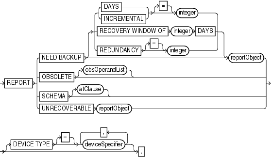

To perform detailed analyses of the RMAN repository. The Database writes the output from the REPORT command to standard output or the message log file.
Use the REPORT command to answer questions such as the following:
Which files need a backup?
Which files have not had a backup for some time?
Which files are not recoverable due to unrecoverable operations?
Which backup files can be deleted?
What was the physical schema of the database at a previous time?
See Also:
Oracle Database Backup and Recovery Basics to learn how to use RMAN's reporting functionalityExecute this command only at the RMAN prompt.
You must connect to a recovery catalog when issuing a REPORT SCHEMA command with the AT TIME, AT SCN, or AT SEQUENCE options. Otherwise, a recovery catalog is not required for the REPORT command.
| Syntax Element | Description |
NEED BACKUP |
Lists all datafiles in need of a new backup. The report assumes that you will use the most recent backup for restore operations. If you do not specify any option, then RMAN uses the current retention policy configuration. If the retention policy is disabled (CONFIGURE RETENTION POLICY TO NONE), RMAN generates an error. |
DAYS = integer |
Lists all datafiles requiring more than the specified number of days' worth of archived redo log files for complete recovery. For example, REPORT NEED BACKUP DAYS 7 DATABASE shows the datafiles whose recovery requires more than seven days' worth of archived redo logs.
If the target database control file is mounted and current, then RMAN makes the following optimizations to this report:
INCREMENTAL = integer |
Specifies a threshold number of incremental backups required for recovery. If complete recovery of a datafile requires more than integer incremental backups, then the datafile requires a new full backup.
Note: Files for which no backups exist will not appear in this list: issue the |
RECOVERY WINDOW OF integer DAYS |
Reports datafiles for which there are not sufficient backups to satisfy a recovery window-based retention policy for the specified number of days, that is, datafiles without sufficient backups for point-in-time recovery to any point back to the time SYSDATE - integer. |
REDUNDANCY = integer |
Specifies the minimum number of backups or copies that must exist for a datafile to be considered not in need of a backup. In other words, a datafile needs a backup if there are fewer than integer backups or copies of this file. For example, REDUNDANCY 2 means that if there are fewer than two copies or backups of a datafile, then it needs a new backup. |
OBSOLETE obsOperandList |
Lists full backups, datafile copies, and archived logs recorded in the RMAN repository that can be deleted because they are no longer needed. The subclause obsOperandList describes the criteria that RMAN uses to determine what is obsolete. If you do not specify parameters in obsOperandList, then RMAN uses the options specified in CONFIGURE RETENTION POLICY. If you use this option in conjunction with DEVICE TYPE, then RMAN only considers backups and copies created on the specified device.
Note: Even if you use a |
SCHEMA |
Lists the names of all datafiles and tablespaces at the specified point in time. |
UNRECOVERABLE |
Lists all unrecoverable datafiles. A datafile is considered unrecoverable if an unrecoverable operation has been performed against an object residing in the datafile since the last backup of the datafile.
Note: The nonexistence of any backup of a datafile is not sufficient reason to consider it unrecoverable. Such datafiles can be recovered through the use of the |
DEVICE TYPE deviceSpecifier |
Specifies the type of storage device. RMAN only considers backups and copies available on the specified device for its report. |

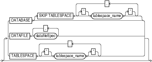

reportObject |
Specifies the datafiles to be included in the report. The report can include the entire database (optionally skipping certain tablespaces), a list of tablespaces, or a list of datafiles.
Note: RMAN includes objects from prior incarnations. |
DATAFILE datafileSpec |
Lists the specified datafiles. RMAN reports on backups or datafile copies that contain at least one of the specified datafiles. |
TABLESPACE 'tablespace_name' |
Lists datafiles in the specified tablespace. RMAN reports on backups or datafile copies that include at least one datafile from a specified tablespace. |
DATABASE |
Lists backups or datafile copies of all files in the current database. Specify SKIP TABLESPACE tablespace_name to exclude the specified tablespace from the DATABASE specification. |

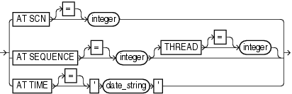

atClause |
Specifies a point in time as a time, an SCN, or a log sequence number. |
AT TIME = 'date_string' |
Specifies a date. The NLS_LANG and NLS_DATE_FORMAT environment variables specify the format for the time. |
AT SCN = integer |
Specifies an SCN. |
AT SEQUENCE = integer THREAD = integer |
Specifies a log sequence number for a specified redo THREAD number. The integer indicates the time when the specified log and thread were first opened. |
