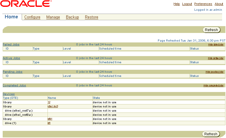

After you log in to the Oracle Secure Backup Web tool interface, the Oracle Secure Backup Home page appears. Figure 3-1 shows an example of the Home page.
The purpose of this page is to provide a snapshot of the current status of Oracle Secure Backup jobs and devices. As such, the page presents important summary information to administrators and users.
The main page includes the schedule times and status of recent jobs as well as job IDs, job type, and job level. Oracle Secure Backup provides a link for failed jobs, alerting users and administrators to potential trouble spots.
The Devices link lists the devices associated with each job along with information concerning device type, device name, and status. This page provides you with an overall picture of the various backup or restore processes that are going on.
A status of "device not in use" means that the device is present but is not currently being utilized for backup or restore operations.A menu bar at the top of the Oracle Secure Backup Home page enables you to select among the Configure, Manage, Backup, and Restore tabs.
When using the Web tool, make sure that your browser is configured to reload the page every time it is viewed. Otherwise, the browser may display stale information. For example, changes made inobtool

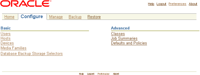

may not be visible in the browser.Click the Configure tab from the menu bar to display configuration options. Figure 3-2 shows an example of the Configure page.
The Configure page is divided into two main sections:
This section provides the following links:
Users
Click this link to configure one or more user accounts for logging into and employing Oracle Secure Backup.
Hosts
Click this link to configure one or more hosts. A host is a machine that participates in the Oracle Secure Backup administrative domain
Devices
Click this link to configure devices for use with Oracle Secure Backup. A device is a tape drive or library identified by a user-defined name.
Media Families
Click this link to configure media families. A media family is a named classification of backup volumes. A volume is a single unit of media, such as an 8mm tape.
Database Backup Storage Selectors
Click this link to configure one or more devices and media families for use during Oracle database backup and restore operations.
Classes
Click this link to configure classes. A class defines a set of rights that are granted to a user. A class can apply to multiple users; however, each user is assigned to exactly one class.
Job Summaries
Click this link to create a job summary schedule for generation of job summaries for email distribution. A job summary is a generated text file report that tells you whether a backup operation was successful. Oracle Secure Backup can generate and email job summaries detailing the status of scheduled backups.
Defaults and Policies
Click this link to edit defaults and policies. Defaults and policies are a set of configuration data that control how Oracle Secure Backup runs throughout an administrative domain.

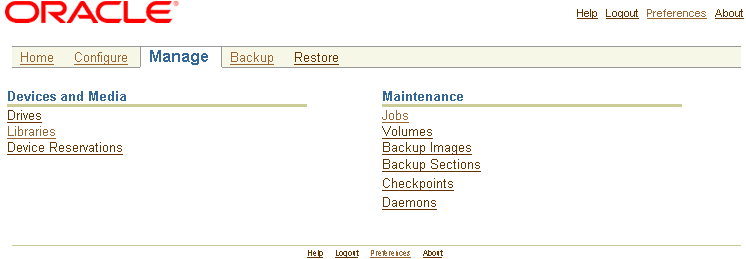

Click the Manage tab to display management options. Figure 3-3 shows an example of the Manage page.
The Manage page is divided into two main sections:
This section includes the following links:
Drives
Click this link to determine the status of a volume or device or mount or unmount a volume.
Libraries
Click this link to view and control libraries.
Device Reservations
Click this link to reserve and unreserve devices for private use.
Jobs
Click this link to manage jobs in an administrative domain. You can view the status of backup and restore jobs.
Volumes
Click this link to filter and then view all volumes in the catalog. You can filter the results to scale down your search. A volume is a single unit of media, such as 8mm tape. A volume can contain one or more backup images.
Backup Images
Click this link to manage backup images. A backup image is the work product of a single backup operation.
Backup Sections
Click this link to view and remove backup sections. A backup section is that part of a backup image that occupies one physical volume.
Checkpoints
Click this link to list and delete checkpoints describing certain in-progress, failed, and completed NDMP backups.
Daemons
Click this link to manage daemons and control and view daemon properties.

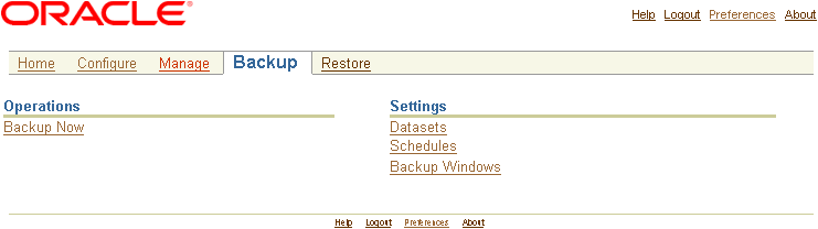

Click the Backup tab to display backup image options. Figure 3-2 shows a sample page.
The Backup page is divided into two main sections:
This section includes the Backup Now link. Click this link to perform one-time backups of data described by existing dataset files.
Datasets
Click this link to configure dataset files. A dataset file describes the data that you want to back up.
Schedules
Click this link to configure a backup schedule. The backup schedule describes the frequency with which a backup runs.
Backup Windows
Click this link to configure backup windows. A backup window is a time range for the execution of scheduled backups.

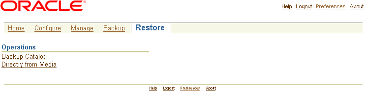

Click the Restore tab to display restore options. Figure 3-5 shows a sample page.
The Operations section includes the following links:
Backup Catalog
Click this link to browse data associated with backup and restore operations.
Directly from Media
Click this link to perform raw restores, which require prior knowledge of the names of the file system objects you want to restore. You must also know the volume IDs and the file numbers on which the volumes are stored.

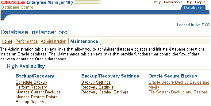

You can use Oracle Enterprise Manager 10g (10.2) to use the Oracle Secure Backup SBT interface for database backup and restore operations. You cannot use Enterprise Manager to perform file system backup and restore operations, although Enterprise Manager includes a link to the Web tool. In general, you should use Enterprise Manager only for database-related tasks.
You can make RMAN backups to the Oracle Secure Backup SBT interface by using Enterprise Manager Database Control or Grid Control. As explained in "Interfaces for Managing Database Backup and Recovery", the Database Control console must run on the administrative server and can only back up an Oracle database running on the administrative server. You can run the Grid Control console on any database host in the administrative domain and use it to back up any database in the domain. This section describes how to get started with the Database Control console.
To use Enterprise Manager to manage your backups, you need to make Enterprise Manager aware of your administrative server. As explained in "Administrative Domains", the administrative server stores the configuration data and catalog for the administrative domain.
This section assumes that you are familiar with Oracle Enterprise Manager Database Control and use it to manage backup and recovery. If you need an introduction to using Oracle Enterprise Manager with RMAN, refer to the chapter on backup and recovery in Oracle Database 2 Day DBA.To register the administrative server in Oracle Enterprise Manager Database Control:

Navigate to the Oracle Secure Backup section of the Maintenance page. Figure 3-6 shows the relevant section of the Maintenance page.
If you are using releases 10.2.0.1 or 10.2.0.2 of Enterprise Manager Grid Control or release 10.2.0.2 of Enterprise Manager Database Control, then the Maintenance page does not include the Oracle Secure Backup section by default. In this case, proceed to the next step to make the links active; otherwise, skip the following step and proceed directly to Step 4.
If (and only if) the Oracle Secure Backup section does not appear in the Maintenance page, then perform the following steps:

Navigate to the Maintenance page and confirm that the Oracle Secure Backup section is shown.
Click Oracle Secure Backup Device and Media.
