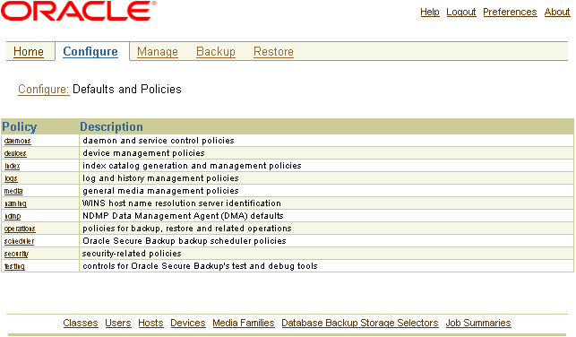

In the Advanced section of the Configure page, click Defaults and Policies to display the page shown in Figure 4-1. This page lists the policy classes.

To change a policy setting:
In the Policy column on the Defaults and Policies page, click the name of the policy class to be edited. For example, click scheduler.

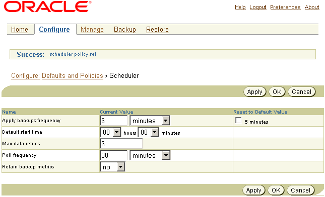

The policy_name page appears. Figure 4-2 shows the Scheduler page.
Change the settings of one or more policies. Refer to the "Defaults and Policies" appendix in Oracle Secure Backup Reference for explanations of the policies.
Choose one of the following:
Click Apply to remain on this page.
Click OK to save the changes and return to the Defaults and Policies page.

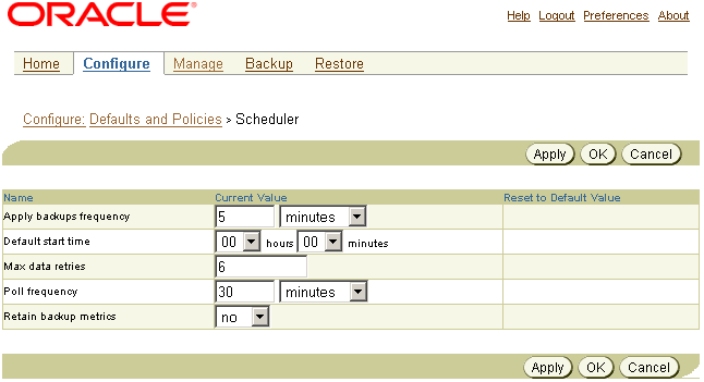

When you change a policy setting from its default, the Web tool displays the default value for the policy in the Reset to Default Value column. Figure 4-2 shows the Scheduler page after the backup frequency has been changed to 6 minutes from the default of 5 minutes.
You can reset the value of a one or more policies to the default value.
To reset a policy:
In the Policy column on the Defaults and Policies page, click the name of the policy class that contains the policy to be reset.
Check box in the Reset to Default Value column for the policy that you are resetting.
Click Apply or OK.

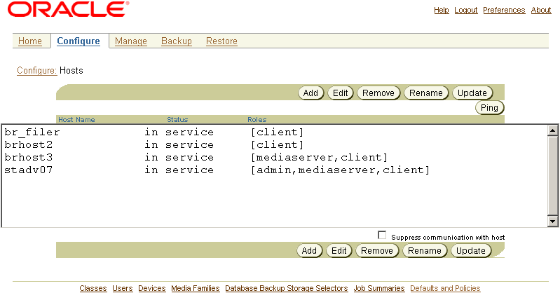

Click Hosts in the Configure page to display the Hosts page, which is shown in Figure 4-4. The Hosts page lists the host name, status, and roles attributed to the host. You can perform all host configuration tasks in this page or in pages to which it is linked.
To add a new host to an administrative domain:
From the Home page, click the Configure tab.
Click Hosts in the Basic section to display the Hosts page.
Click Add to add a host.
The Web tool displays a form for entering a host name.
In the Host box, enter the name of the host.
The name you enter must start with an alphanumeric character. It can contain only letters, numerals, dashes, underscores, or periods. The maximum length of a host name is 127 characters.
The host name must be unique among all Oracle Secure Backup host names.
If you do not configure explicit IP interface names for this host (see the following step), then Oracle Secure Backup considers this host name to be the IP interface name for the host. As such, it must be resolvable through your site's host name resolution system (usually DNS or NIS) to the IP address of a network interface on the host.
In the IP Interface name(s) box, optionally enter one or more IP interface names. Separate multiple entries with a comma.
If you define one or more IP names, then you can specify either resolvable host names or IP addresses. For example, you can use myhost.oracle.com for a host name or 141.146.8.66 for an IP address.
The use of DHCP to assign IP addresses is not supported for hosts that participate in an Oracle Secure Backup administrative domain. You must assign static IP addresses to all hosts. If you cannot use static IP addresses, then ensure that the DHCP server guarantees that a given host is always assigned the same IP address.If this box is not empty, then Oracle Secure Backup never uses the user-assigned host name to get the host's IP address; instead, it considers each name in this IP address field until it finds one that resolves to a working IP address. If preferred network interfaces (PNI) are used, then Oracle Secure Backup considers the PNI address first.
If you leave this box blank, then Oracle Secure Backup uses the name you assigned to the host in the previous step as the resolvable IP name for the host.
In the Status list, select one of the following:
in service
Select this option to indicate that the machine is logically available to perform backup and restore operations.
not in service
Select this option to indicate that the machine is logically unavailable to perform backup and restore operations.
In the Roles list, select one or more administrative domain roles for the host. You can select multiple roles. Your choices are the following:
See "Administrative Domains" to learn about these roles.In the Access method box, select an access method for the host (if applicable). Your choices are the following:
ob
Select this option if the host has Oracle Secure Backup installed.
NDMP
Select this option if the host does not have Oracle Secure Backup installed—for example, a Network-Attached Storage (NAS) device—and uses the Network Data management Protocol (NDMP) to perform all backup and restore operations.
NDMP is an open standard that defines a common architecture for the way heterogeneous file servers on a network are backed up. This protocol permits the creation of a common agent used by the central backup application to back up servers running different operating systems.If you select ob, then perform Step 9 and then jump to Step 16. If you select NDMP, then skip to Step 10 and perform all subsequent steps.
In Public and private key sizes, select a size for the public/private key associated with the identity certificate for this host.
In the NDMP authorization type list, select an authorization type. The authorization type defines the way in which Oracle Secure Backup authenticates itself to the NDMP server. Typically, you should use the default setting.
default
Select this option to use the value of the Authentication type for the NDMP policy.
none
Select this option to attempt to use the NDMP server from Oracle Secure Backup and provide no authentication data. This technique is usually unsuccessful.
Select this option to negotiate with the NDMP server to determine the best authentication mode to use.
Select this option to use plain (unencrypted) text to authenticate.
Select this option to use the MD5 digest algorithm to authenticate.
See Also:
"Configuring Defaults and Policies" to learn about NDMP-related policiesIn the Username box, enter the name used to authenticate Oracle Secure Backup to this NDMP server. If left blank, then the Oracle Secure Backup uses the name in the NDMP policy.
In the Password list, select one of the following options:
Use default password
Select this option to use the default NDMP password.
Use text password
Select this option to enter a password.
Set to NULL
Check this box to use a NULL password.
The password is used to authenticate Oracle Secure Backup to this NDMP server.
In the Backup type box, enter an NDMP backup type. A backup type is the name of a backup method supported by the NDMP Data Service running on a host. Backup types are defined by each Data Service provider.
In the Protocol Version list, select 2, 3, 4, or as proposed by server.
The NDMP protocol has three public versions, called 2, 3, and 4. Typically, it is acceptable to let Oracle Secure Backup choose the protocol version that the server proposes when the connection is established. If necessary (for example, for testing) you can change the NDMP protocol version with which Oracle Secure Backup communicates to this server.
In the Port box, enter a port number. Typically, the TCP port (10000) in the NDMP policy is used. You can specify another port if this server uses a port other than the default.
You can add backup and restore environment variables only after you create the host. Refer to "Adding Backup and Restore Environment Variables to an NDMP Host".Check the Suppress communication with host checkbox if you want to add a host to the administrative domain that is currently not accessible on the network.
You can use the ping operation to determine whether a host is responsive to requests from Oracle Secure Backup.
Ping attempts to establish a TCP connection to the host on each of the IP addresses you have configured for it. For hosts that use primary access mode, connection occurs through TCP port 400; for hosts that use the NDMP access mode, connections occur through the configured NDMP TCP port, usually 10000.
Oracle Secure Backup reports the status of each connection attempt and immediately closes each connection that has been established successfully.
This operation is useful for ensuring that a host is responsive on all of its configured IP addresses.
To ping a host:
From the Hosts page, select a host to ping.
Click Ping.
A status line appears on the page with the results of the operation.

To remove a host:
From the Hosts page, select the name of the host that you want to remove.
Check Suppress communication with host to remove a machine that is not connected to the network.
Click Remove.
Oracle Secure Backup prompts you to confirm the removal of the host.
Click Yes to remove the host or No to leave the host undisturbed.
If you selected Yes, then Oracle Secure Backup removes the host and returns you to the Host page.
In the Hosts page, select the name of the host to rename.
Check Suppress communication with host to rename a machine that is not connected to the network.
Click Rename.
The Web tool displays a message box in which you can enter the new name.
Enter the new name for the host in the text box.
Click Yes to rename the host or No to leave the host name unchanged.
If you select Yes, then Oracle Secure Backup renames the host and returns you to the Host page.

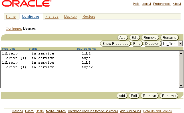

The Devices page, which is shown in Figure 4-5, lists the tape libraries and tape drives that are currently in the administrative domain. The page lists the type, status, and name of every device.
To add a tape device to an administrative domain:
Click Devices in the Basic section to display the Devices page.
You can add new devices in one of two ways:
By automatically discovering them. Oracle Secure Backup can automatically discover and configure secondary storage devices connected to certain types of NDMP servers, such as Network Appliance filers. See "Editing Device Properties" to use automatic device discovery.
By adding them manually. See the next step to define devices that cannot be automatically discovered.
Discovery is a way to learn out about new devices or otherwise unconfigured devices that exist on the host. This technique works only for NDMP devices.Click Add to add a device.

Oracle Secure Backup can detect changes in device configuration for some types of NDMP-accessed hosts and, based on this information, automatically update the administrative domain's device configuration.
Oracle Secure Backup detects and acts on these kinds of changes:
Devices that were not previously configured but have appeared. For each such device, Oracle Secure Backup creates a new device with an internally-assigned name and configures a device attachment for it.
Devices that were previously configured for which a new attachment has appeared. For each, Oracle Secure Backup adds an attachment to the existing device.
Devices that were previously configured for which an attachment has disappeared. For each, Oracle Secure Backup removes the attachment from the device.
Oracle Secure Backup detects multiple hosts connected to the same device by comparing the serial numbers reported by the operating system. Oracle Secure Backup also determines whether any discovered device is accessible by its serial number; if so, it configures each device attachment to reference the serial number instead of any logical name assigned by the operating system.
To discover a device:
In the list of hosts, select the name of an NDMP host.
Click Discover.
The Web tool displays a message in the status area, which can also be a message stating that no changes to device configuration are discovered.
Click OK to return to the Devices page.

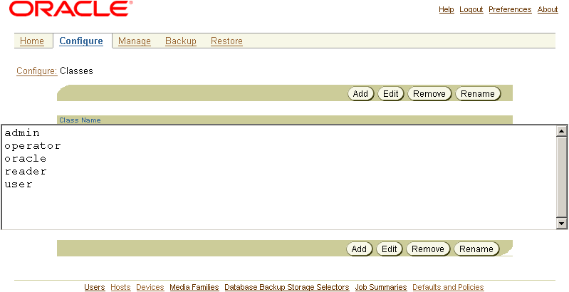

In most cases, the default classes are sufficient. Refer to Oracle Secure Backup Reference for a complete account of the rights that belong to each class.
In the Advanced section of the Configure page, click Classes to display the page shown in Figure 4-6. You can use this page to manage existing classes or configure new classes.
As explained in "Users and Classes", Oracle Secure Backup creates default classes when the administrative domain is first initialized. You can use these classes or create your own.
To add a class:
The New Classes page appears. This page describes class rights options.
In the Class box, enter a name for the class. The name you enter must start with an alphanumeric character. It can contain only letters, numerals, dashes, underscores, or periods. The maximum character length is 127 characters.
The class name is of your choosing. It must be unique among all Oracle Secure Backup class names. It is unrelated to any other name used in your computing environment or the Oracle Secure Backup administrative domain.
Select the rights to grant to this class. Refer to the "Classes and Rights" in Oracle Secure Backup Reference for a detailed explanation of these rights.
Click Apply or OK.
To modify existing classes, you must have the modify administrative domain's configuration right. When you change the class that a user belongs to or modify the rights of such a class, the changes do not take effect until the user exits from the Oracle Secure Backup component that he is currently using.
To edit a class:
In the Class Name box, select the name of the class that you want to edit.
Click Edit.
The Web tool displays a page with details for the class name you selected.
Make any required changes.
Click Apply or OK.
You cannot remove a class to which any users currently belong. Instead, you need to reassign or delete all existing members of a class before the class can be removed.
To remove a class:
In the Class Name box, select the name of the class to be removed.
Click Remove.
A message prompts you to confirm the removal of the class.
Click Yes to remove the class name or No to leave the class undisturbed.
A message appears in Status box telling you whether the class was successfully removed.
In the Class name box, select the name of the class that you want to rename.
Click Rename.
A message prompts you to confirm the renaming of the class.
In the text box, enter the new name for the class.
Click Yes to rename the class name or No to leave the class undisturbed.
A message appears in Status box telling you the result of the operation.
To display the properties for a class:
In the Class Name box, select the name of the class whose properties you want to display.
Click Edit.
Click Cancel to return to the Classes page.

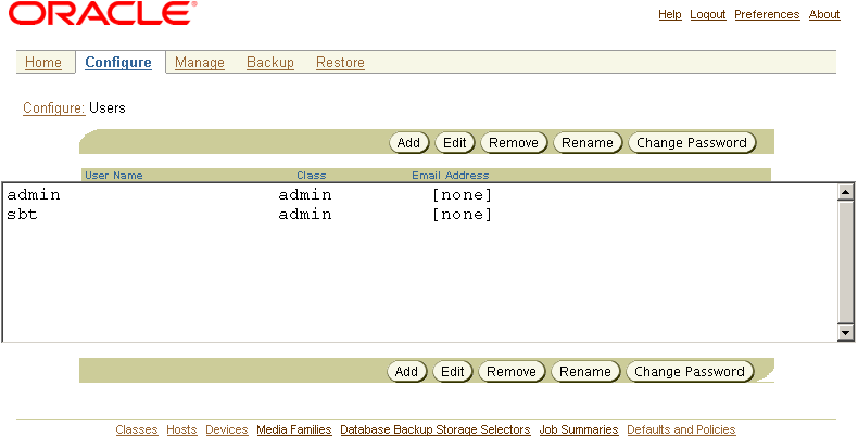

In the Configure page, click Users to display the Users page, which is shown in Figure 4-7. This page lists all users authorized by Oracle Secure Backup along with their class names and email addresses. You can perform all user configuration tasks in this page or in pages to which it provides links.
To add one or more users:
In the Users page, click Add to add a new user.
The Web tool displays the New Users form for entering a user name.
In the User box, enter a user name.
The name you enter must start with an alphanumeric character. It can contain only letters, numerals, dashes, underscores, or periods. The maximum character length that you can enter is 31 characters.
The user name must be unique among all Oracle Secure Backup user names. Formally, it is unrelated to any other name used in your computing environment or the Oracle Secure Backup administrative domain. Practically, it is helpful to choose Oracle Secure Backup user names that are identical to Windows or UNIX user names.
In the Password box, enter a password. This password is used to log in to Oracle Secure Backup. The maximum character length that you can enter is 16 characters.
In the User class list, select a class. A class defines a set of rights.

This section explains how to modify properties for an existing user account.
To modify users, you need to be a member of a class that has this right enabled. See "Oracle Secure Backup Classes and Rights" for details.To edit user properties:
From the Users page, select the name of the user from the User name box.
Click Edit.
The Web tool displays a page with details for the user you selected.
Click Apply, OK, or Cancel.
