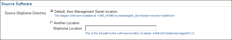

In the Source Software section, select an installation source directory. This directory can either be the default directory that exists within the Oracle Management Service (OMS), for example <OMS_HOME>/sysman/agent_download/10.2.0.2.0/<platform>, or any other location where the software is available.
At the time of downloading the agent installation software, if theagentDownload.rsp file is overwritten, ensure the s_OMSHost and s_OMSPort values are specified correctly in the response file (agentdownload.rsp) before proceeding with the installation steps.See Chapter6, "Downloading 10.2.0.3.0 Agent Installation Software for Different Platforms" for more information on obtaining agent binaries for different platforms.
To choose a location other than the default location from the Management Service, select Another Location, and specify the full path to the software location that you want to use.
Ensure that the path of the software location that you specify is accessible from all remote hosts.The application does not copy the software to the remote hosts, but will only access the software from the specified location.
After you download the agentDownload software, unzip and extract its contents into a new directory. Rename this new <directory>/$<platform>/agent to <directory>/$<platform>/Disk1 and use the <directory>/$<platform> as the source software location.
Caution:
The additional parameters that you specify later in the installation process depend on the source software location that you select here.if you select the default software location, you must specify additional parameters that are supported by the agentDownload script. See Table D-1, "Parameters Supported by agentDownload Script" for a list of parameters supported by this script.
If you select an alternative location, you must specify additional parameters that are supported by Oracle Universal Installer (OUI). See Table D-2, "Parameters Supported by Oracle Universal Installer" for a list of parameters supported by OUI.

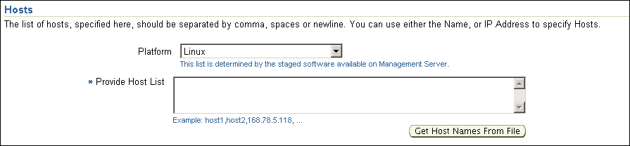

Select the appropriate platform on which you want to perform this installation.
In the Provide Host List text box, specify all the hosts (host names or IP addresses) on which you want to perform the agent installation. Alternatively, click Get Host Names From File to browse and select the file that contains a list of all the required host names.
WARNING:
Ensure you do not specify duplicate entries of the host list. If there are duplicate host entries in this list, the application hangs.
Also ensure that you use the same host names for which the SSH has been set.
You can use either a comma (,) or a new line as a separator when specifying multiple hosts.Caution:
The Agent Deploy application picks up only the values in the first column of the Host List file that you specify/select.Ensure the host list format is appropriate, because the Agent Deploy application does not validate this format on the selected file.
A sample host list format is provided in Table 6-1, "Sample Host List Format".

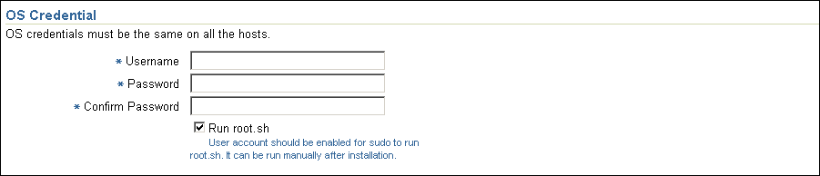

In the OS Credentials section, specify the appropriate operating system user credentials. Select Run root.sh (on UNIX machines only) if you want Agent Deploy to execute this script.
Theroot.sh script executes after the configuration assistants are run, and before executing postinstallation scripts (if any).
If you do not select this option here, you must manually run root.sh on each node.
Agent Deploy uses sudo to run this script. You must specify the invoking user's password here. You must also ensure that the targetpw is not set in the /etc/sudoers file.
The OS credentials that you specify here must be the same for all the selected hosts.In the Destination section, specify the absolute path for the Installation Base Directory. This directory is created on all the specified hosts, and the Agent Oracle home directory is created as a subdirectory under this directory.

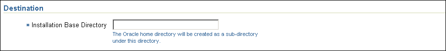

Ensure you have write permissions on the installation Base Directory that you specify.Specify the port on which the Agent will communicate. The default port value for 10.2 Management Agent is 3872.
If the port that you specify is not available, you are prompted to specify an alternative port. If you do not specify a port here, the Agent Deploy application automatically picks up a free port (3872 or in the range of 1830 - 1849).In the Additional Parameters text box, specify any additional parameters that you want to pass during installation.

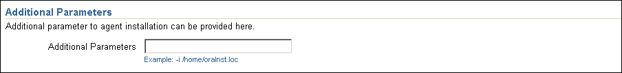

Caution:
The additional parameters that you specify here depend on the software source location that you have selected.Default Management Service Location: If you have selected the default software source directory, the additional parameters that you specify must be supported by the agentDownload script, as the Agent Deploy application uses the agentDownload.<platform> script to perform the installation. See Table D-0, "Additional Parameters Supported by agentDownload Script" for a list of all the parameters supported by the agentDownload script.
Another Location: If you have selected an alternative software location, the additional parameters that you specify must be supported by Oracle Universal Installer (OUI), as Agent Deploy then uses OUI to perform the installation. See Table D-1, "Additional Parameters Supported by Oracle Universal Installer" for a list of parameters supported by OUI.
If the same parameters that you specify here are also specified independently (from the command-line option), the value of the parameters that you specify here take precedence over the other.For example, if the installation base directory is specified independently, and -b option is specified here, the latter value (-b) is used in the installation.
The important parameters for Agent Installation are -b, -c, -n, -z and optionally -i, -p, -t, -d.

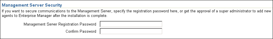

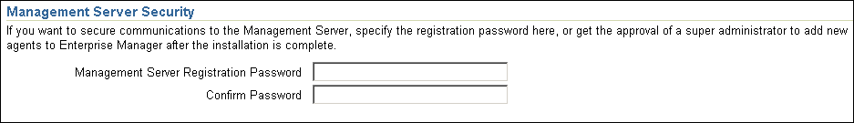

Specify the Management Service Registration Password if you want to secure communications between the agent and Management Service. Alternatively, the super administrator can approve the addition of new agents to Enterprise Manager after the installation is complete.
An unsecure agent cannot upload data to the secure Management Service. Oracle also recommends for security reasons that you change the Management Service password specified here after the installation is complete.In the Additional Scripts section, specify any preinstallation and/or postinstallation scripts that you want to execute.

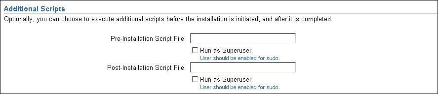

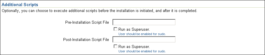

Select Run as Superuser if you want to run these scripts as root.
The preinstallation and/or postinstallation scripts that you specify must be available on all the hosts. These files are not copied onto the hosts from the software source location during installation.Click Continue to start the installation process. As part of this process, Agent Deploy performs some prerequisite checks before proceeding with the installation. When all the prerequisite checks are complete, the application displays the results. You can choose to either retry the prerequisite check on all those failed hosts, or ignore the result and proceed to install the Agent.
After the installation and configuration phase, the Agent Deploy application checks for the existence of the Central Inventory (located at/etc/oraInst.loc). If this is the first Oracle product installation, Agent Deploy executes the following scripts:
orainstRoot.sh - UNIX Machines only: This creates oraInst.loc that contains the central inventory.
root.sh - UNIX Machines only: This runs all the scripts that must be executed as root.
If this is not the first Oracle product installation, Agent Deploy executes only the root.sh script.

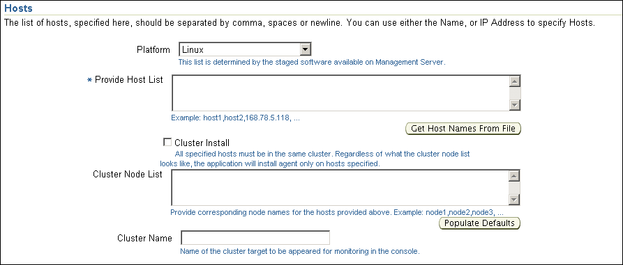

In the Hosts section:
Select the appropriate Platform on which you want to perform this installation.
In the Provide Host List text box, specify all the hosts (host names or IP addresses) on which you want to perform the Agent installation. Alternatively, click Get Host Names From File to select the file that contains a list of all the required host names.
WARNING:
Do not specify duplicate entries of the host list. If there are duplicate host entries in this list, the application hangs.
Use the same host names for which the SSH has been set.
You can use a comma (,) or just white space as a separator when specifying multiple host names.Caution:

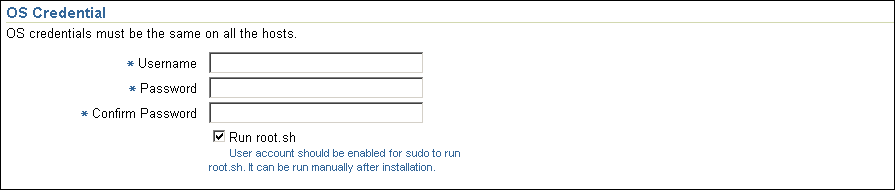

In the OS Credentials section:
Specify the appropriate operating system user credentials.
Select Run root.sh (on UNIX machines only) if you want Agent Deploy to execute this script. Agent Deploy uses sudo to run this script. You must specify the invoking user's password here. You must also ensure that the targetpw parameter is not set in the /etc/sudoers file.
Caution:
If you do not want to execute the scripts as root during the installation, ensure you run these scripts manually before performing any other installation on that machine.Note:
The OS credentials that you specify here must be the same for all the selected hosts.In the Destination section:

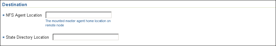

Specify the complete path to the NFS Agent Location. This is the shared directory location on the source agent host that must be visible (NFS-mounted) from all remote hosts.
Specify an appropriate EMState Directory Location. This is a directory for storing configuration files such as emd.properties, targets.xml, log files, and so on, on each host. Every host that shares the agent has its own EMSTATE directory.

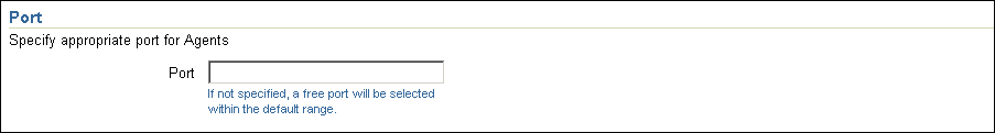

In the Port section, specify the appropriate port on which the agent will communicate. This is a mandatory field.
If the port that you specify is busy (not available), you are prompted to specify an alternative port. If you do not specify a port value here, the installation will fail.In the Additional Parameters section, specify the parameters that you may want to pass during installation. You can specify multiple parameters, separated by a space.
Besides the timezone parameter (-z), you can also specify all the parameters that are supported by the agentDownload script. See AppendixD, "Additional Parameters Supported by agentDownload Script" for more information.In the Management Server Security section:
Specify the Management Service Registration Password if you want to secure communications between the Agent and Management Service. Alternatively, the super administrator can approve the addition of new agents to Enterprise Manager after the installation is complete.
An unsecure agent cannot upload data to the Management Service. Oracle also recommends for security reasons that you change the Management Service password specified here after the installation is complete.In the Additional Scripts section:
Specify any preinstallation and/or postinstallation scripts that you want to execute. These scripts are optional. If you do not want to customize your installation, leave these fields blank and continue.

<EMSTATE Directory location> is the full path where you want the state directory to be created by the script.
<port number> is the port on which the agent runs.
Specifying the <port_number> argument is optional. If you do not specify the port number, the script will automatically select the next available port from that host.Caution:
