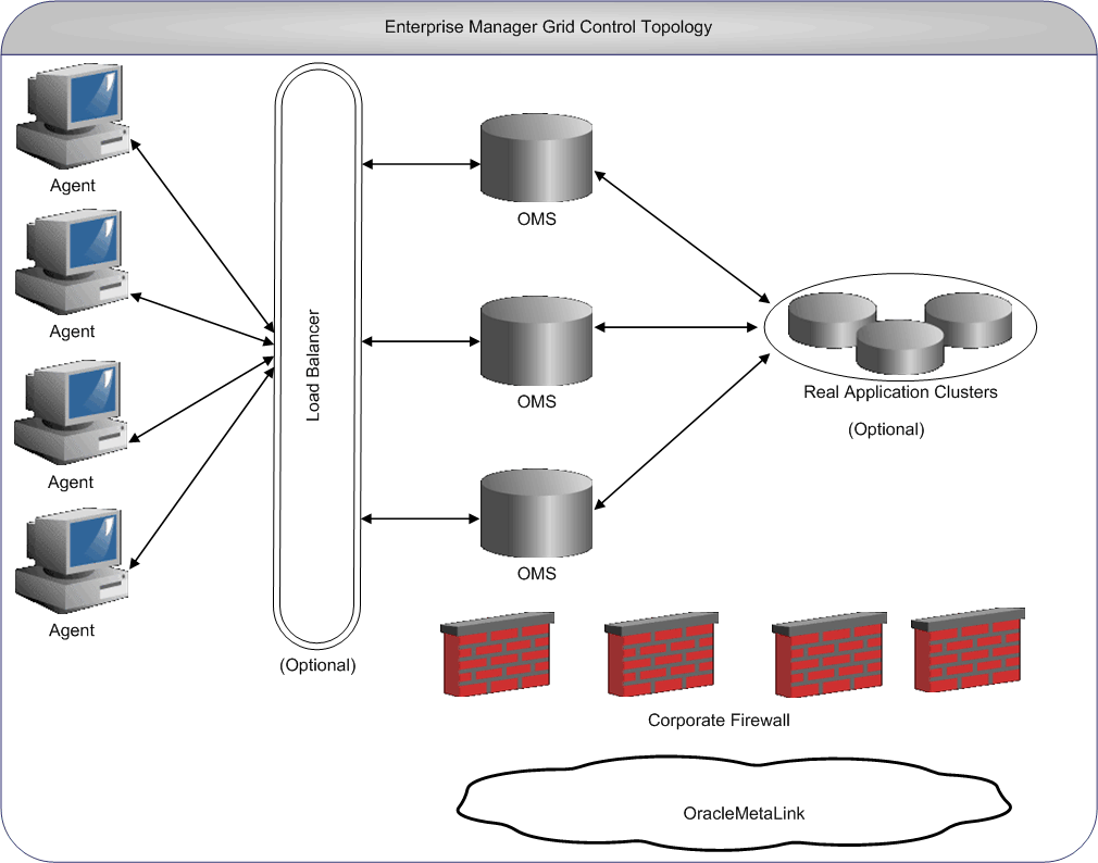

Enterprise Manager is a single, integrated solution for administering and monitoring certified targets. See Chapter1, "Certified Enterprise Manager Targets" for a list of Oracle targets and components that Enterprise Manager can manage.
Oracle Enterprise Manager includes the Management Agent, Management Service (OMS), and Management Repository, as well as the Grid Control console, which is a browser-based central console through which administrators can perform all monitoring, administration, and configuration tasks for the enterprise.
Table 1-1 explains the different Enterprise Manager components and how they work together to manage your enterprise.
Table 1-1 Enterprise Manager Grid Control Components
| Component | Definition |
From the Grid Control console, you can monitor and administer your entire computing environment from one location on the network. All the services within your enterprise, including hosts, databases, listeners, application servers, Oracle Collaboration Suite applications, and Web applications are easily managed from one central location (console). |
The Management Agent is a process that is deployed on each monitored host. It is responsible for monitoring all targets on the host, for communicating that information to the middle-tier Management Service, and for managing and maintaining the host and its targets. |
The Management Service is a J2EE Web application that renders the user interface for the Grid Control console. It works with all Management Agents to process monitoring and jobs information, and uses the Management Repository to store data. |
The Management Repository consists of objects such as database jobs, packages, procedures, views, and two tablespaces in Oracle Database that contain all available information about administrators, targets, and applications managed within Enterprise Manager. The Management Service uploads the monitoring data it receives from the Management Agents to the Management Repository. The Management Repository then organizes the data so that it can be retrieved by the Management Service and displayed in the Grid Control console. Because data is stored in the Management Repository, it can be shared between any number of administrators accessing the Grid Control console. |
