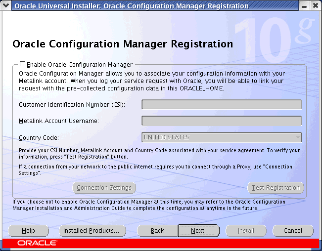

Figure 2-1 Oracle Configuration Manager Registration Screen (Initial Screen)
Click Enable Oracle Configuration Manager to proceed to the Oracle Configuration Manager License Agreement screen. Figure 2-2 is displayed.

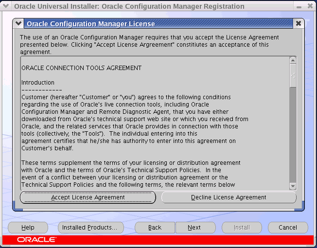

Figure 2-2 Oracle Configuration Manager License Agreement Screen
Click Accept License Agreement to accept the license agreement. Figure 2-3, Oracle Configuration Manager Registration page is displayed.
If you decline the license agreement, click Next on the Oracle Configuration Manager Registration page to complete the installation. Oracle Configuration Manager will be installed but not configured. You can configure Oracle Configuration Manager after installation by running the setupCCR

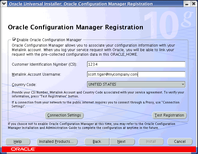

Figure 2-3 Oracle Configuration Manager Registration Screen
To associate the configuration data with your Oracle Metalink Account, specify the Customer Support Identifier (CSI), Metalink Account Username and Country Code that corresponds to the support agreement. If you need to specify the proxy server settings, click Connection Settings to go to Figure 2-4.
Click Test Registration to verify that the registration information is correct and click Next to continue with the installation. You cannot proceed past this page until the credentials have been successfully verified.

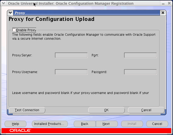

Figure 2-4 Oracle Configuration Manager Proxy Screen
If you are using a proxy server to access the Internet, check Enable Proxy and enter the following proxy server configuration details or click Cancel and then click Next to continue with the installation.
Enter the host name and port number of the proxy server. For example, you can specify the proxy server settings as follows:
Proxy Server: www-fooproxy.here.com
Port: 80
If the proxy server requires authentication, you must specify the credentials in the Proxy Username and Password fields.
After you have entered the proxy server information, click Test Connection to test the connection between your local host and the Oracle Configuration Manager service. When you click Test Connection, the connectivity test is performed and the 'success' or 'failure' dialog is displayed. If the connectivity test fails, an error message is displayed on the screen. Connectivity errors are also logged in the installation log file. You can proceed with the installation only if you have successfully verified the connection. Click OK and then click Next to continue with the installation. The Installation Summary page is displayed.
