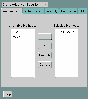

Use Oracle Net Manager to perform the following steps to configure Kerberos authentication service parameters on the client and on the database server (Refer to, "Starting Oracle Net Manager"):
Navigate to the Oracle Advanced Security profile. ( Refer to "Navigating to the Oracle Advanced Security Profile") The Oracle Advanced Security window is displayed (Figure 7-1):
Figure 7-1 Oracle Advanced Security Authentication Window (Kerberos)
Click the Authentication tab.
From the Available Methods list, select KERBEROS5.
Move KERBEROS5 to the Selected Methods list by clicking the right arrow (>).
Arrange the selected methods in order of use. To do this, select a method in the Selected Methods list, then click Promote or Demote to position it in the list. For example, if you want KERBEROS5
to be the first service used, move it to the top of the list.

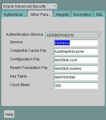

Click the Other Params tab (Figure 7-2).
Figure 7-2 Oracle Advanced Security Other Params Window (Kerberos)
From the Authentication Service list, select KERBEROS(V5).
Type Kerberos into the Service field. This field defines the name of the service Oracle Database uses to obtain a Kerberos service ticket. When you provide the value for this field, the other fields are enabled.
Optionally enter values for the following fields:
Credential Cache File
Configuration File
Realm Translation File
Key Table
Clock Skew
See Also:
Oracle Net Manager online Help, and "Step 3: Set sqlnet.ora Parameters (optional)", for more information about the fields and the parameters they configureSelect File, Save Network Configuration.
The sqlnet.ora
file is updated with the following entries:
SQLNET.AUTHENTICATION_SERVICES=(KERBEROS5) SQLNET.AUTHENTICATION_KERBEROS5_SERVICE=kservice
