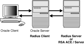

The Oracle/RADIUS environment is displayed in Figure 6-1:
Figure 6-1 RADIUS in an Oracle Environment
Description of Figure 6-1 follows
Description of "Figure 6-1 RADIUS in an Oracle Environment"
The Oracle database server acts as the RADIUS client, passing information between the Oracle client and the RADIUS server. Similarly, the RADIUS server passes information between the Oracle database server and the appropriate authentication servers. The authentication components are listed in Table 6-1:

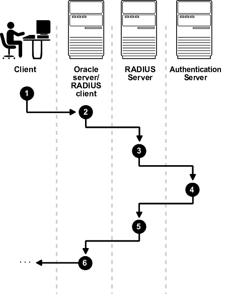

Figure 6-2 Synchronous Authentication Sequence
Description of Figure 6-2 follows
Description of "Figure 6-2 Synchronous Authentication Sequence"
Following steps describe the Synchronous Authentication Sequence:
  1. A user logs in by entering a connect string, pass code, or other value. The client system passes this data to the Oracle database server.
  2. The Oracle database server, acting as the RADIUS client, passes the data from the Oracle client to the RADIUS server.
  3. The RADIUS server passes the data to the appropriate authentication server, such as Smart Card or SecurID ACE for validation.
  4. The authentication server sends either an Access Accept or an Access Reject message back to the RADIUS server.
  5. The RADIUS server passes this response to the Oracle database server/RADIUS client.
  6. The Oracle database server/RADIUS client passes the response back to the Oracle client.

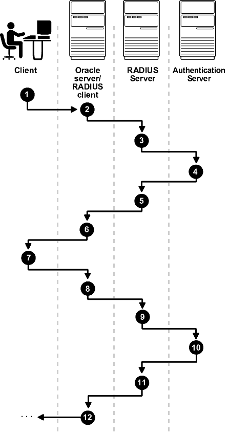

Figure 6-3 Asynchronous Authentication Sequence
Description of Figure 6-3 follows
Description of "Figure 6-3 Asynchronous Authentication Sequence"
Following steps describe the Asynchronous Authentication Sequence:
  1. A user seeks a connection to an Oracle database server. The client system passes the data to the Oracle database server.
  3. The RADIUS server passes the data to the appropriate authentication server, such as a Smart Card, SecurID ACE, or token card server.
  4. The authentication server sends a challenge, such as a random number, to the RADIUS server.
  5. The RADIUS server passes the challenge to the Oracle database server/RADIUS client.
  6. The Oracle database server/RADIUS client, in turn, passes it to the Oracle client. A graphical user interface presents the challenge to the user.
  7. The user provides a response to the challenge. To formulate a response, the user can, for example, enter the received challenge into the token card. The token card provides a dynamic password that is entered into the graphical user interface. The Oracle client passes the user's response to the Oracle database server/RADIUS client.
  8. The Oracle database server/RADIUS client sends the user's response to the RADIUS server.
  9. The RADIUS server passes the user's response to the appropriate authentication server for validation.
  10. The authentication server sends either an Access Accept or an Access Reject message back to the RADIUS server.
  11. The RADIUS server passes the response to the Oracle database server/RADIUS client.
  12. The Oracle database server/RADIUS client passes the response to the Oracle client.

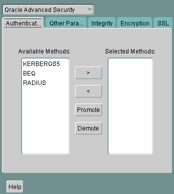

Use Oracle Net Manager to configure RADIUS on the Oracle client (See "Starting Oracle Net Manager"):
  1. Navigate to the Oracle Advanced Security profile (For details, refer to "Navigating to the Oracle Advanced Security Profile") The Oracle Advanced Security tabbed window is displayed (Figure 6-4):
Figure 6-4 Oracle Advanced Security Authentication Window
Description of Figure 6-4 follows
Description of "Figure 6-4 Oracle Advanced Security Authentication Window"
  1. Click the Authentication tab.
  2. From the Available Methods list, select RADIUS.
  3. Select the right-arrow (>) to move RADIUS to the Selected Methods list. Move any other methods you want to use in the same way.
  4. Arrange the selected methods in order of required usage by selecting a method in the Selected Methods list, and clicking Promote or Demote to position it in the list. For example, put RADIUS at the top of the list for it to be the first service used.
  5. Select File, Save Network Configuration.
    The sqlnet.ora file is updated with the following entry:
    SQLNET.AUTHENTICATION_SERVICES=(RADIUS)

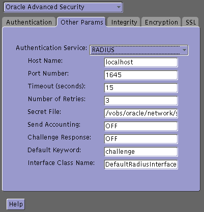

  6. Click Other Params as shown in (Figure 6-5):
Figure 6-5 Oracle Advanced Security Other Params Window
Description of Figure 6-5 follows
Description of "Figure 6-5 Oracle Advanced Security Other Params Window"
  1. From the Authentication Service list, select RADIUS.
  2. In the Host Name field, accept the localhost as the default primary RADIUS server, or enter another host name.
  3. Ensure that the default value of the Secret File field is valid.
  4. Select File, Save Network Configuration.
    The sqlnet.ora file is updated with the following entries:
    SQLNET.AUTHENTICATION_SERVICES=RADIUS
    SQLNET.RADIUS_AUTHENTICATION=RADIUS_server_{hostname|IP_address}

  4. Change the default setting for any of the following fields:
    Field Description
    Port Number Specifies the listening port of the primary RADIUS server. The default value is 1645.
    Timeout (seconds) Specifies the time the Oracle database server waits for a response from the primary RADIUS server. The default is 15 seconds.
    Number of Retries Specifies the number of times the Oracle database server resends messages to the primary RADIUS server. The default is three retries.
    For instructions on configuring RADIUS accounting, see: Task 5: Configure RADIUS Accounting.
    Secret File Specifies the location of the secret key on the Oracle database server. The field specifies the location of the secret key file, not the secret key itself.
    For information about specifying the secret key, see: Create the RADIUS Secret Key File on the Oracle Database Server.
    SQLNET.RADIUS_AUTHENTICATION_PORT=(PORT)
    SQLNET.RADIUS_AUTHENTICATION_TIMEOUT= (NUMBER OF SECONDS TO WAIT FOR response)
    SQLNET.RADIUS_AUTHENTICATION_RETRIES= (NUMBER OF TIMES TO RE-SEND TO RADIUS server)
    SQLNET.RADIUS_SECRET=(path/radius.key)

  1. Navigate to the Oracle Advanced Security profile in Oracle Net Manager (See "Navigating to the Oracle Advanced Security Profile") The Oracle Advanced Security Other Params window is displayed. (Figure 6-5).
  2. From the Authentication Service list, select RADIUS.
  3. In the Challenge Response field, enter ON to enable challenge-response.
  4. In the Default Keyword field, accept the default value of the challenge or enter a keyword for requesting a challenge from the RADIUS server.
    The keyword feature is provided by Oracle and supported by some, but not all, RADIUS servers. You can use this feature only if your RADIUS server supports it.
    By setting a keyword, you let the user avoid using a password to verify identity. If the user does not enter a password, the keyword you set here is passed to the RADIUS server which responds with a challenge requesting, for example, a driver's license number or birth date. If the user does enter a password, the RADIUS server may or may not respond with a challenge, depending upon the configuration of the RADIUS server.
  1. In the Interface Class Name field, accept the default value of DefaultRadiusInterface or enter the name of the class you have created to handle the challenge-response conversation. If other than the default RADIUS interface is used, you also must edit the sqlnet.ora file to enter SQLNET.RADIUS_CLASSPATH=(location), where location is the complete path name of the jar file. It defaults to $ORACLE_HOME/network/jlib/netradius.jar: $ORACLE_HOME/JRE/lib/vt.jar
  2. Select File, Save Network Configuration.
    SQLNET.RADIUS_CHALLENGE_RESPONSE=([ON | OFF])
    SQLNET.RADIUS_CHALLENGE_KEYWORD=(KEYWORD)
    SQLNET.RADIUS_AUTHENTICATION_INTERFACE=(name of interface including the package name delimited by "/" for ".")
