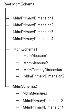

The metadata objects that are accessible through an MdmMetadataProvider
are organized in a tree-like structure, with the root MdmSchema
at the top. Under the root MdmSchema
are MdmPrimaryDimension
objects and one or more MdmSchema
objects, which are referred to as subschemas. In addition, if an MdmMeasure
object does not belong to any subschema, then it is included under the root.
Subschemas have their own MdmMeasure
and MdmPrimaryDimension
objects. Optionally, they can have their own subschemas as well.
The root MdmSchema
contains all of the MdmPrimaryDimension
objects that are in the subschemas. Therefore, an MdmPrimaryDimension
typically appears twice in the tree. It appears once under the root MdmSchema
and again under the subschema. If an MdmPrimaryDimension
does not belong to a subschema, then it is listed only under the root.
The starting point for discovering the available metadata objects is the root MdmSchema
, which is the top of the tree. The following diagram illustrates an MdmSchema
that has two subschemas and four MdmPrimaryDimension
objects.
