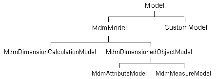

This topic describes the Model
interface and the implementations of it, and the relationship of Model
and Source
objects. It also presents examples of creating custom Model
objects and performing other tasks that involve Source
and Model
objects.
A Model
is analogous to the Oracle SQL MODEL
clause. With a Model
you can assign a value to the Source
for a dimensioned object for one or more sets of members of the dimensions of the object. The value that the Model
assigns can be anything from a simple constant to the result of a complex calculation involving several other Source
objects with nested Model
objects.
The value that a Model

Figure 5-1 illustrates the class hierarchy of the Model
interface and the classes that implement it. The oracle.olapi.metadata.mdm.MdmModel
class implements the Model
interface for MdmObject
objects. Another implementation of the Model
interface is the CustomModel
class in the oracle.olapi.data.source
package.
Figure 5-1 The Model Interface and Implementations
