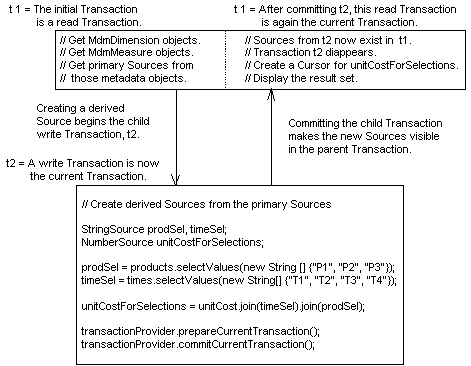

Before you can create a Cursor
to fetch the result set specified by a derived Source
, you must move the Source
from the child write Transaction
into the parent read Transaction
. To do so, you prepare and commit the Transaction
To move a Source
that you created in a child Transaction
, call the prepareCurrentTransaction
and commitCurrentTransaction
methods of the TransactionProvider
. When you commit a child write Transaction
, a Source
you created in the child Transaction
moves into the parent read Transaction
. The child Transaction
disappears and the parent Transaction
becomes the current Transaction
. The Source
is active in the current read Transaction
and you can therefore create a Cursor
for it.
The following figure illustrates the process of moving a Source
created in a child write Transaction
into its parent read Transaction
Figure 7-1 Committing a Write Transaction into Its Parent Read Transaction

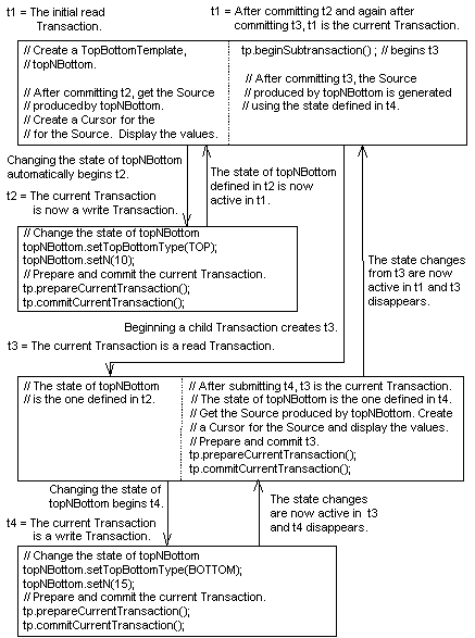

To begin a child read Transaction
, call the beginSubtransaction
method of the TransactionProvider
you are using. In the child read Transaction
, if you change the state of a Template
, then a child write Transaction
begins automatically. The write Transaction
is a child of the child read Transaction
To get the data specified by the Source
produced by the Template
, you prepare and commit the write Transaction
. You can then create a Cursor
to fetch the data. The changed state of the Template
is not visible in the original parent. The changed state does not become visible in the parent until you prepare and commit the child read Transaction
The following figure illustrates beginning a child read Transaction
, creating Source
objects in a write Transaction
, and committing the write Transaction
. The figure then shows committing the child read Transaction
. In the figure, tp
is the TransactionProvider
Figure 7-2 Committing a Child Read Transaction into Its Parent Transaction
After beginning a child read Transaction
, you can begin a child read Transaction
of that child, or a grandchild of the initial parent Transaction
. For an example of creating child and grandchild Transaction
objects, see Example 7-2.

Example 7-2 Using Child Transaction Objects
// The parent Transaction is the current Transaction at this point. // Save the parent read Transaction as parentT1. Transaction parentT1 = tp.getCurrentTransaction(); // Get the dynamic Source produced by the TopBottomTemplate. Source result = topNBottom.getSource(); // Create a Cursor and display the results. println("\nThe current state of the TopBottomTemplate" + "\nproduces the following values:\n"); getContext().displayTopBottomResult(result); // Begin a child Transaction of parentT1. tp.beginSubtransaction(); // This is a read Transaction. // Save the child read Transaction as childT2. Transaction childT2 = tp.getCurrentTransaction(); // Change the state of the TopBottomTemplate. This starts a // write Transaction, a child of the read Transaction childT2. topNBottom.setN(12); topNBottom.setTopBottomType(TopBottomTemplate.TOP_BOTTOM_TYPE_BOTTOM); // Save the child write Transaction as writeT3. Transaction writeT3 = tp.getCurrentTransaction(); // Prepare and commit the write Transaction writeT3. prepareAndCommit(); // The commit moves the changes made in writeT3 into its parent, // the read Transaction childT2. The writeT3 Transaction // disappears. The current Transaction is now childT2 // again but the state of the TopBottomTemplate has changed. // Create a Cursor and display the results of the changes to the // TopBottomTemplate that are visible in childT2. try { println("\nIn the child Transaction, the state of the" + "\nTopBottomTemplate produces the following values:\n"); getContext().displayTopBottomResult(result); } catch(Exception e) { println("Cannot display the results of the query. " + e); } // Begin a grandchild Transaction of the initial parent. tp.beginSubtransaction(); // This is a read Transaction. // Save the grandchild read Transaction as grandchildT4. Transaction grandchildT4 = tp.getCurrentTransaction(); // Change the state of the TopBottomTemplate. This starts another // write Transaction, a child of grandchildT4. topNBottom.setTopBottomType(TopBottomTemplate.TOP_BOTTOM_TYPE_TOP); // Save the write Transaction as writeT5. Transaction writeT5 = tp.getCurrentTransaction(); // Prepare and commit writeT5. prepareAndCommit() // Transaction grandchildT4 is now the current Transaction and the // changes made to the TopBottomTemplate state are visible. // Create a Cursor and display the results visible in grandchildT4. try { println("\nIn the grandchild Transaction, the state of the" + "\nTopBottomTemplate produces the following values:\n"); getContext().displayTopBottomResult(result); } catch(Exception e) { println(""Cannot display the results of the query. " + e); } // Commit the grandchild into the child. prepareAndCommit() // Transaction childT2 is now the current Transaction. // Instead of preparing and committing the grandchild Transaction, // you could rollback the Transaction, as in the following // method call: // rollbackCurrentTransaction(); // If you roll back the grandchild Transaction, then the changes // you made to the TopBottomTemplate state in the grandchild // are discarded and childT2 is the current Transaction. // Commit the child into the parent. prepareAndCommit() // Transaction parentT1 is now the current Transaction. Again, // you can roll back the childT2 Transaction instead of // preparing and committing it. If you do so, then the changes // you made in childT2 are discarded. The current Transaction // is be parentT1, which has the original state of // the TopBottomTemplate, without any of the changes made in // the grandchild or the child transactions.
Example 7-2 produces the following output.
The current state of the TopBottomTemplate produces the following values: 1. PRODUCT_PRIMARY_AW::TOTAL_PRODUCT::1 2. PRODUCT_PRIMARY_AW::CLASS_AW::3 3. PRODUCT_PRIMARY_AW::FAMILY_AW::7 4. PRODUCT_PRIMARY_AW::CLASS_AW::2 5. PRODUCT_PRIMARY_AW::FAMILY_AW::9 6. PRODUCT_PRIMARY_AW::FAMILY_AW::6 7. PRODUCT_PRIMARY_AW::FAMILY_AW::11 8. PRODUCT_PRIMARY_AW::ITEM_AW::30 9. PRODUCT_PRIMARY_AW::ITEM_AW::28 10. PRODUCT_PRIMARY_AW::ITEM_AW::47 In the child Transaction, the state of the TopBottomTemplate produces the following values: 1. PRODUCT_PRIMARY_AW::ITEM_AW::36 2. PRODUCT_PRIMARY_AW::ITEM_AW::43 3. PRODUCT_PRIMARY_AW::ITEM_AW::44 4. PRODUCT_PRIMARY_AW::ITEM_AW::38 5. PRODUCT_PRIMARY_AW::ITEM_AW::22 6. PRODUCT_PRIMARY_AW::ITEM_AW::21 7. PRODUCT_PRIMARY_AW::ITEM_AW::42 8. PRODUCT_PRIMARY_AW::ITEM_AW::41 9. PRODUCT_PRIMARY_AW::ITEM_AW::15 10. PRODUCT_PRIMARY_AW::ITEM_AW::34 11. PRODUCT_PRIMARY_AW::ITEM_AW::14 12. PRODUCT_PRIMARY_AW::ITEM_AW::45 In the grandchild Transaction, the state of the TopBottomTemplate produces the following values: 1. PRODUCT_PRIMARY_AW::TOTAL_PRODUCT::1 2. PRODUCT_PRIMARY_AW::CLASS_AW::3 3. PRODUCT_PRIMARY_AW::FAMILY_AW::7 4. PRODUCT_PRIMARY_AW::CLASS_AW::2 5. PRODUCT_PRIMARY_AW::FAMILY_AW::9 6. PRODUCT_PRIMARY_AW::FAMILY_AW::6 7. PRODUCT_PRIMARY_AW::FAMILY_AW::11 8. PRODUCT_PRIMARY_AW::ITEM_AW::30 9. PRODUCT_PRIMARY_AW::ITEM_AW::28 10. PRODUCT_PRIMARY_AW::ITEM_AW::47 11. PRODUCT_PRIMARY_AW::ITEM_AW::19 12. PRODUCT_PRIMARY_AW::ITEM_AW::24
