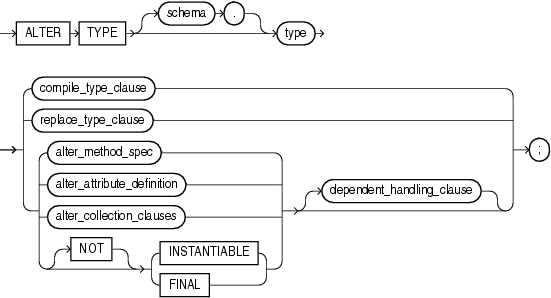

Use the ALTER
TYPE
statement to add or drop member attributes or methods. You can change the existing properties (FINAL
or INSTANTIABLE
) of an object type, and you can modify the scalar attributes of the type.
You can also use this statement to recompile the specification or body of the type or to change the specification of an object type by adding new object member subprogram specifications.
The object type must be in your own schema and you must have CREATE
TYPE
or CREATE
ANY
TYPE
system privilege, or you must have ALTER
ANY
TYPE
system privileges.
(compile_type_clause ::=, replace_type_clause ::=, alter_method_spec ::=, alter_attribute_definition::=, alter_collection_clauses::=, dependent_handling_clause ::=)
element_spec ::=
(inheritance_clauses::=, subprogram_spec::=, constructor_spec::=, map_order_function_spec::=, pragma_clause ::=)
(procedure_spec::=, function_spec::=)
pragma_clause ::=
(map_order_function_spec::=, subprogram_spec::=)

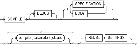

Specify COMPILE
to compile the object type specification and body. This is the default if neither SPECIFICATION
nor BODY
is specified.
During recompilation, Oracle Database drops all persistent compiler switch settings, retrieves them again from the session, and stores them at the end of compilation. To avoid this process, specify the REUSE
SETTINGS
clause.
If recompiling the type results in compilation errors, then the database returns an error and the type remains invalid. You can see the associated compiler error messages with the SQL*Plus command SHOW
ERRORS
Specify DEBUG
to instruct the PL/SQL compiler to generate and store the code for use by the PL/SQL debugger. Specifying this clause has the same effect as specifying PLSQL_DEBUG
= TRUE
in the compiler_parameters_clause
Specify SPECIFICATION
to compile only the object type specification.
Specify BODY
to compile only the object type body.
This clause has the same behavior for a type as it does for a function. Please refer to the ALTER
FUNCTION
compiler_parameters_clause.
FUNCTION
clause REUSE SETTINGS.

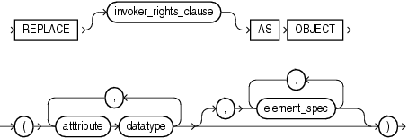

The REPLACE
clause lets you add new member subprogram specifications. This clause is valid only for object types, not for nested tables or varrays.
Specify an object attribute name. Attributes are data items with a name and a type specifier that form the structure of the object.
Specify the elements of the redefined object.

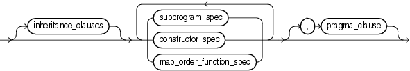

inheritance_clauses The inheritance_clauses
have the same semantics in CREATE
TYPE
and ALTER
TYPE
statements. Please refer to inheritance_clauses in the documentation on CREATE
TYPE
subprogram_spec The
MEMBER
and STATIC
clauses let you specify for the object type a function or procedure subprogram which is referenced as an attribute.
You must specify a corresponding method body in the object type body for each procedure or function specification.
See Also:
CREATE TYPE for a description of the difference between member and static methods, and for examples
PL/SQL User's Guide and Reference for information about overloading subprogram names within a package
procedure_spec Enter the specification of a procedure subprogram.
function_spec Enter the specification of a function subprogram.

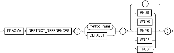

pragma_clause The pragma_clause
is a compiler directive that denies member functions read/write access to database tables, packaged variables, or both, and thereby helps to avoid side effects.
Oracle recommends that you avoid using this clause unless you must do so for backward compatibility of your applications. This clause has been deprecated. Oracle Database now runs purity checks at run time. If you must use this clause for backward compatibility of your applications, you can find its description in pragma_clause (under CREATE
TYPE
Restriction on Pragmas The pragma_clause
is not valid when dropping a method.

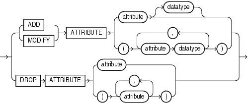

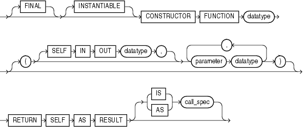

The alter_attribute_definition
clause lets you add, drop, or modify an attribute of an object type. In one ALTER
TYPE
statement, you can add, drop, or modify multiple member attributes or methods, but you can reference each attribute or method only once.
ADD ATTRIBUTE The name of the new attribute must not conflict with existing attributes or methods in the type hierarchy. Oracle Database adds the new attribute to the end of the locally defined attribute list.
If you add the attribute to a supertype, then it is inherited by all of its subtypes. In subtypes, inherited attributes always precede declared attributes. Therefore, you may need to update the mappings of the implicitly altered subtypes after adding an attribute to a supertype.
See Also:
"Adding a Collection Attribute: Example"DROP ATTRIBUTE When you drop an attribute from a type, Oracle Database drops the column corresponding to the dropped attribute as well as any indexes, statistics, and constraints referencing the dropped attribute.
You need not specify the datatype of the attribute you are dropping.
Restrictions on Dropping Type Attributes Dropping type attributes is subject to the following restrictions:
You cannot drop an attribute inherited from a supertype. Instead you must drop the attribute from the supertype.
You cannot drop an attribute that is part of a partitioning, subpartitioning, or cluster key.
You cannot drop an attribute of a primary-key-based object identifier of an object table or a primary key of an index-organized table.
You cannot drop all of the attributes of a root type. Instead you must drop the type. However, you can drop all of the locally declared attributes of a subtype.
MODIFY ATTRIBUTE This clause lets you modify the datatype of an existing scalar attribute. For example, you can increase the length of a VARCHAR2
or RAW
attribute, or you can increase the precision or scale of a numeric attribute.
Restriction on Modifying Attributes You cannot expand the size of an attribute referenced in a function-based index, domain index, or cluster key.

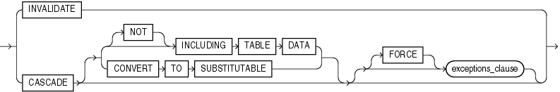

Use this clause to indicate whether any further subtypes can be created for this type:
Specify FINAL
if no further subtypes can be created for this type.
Specify NOT
FINAL
if further subtypes can be created under this type.
If you change the property between FINAL
and NOT
FINAL
, then you must specify the CASCADE
clause of the dependent_handling_clause to convert data in dependent columns and tables.
If you change a type from NOT
FINAL
to FINAL
, then you must specify CASCADE
[INCLUDING
TABLE
DATA
]. You cannot defer data conversion with CASCADE
NOT
INCLUDING
TABLE
DATA
If you change a type from FINAL
to NOT
FINAL
Specify CASCADE
INCLUDING
TABLE
DATA
if you want to create new substitutable tables and columns of that type, but you are not concerned about the substitutability of the existing dependent tables and columns. Oracle Database marks all existing dependent columns and tables NOT
SUBSTITUTABLE
AT
ALL
LEVELS
, so you cannot insert the new subtype instances of the altered type into these existing columns and tables.
Specify CASCADE
CONVERT
TO
SUBSTITUTABLE
if you want to create new substitutable tables and columns of the type and also store new subtype instances of the altered type in existing dependent tables and columns. Oracle Database marks all existing dependent columns and tables SUBSTITUTABLE
AT
ALL
LEVELS
except those that are explicitly marked NOT
SUBSTITUTABLE
AT
ALL
LEVELS
See Also:
Oracle Database Application Developer's Guide - Object-Relational Features for a full discussion of object type evolutionRestriction on FINAL You cannot change a user-defined type from NOT

The dependent_handling_clause
lets you instruct Oracle Database how to handle objects that are dependent on the modified type. If you omit this clause, then the ALTER
TYPE
statement will abort if type
has any dependent type or table.
Specify INVALIDATE
to invalidate all dependent objects without any checking mechanism.
Oracle Database does not validate the type change, so you should use this clause with caution. For example, if you drop an attribute that is a partitioning or cluster key, then you will be unable to write to the table.Specify the CASCADE
clause if you want to propagate the type change to dependent types and tables. Oracle Database aborts the statement if any errors are found in the dependent types or tables unless you also specify FORCE
If you change the property of the type between FINAL
and NOT
FINAL
, you must specify this clause to convert data in dependent columns and tables. Please refer to [NOT] FINAL.
