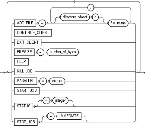

Interactive-Command Interface: Stops logging to the terminal and displays the Export prompt, from which you can enter various commands, some of which are specific to interactive-command mode. This mode is enabled by pressing Ctrl+C during an export operation started with the command-line interface or the parameter file interface. Interactive-command mode is also enabled when you attach to an executing or stopped job.
For a complete description of the commands available in interactive-command mode, see Commands Available in Export's Interactive-Command Mode.

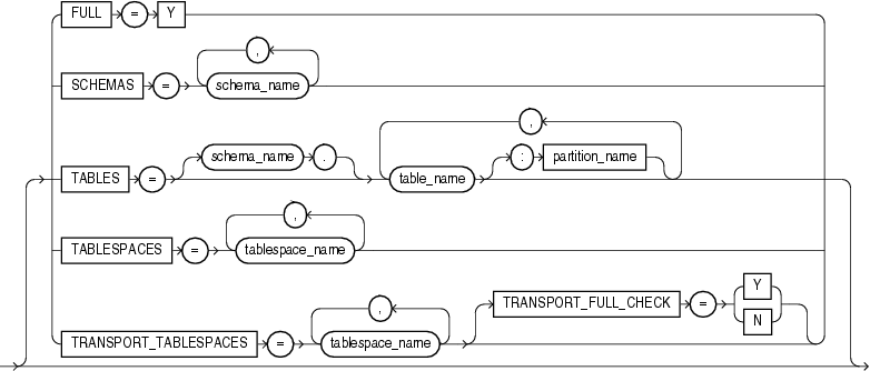

One of the most significant characteristics of an export operation is its mode, because the mode largely determines what is exported. Export provides different modes for unloading different portions of the database. The mode is specified on the command line, using the appropriate parameter. The available modes are as follows:
A full export is specified using the FULL parameter. In a full database export, the entire database is unloaded. This mode requires that you have the EXP_FULL_DATABASE role.
A schema export is specified using the SCHEMAS parameter. This is the default export mode. If you have the EXP_FULL_DATABASE role, then you can specify a list of schemas and optionally include the schema definitions themselves, as well as system privilege grants to those schemas. If you do not have the EXP_FULL_DATABASE role, you can export only your own schema.
Cross-schema references are not exported unless the referenced schema is also specified in the list of schemas to be exported. For example, a trigger defined on a table within one of the specified schemas, but that resides in a schema not explicitly specified, is not exported. This is also true for external type definitions upon which tables in the specified schemas depend. In such a case, it is expected that the type definitions already exist in the target instance at import time.
A table export is specified using the TABLES parameter. In table mode, only a specified set of tables, partitions, and their dependent objects are unloaded. You must have the EXP_FULL_DATABASE role to specify tables that are not in your own schema. All specified tables must reside in a single schema. Note that type definitions for columns are not exported in table mode. It is expected that the type definitions already exist in the target instance at import time. Also, as in schema exports, cross-schema references are not exported.
A tablespace export is specified using the TABLESPACES parameter. In tablespace mode, only the tables contained in a specified set of tablespaces are unloaded. If a table is unloaded, its dependent objects are also unloaded. Both object metadata and data are unloaded. In tablespace mode, if any part of a table resides in the specified set, then that table and all of its dependent objects are exported. Privileged users get all tables. Nonprivileged users get only the tables in their own schemas.
See Also:
A transportable tablespace export is specified using the TRANSPORT_TABLESPACES parameter. In transportable tablespace mode, only the metadata for the tables (and their dependent objects) within a specified set of tablespaces are unloaded. This allows the tablespace datafiles to then be copied to another Oracle database and incorporated using transportable tablespace import. This mode requires that you have the EXP_FULL_DATABASE role.
Unlike tablespace mode, transportable tablespace mode requires that the specified tables be completely self-contained. That is, the partitions of all tables in the set must also be in the set.
Transportable tablespace exports cannot be restarted once stopped. Also, they cannot have a degree of parallelism greater than 1.
Note: You cannot export transportable tablespaces and then import them into a database at a lower release level. The target database must be at the same or higher release level as the source database. |

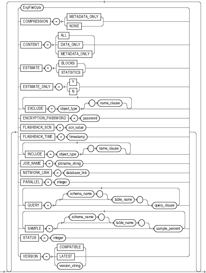

This section provides descriptions of the parameters available in the command-line mode of Data Pump Export. Many of the descriptions include an example of how to use the parameter.
Using the Export Parameter Examples
If you try running the examples that are provided for each parameter, be aware of the following requirements:
Most of the examples use the sample schemas of the seed database, which is installed by default when you install Oracle Database. In particular, the human resources (hr) schema is often used.
The examples assume that the directory objects, dpump_dir1 and dpump_dir2, already exist and that READ and WRITE privileges have been granted to the hr schema for these directory objects. See Default Locations for Dump, Log, and SQL Files for information about creating directory objects and assigning privileges to them.
Some of the examples require the EXP_FULL_DATABASE and IMP_FULL_DATABASE roles. The examples assume that the hr schema has been granted these roles.
If necessary, ask your DBA for help in creating these directory objects and assigning the necessary privileges and roles.
Syntax diagrams of these parameters are provided in Syntax Diagrams for Data Pump Export.
Unless specifically noted, these parameters can also be specified in a parameter file.

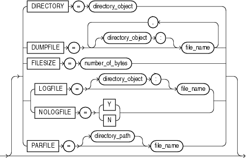

Default: DATA_PUMP_DIR
Purpose
Specifies the default location to which Export can write the dump file set and the log file.
Syntax and Description
DIRECTORY=directory_object
The directory_object is the name of a database directory object (not the name of an actual directory). Upon installation, privileged users have access to a default directory object named DATA_PUMP_DIR. Users with access to DATA_PUMP_DIR need not use the DIRECTORY parameter at all.
A directory object specified on the DUMPFILE or LOGFILE parameter overrides any directory object that you specify for the DIRECTORY parameter.
Example 1
The following is an example of using the DIRECTORY parameter:
> expdp hr/hr DIRECTORY=dpump_dir1 DUMPFILE=employees.dmp CONTENT=METADATA_ONLY
The dump file, employees.dmp, will be written to the path that is associated with the directory object dpump_dir1.
See Also:
Default: expdat.dmp
Purpose
Specifies the names, and optionally, the directory objects of dump files for an export job.
DUMPFILE=[directory_object:]file_name [, ...]
The directory_object is optional if one has already been established by the DIRECTORY parameter. If you supply a value here, it must be a directory object that already exists and that you have access to. A database directory object that is specified as part of the DUMPFILE parameter overrides a value specified by the DIRECTORY parameter or by the default directory object.
You can supply multiple file_name specifications as a comma-delimited list or in separate DUMPFILE parameter specifications. If no extension is given for the filename, then Export uses the default file extension of .dmp. The filenames can contain a substitution variable (%U), which implies that multiple files may be generated. The substitution variable is expanded in the resulting filenames into a 2-digit, fixed-width, incrementing integer starting at 01 and ending at 99. If a file specification contains two substitution variables, both are incremented at the same time. For example, exp%Uaa%U.dmp would resolve to exp01aa01.dmp, exp02aa02.dmp, and so forth.
If the FILESIZE parameter is specified, each dump file will have a maximum of that size in bytes and be nonextensible. If more space is required for the dump file set and a template with a substitution variable (%U) was supplied, a new dump file is automatically created of the size specified by FILESIZE, if there is room on the device.
As each file specification or file template containing a substitution variable is defined, it is instantiated into one fully qualified filename and Export attempts to create it. The file specifications are processed in the order in which they are specified. If the job needs extra files because the maximum file size is reached, or to keep parallel workers active, then additional files are created if file templates with substitution variables were specified.
Although it is possible to specify multiple files using the DUMPFILE parameter, the export job may only require a subset of those files to hold the exported data. The dump file set displayed at the end of the export job shows exactly which files were used. It is this list of files that is required in order to perform an import operation using this dump file set.
Restrictions
If there are preexisting files that match the resulting filenames, an error is generated. The existing dump files will not be overwritten.
Example
The following is an example of using the DUMPFILE parameter:
> expdp hr/hr SCHEMAS=hr DIRECTORY=dpump_dir1 DUMPFILE=dpump_dir2:exp1.dmp, exp2%U.dmp PARALLEL=3
The dump file, exp1.dmp, will be written to the path associated with the directory object dpump_dir2 because dpump_dir2 was specified as part of the dump file name, and therefore overrides the directory object specified with the DIRECTORY parameter. Because all three parallel processes will be given work to perform during this job, the exp201.dmp and exp202.dmp dump files will be created and they will be written to the path associated with the directory object, dpump_dir1, that was specified with the DIRECTORY parameter.

Purpose
Specifies that you want to perform a schema-mode export. This is the default mode for Export.
SCHEMAS=schema_name [, ...]
If you have the EXP_FULL_DATABASE role, then you can specify a single schema other than your own or a list of schema names. The EXP_FULL_DATABASE role also allows you to export additional nonschema object information for each specified schema so that the schemas can be re-created at import time. This additional information includes the user definitions themselves and all associated system and role grants, user password history, and so on. Filtering can further restrict what is exported using schema mode (see Filtering During Export Operations).
Restrictions
If you do not have the EXP_FULL_DATABASE role, then you can specify only your own schema.
Example
The following is an example of using the SCHEMAS parameter. Note that user hr is allowed to specify more than one schema because the EXP_FULL_DATABASE role was previously assigned to it for the purpose of these examples.
> expdp hr/hr DIRECTORY=dpump_dir1 DUMPFILE=expdat.dmp SCHEMAS=hr,sh,oe
This results in a schema-mode export in which the schemas, hr, sh, and oe will be written to the expdat.dmp dump file located in the dpump_dir1 directory.

Default: none
Purpose
Specifies that you want to perform a table-mode export.
TABLES=[schema_name.]table_name[:partition_name] [, ...]
Filtering can restrict what is exported using this mode (see Filtering During Export Operations). You can filter the data and metadata that is exported, by specifying a comma-delimited list of tables and partitions or subpartitions. If a partition name is specified, it must be the name of a partition or subpartition in the associated table. Only the specified set of tables, partitions, and their dependent objects are unloaded.
The table name that you specify can be preceded by a qualifying schema name. All table names specified must reside in the same schema. The schema defaults to that of the current user. To specify a schema other than your own, you must have the EXP_FULL_DATABASE role.
The use of wildcards is supported for one table name per export operation. For example, TABLES=emp% would export all tables having names that start with 'EMP'.
Restrictions
Cross-schema references are not exported. For example, a trigger defined on a table within one of the specified schemas, but that resides in a schema not explicitly specified, is not exported.
Types used by the table are not exported in table mode. This means that if you subsequently import the dump file and the TYPE does not already exist in the destination database, the table creation will fail.
The use of synonyms as values for the TABLES parameter is not supported. For example, if the regions table in the hr schema had a synonym of regn, it would not be valid to use TABLES=regn. An error would be returned.
The export of table partitions is not supported when the NETWORK_LINK parameter is used.
The export of tables that include wildcards in the table name is not supported if the table has partitions.
Examples
The following example shows a simple use of the TABLES parameter to export three tables found in the hr schema: employees, jobs, and departments. Because user hr is exporting tables found in the hr schema, the schema name is not needed before the table names.
> expdp hr/hr DIRECTORY=dpump_dir1 DUMPFILE=tables.dmp TABLES=employees,jobs,departments
The following example shows the use of the TABLES parameter to export partitions:
> expdp hr/hr DIRECTORY=dpump_dir1 DUMPFILE=tables_part.dmp TABLES=sh.sales:sales_Q1_2000,sh.sales:sales_Q2_2000
This example exports the partitions, sales_Q1_2000 and sales_Q2_2000, from the table sales in the schema sh.
Default: none
Purpose
Specifies a list of tablespace names to be exported in tablespace mode.
TABLESPACES=tablespace_name [, ...]
In tablespace mode, only the tables contained in a specified set of tablespaces are unloaded. If a table is unloaded, its dependent objects are also unloaded. If any part of a table resides in the specified set, then that table and all of its dependent objects are exported. Filtering can restrict what is exported using this mode (see Filtering During Export Operations).
Example
The following is an example of using the TABLESPACES parameter. The example assumes that tablespaces tbs_4, tbs_5, and tbs_6 already exist.
> expdp hr/hr DIRECTORY=dpump_dir1 DUMPFILE=tbs.dmp TABLESPACES=tbs_4, tbs_5, tbs_6
This results in a tablespace export in which tables (and their dependent objects) from the specified tablespaces (tbs_4, tbs_5, and tbs_6) will be unloaded.
Default: n
Purpose
Specifies whether or not to check for dependencies between those objects inside the transportable set and those outside the transportable set. This parameter is applicable only to a transportable-tablespace mode export.
TRANSPORT_FULL_CHECK={y | n}
If TRANSPORT_FULL_CHECK=y, then Export verifies that there are no dependencies between those objects inside the transportable set and those outside the transportable set. The check addresses two-way dependencies. For example, if a table is inside the transportable set but its index is not, a failure is returned and the export operation is terminated. Similarly, a failure is also returned if an index is in the transportable set but the table is not.
If TRANSPORT_FULL_CHECK=n, then Export verifies only that there are no objects within the transportable set that are dependent on objects outside the transportable set. This check addresses a one-way dependency. For example, a table is not dependent on an index, but an index is dependent on a table, because an index without a table has no meaning. Therefore, if the transportable set contains a table, but not its index, then this check succeeds. However, if the transportable set contains an index, but not the table, the export operation is terminated.
In addition to this check, Export always verifies that all storage segments of all tables (and their indexes) defined within the tablespace set specified by TRANSPORT_TABLESPACES are actually contained within the tablespace set.
Example
The following is an example of using the TRANSPORT_FULL_CHECK parameter. It assumes that tablespace tbs_1 exists.
> expdp hr/hr DIRECTORY=dpump_dir1 DUMPFILE=tts.dmp TRANSPORT_TABLESPACES=tbs_1 TRANSPORT_FULL_CHECK=y LOGFILE=tts.log
Default: none
Purpose
Specifies that you want to perform a transportable-tablespace-mode export.
TRANSPORT_TABLESPACES=tablespace_name [, ...]
Use the TRANSPORT_TABLESPACES parameter to specify a list of tablespace names for which object metadata will be exported from the source database into the target database.
Restrictions
Transportable jobs are not restartable.
Transportable jobs are restricted to a degree of parallelism of 1.
Transportable tablespace mode requires that you have the EXP_FULL_DATABASE role.
Example 1
The following is an example of using the TRANSPORT_TABLESPACES parameter in a file-based job (rather than network-based). The tablespace tbs_1 is the tablespace being moved. This example assumes that tablespace tbs_1 exists and that it has been set to read-only.

To start interactive-command mode, do one of the following:
From an attached client, press Ctrl+C.
From a terminal other than the one on which the job is running, specify the ATTACH parameter in an expdp command to attach to the job. This is a useful feature in situations in which you start a job at one location and need to check on it at a later time from a different location.
Table 2-2 lists the activities you can perform for the current job from the Data Pump Export prompt in interactive-command mode.
Table 2-2 Supported Activities in Data Pump Export's Interactive-Command Mode
| Activity | Command Used |
| Add additional dump files. | ADD_FILE |
| Exit interactive mode and enter logging mode. | CONTINUE_CLIENT |
| Stop the export client session, but leave the job running. | EXIT_CLIENT |
| Redefine the default size to be used for any subsequent dump files. | FILESIZE |
| Display a summary of available commands. | HELP |
| Detach all currently attached client sessions and kill the current job. | KILL_JOB |
| Increase or decrease the number of active worker processes for the current job. This command is valid only in the Enterprise Edition of Oracle Database 10g. | PARALLEL |
| Restart a stopped job to which you are attached. | START_JOB |
| Display detailed status for the current job and/or set status interval. | STATUS |
| Stop the current job for later restart. | STOP_JOB |
The following are descriptions of the commands available in the interactive-command mode of Data Pump Export.
Purpose
Adds additional files or wildcard file templates to the export dump file set.
ADD_FILE=[directory_object]file_name [,...]
The file_name must not contain any directory path information. However, it can include a substitution variable, %U, which indicates that multiple files may be generated using the specified filename as a template. It can also specify another directory_object.
The size of the file being added is determined by the setting of the FILESIZE parameter.
Restrictions
When you use the ADD_FILE interactive command, Oracle recommends that the DIRECTORY parameter for the job be specified on the command line rather than in a parameter file.
Example
The following example adds two dump files to the dump file set. A directory object is not specified for the dump file named hr2.dmp, so the default directory object for the job is assumed. A different directory object, dpump_dir2, is specified for the dump file named hr3.dmp.
Export> ADD_FILE=hr2.dmp, dpump_dir2:hr3.dmp
Purpose
Changes the Export mode from interactive-command mode to logging mode.
CONTINUE_CLIENT
In logging mode, status is continually output to the terminal. If the job is currently stopped, then CONTINUE_CLIENT will also cause the client to attempt to start the job.
Example
Export> CONTINUE_CLIENT
Purpose
Stops the export client session, exits Export, and discontinues logging to the terminal, but leaves the current job running.
EXIT_CLIENT
Because EXIT_CLIENT leaves the job running, you can attach to the job at a later time. To see the status of the job, you can monitor the log file for the job or you can query the USER_DATAPUMP_JOBS view or the V$SESSION_LONGOPS view.
Example
Export> EXIT_CLIENT
Purpose
Redefines the default size to be used for any subsequent dump files.
FILESIZE=number
The file size can be followed by B, K, M, or G to indicate that the size is expressed in bytes, kilobytes, megabytes, or gigabytes, respectively. The default is B.
A file size of 0 indicates that there will not be any size restrictions on new dump files. They will be extended as needed until the limits of the containing device are reached.
Example
Export> FILESIZE=100M
Purpose
Provides information about Data Pump Export commands available in interactive-command mode.
HELP
Displays information about the commands available in interactive-command mode.
Example
Export> HELP
Purpose
Detaches all currently attached client sessions and then kills the current job. It exits Export and returns to the terminal prompt.
KILL_JOB
A job that is killed using KILL_JOB cannot be restarted. All attached clients, including the one issuing the KILL_JOB command, receive a warning that the job is being killed by the current user and are then detached. After all clients are detached, the job's process structure is immediately run down and the master table and dump files are deleted. Log files are not deleted.
Example
Export> KILL_JOB
Purpose
Enables you to increase or decrease the number of active worker processes for the current job.
PARALLEL=integer
PARALLEL is available as both a command-line parameter and as an interactive-command mode parameter. (It is only available in Enterprise Edition.) You set it to the desired number of parallel processes. An increase takes effect immediately if there are sufficient files and resources. A decrease does not take effect until an existing process finishes its current task. If the value is decreased, workers are idled but not deleted until the job exits.
Example
PARALLEL=10
Purpose
Starts the current job to which you are attached.
START_JOB
The START_JOB command restarts the current job to which you are attached (the job cannot be currently executing). The job is restarted with no data loss or corruption after an unexpected failure or after you issued a STOP_JOB command, provided the dump file set and master table have not been altered in any way.
Transportable-tablespace-mode exports are not restartable.
Example
Export> START_JOB
Purpose
Displays cumulative status of the job, along with a description of the current operation. An estimated completion percentage for the job is also returned. Also allows resetting the display interval for logging mode status.
STATUS[=integer]
You have the option of specifying how frequently, in seconds, this status should be displayed in logging mode. If no value is entered or if the default value of 0 is used, the periodic status display is turned off and status is displayed only once.
This status information is written only to your standard output device, not to the log file (even if one is in effect).
Example
The following example will display the current job status and change the logging mode display interval to five minutes (300 seconds):
Export> STATUS=300
Purpose
Stops the current job either immediately or after an orderly shutdown, and exits Export.
STOP_JOB[=IMMEDIATE]
If the master table and dump file set are not disturbed when or after the STOP_JOB command is issued, the job can be attached to and restarted at a later time with the START_JOB command.
To perform an orderly shutdown, use STOP_JOB (without any associated value). A warning requiring confirmation will be issued. An orderly shutdown stops the job after worker processes have finished their current tasks.
To perform an immediate shutdown, specify STOP_JOB=IMMEDIATE. A warning requiring confirmation will be issued. All attached clients, including the one issuing the STOP_JOB command, receive a warning that the job is being stopped by the current user and they will be detached. After all clients are detached, the process structure of the job is immediately run down. That is, the master process will not wait for the worker processes to finish their current tasks. There is no risk of corruption or data loss when you specify STOP_JOB=IMMEDIATE. However, some tasks that were incomplete at the time of shutdown may have to be redone at restart time.
Example
Export> STOP_JOB=IMMEDIATE

Example 2-6 Stopping and Reattaching to a Job
At the Export prompt, issue the following command to stop the job:
Export> STOP_JOB=IMMEDIATE Are you sure you wish to stop this job ([y]/n): y
The job is placed in a stopped state and exits the client.
Enter the following command to reattach to the job you just stopped:
> expdp hr/hr ATTACH=EXPFULL
After the job status is displayed, you can issue the CONTINUE_CLIENT command to resume logging mode and restart the expfull job.
A message is displayed that the job has been reopened, and processing status is output to the client.
