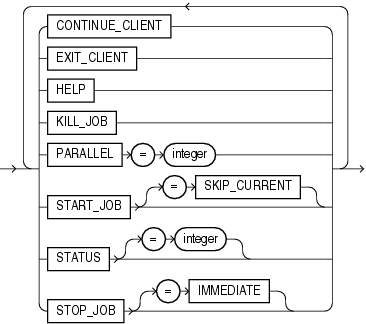

  • Interactive-Command Interface: Stops logging to the terminal and displays the Import prompt, from which you can enter various commands, some of which are specific to interactive-command mode. This mode is enabled by pressing Ctrl+C during an import operation started with the command-line interface or the parameter file interface. Interactive-command mode is also enabled when you attach to an executing or stopped job.
    For a complete description of the commands available in interactive-command mode, see Commands Available in Import's Interactive-Command Mode.

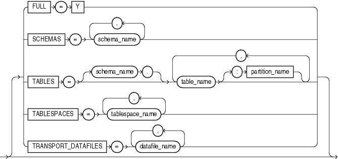

Data Pump Import Modes
One of the most significant characteristics of an import operation is its mode, because the mode largely determines what is imported. The specified mode applies to the source of the operation, either a dump file set or another database if the NETWORK_LINK parameter is specified.
When the source of the import operation is a dump file set, specifying a mode is optional. If no mode is specified, then Import attempts to load the entire dump file set in the mode in which the export operation was run.
The mode is specified on the command line, using the appropriate parameter. The available modes are as follows:
Full Import Mode
A full import is specified using the FULL parameter. In full import mode, the entire content of the source (dump file set or another database) is loaded into the target database. This is the default for file-based imports. You must have the IMP_FULL_DATABASE role if the source is another database.
Cross-schema references are not imported for non-privileged users. For example, a trigger defined on a table within the importing user's schema, but residing in another user's schema, is not imported.
The IMP_FULL_DATABASE role is required on the target database and the EXP_FULL_DATABASE role is required on the source database if the NETWORK_LINK parameter is used for a full import.
See Also:
FULL
Schema Mode
A schema import is specified using the SCHEMAS parameter. In a schema import, only objects owned by the specified schemas are loaded. The source can be a full, table, tablespace, or schema-mode export dump file set or another database. If you have the IMP_FULL_DATABASE role, then a list of schemas can be specified and the schemas themselves (including system privilege grants) are created in the database in addition to the objects contained within those schemas.
Cross-schema references are not imported for non-privileged users unless the other schema is remapped to the current schema. For example, a trigger defined on a table within the importing user's schema, but residing in another user's schema, is not imported.
See Also:
SCHEMAS
Table Mode
A table-mode import is specified using the TABLES parameter. In table mode, only the specified set of tables, partitions, and their dependent objects are loaded. The source can be a full, schema, tablespace, or table-mode export dump file set or another database. You must have the IMP_FULL_DATABASE role to specify tables that are not in your own schema.
See Also:
TABLES
Tablespace Mode
A tablespace-mode import is specified using the TABLESPACES parameter. In tablespace mode, all objects contained within the specified set of tablespaces are loaded, along with the dependent objects. The source can be a full, schema, tablespace, or table-mode export dump file set or another database. For unprivileged users, objects not remapped to the current schema will not be processed.
See Also:
TABLESPACES
Transportable Tablespace Mode
A transportable tablespace import is specified using the TRANSPORT_TABLESPACES parameter. In transportable tablespace mode, the metadata from a transportable tablespace export dump file set or from another database is loaded. The datafiles specified by the TRANSPORT_DATAFILES parameter must be made available from the source system for use in the target database, typically by copying them over to the target system.
This mode requires the IMP_FULL_DATABASE role.
You cannot export transportable tablespaces and then import them into a database at a lower release level. The target database must be at the same or higher release level as the source database.

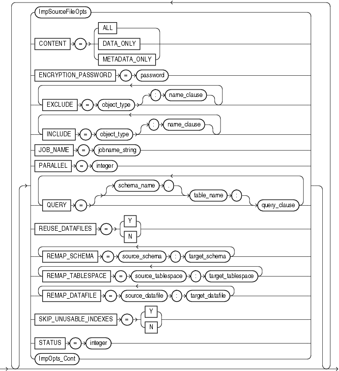

CONTENT
Default: ALL
Purpose
Enables you to filter what is loaded during the import operation.
Syntax and Description
CONTENT={ALL | DATA_ONLY | METADATA_ONLY}
  • ALL loads any data and metadata contained in the source. This is the default.
  • DATA_ONLY loads only table row data into existing tables; no database objects are created.
  • METADATA_ONLY loads only database object definitions; no table row data is loaded.
Example
The following is an example of using the CONTENT parameter. You can create the expfull.dmp dump file used in this example by running the example provided for the Export FULL parameter. See FULL.
> impdp hr/hr DIRECTORY=dpump_dir1 DUMPFILE=expfull.dmp CONTENT=METADATA_ONLY
This command will execute a full import that will load only the metadata in the expfull.dmp dump file. It executes a full import because that is the default for file-based imports in which no import mode is specified.

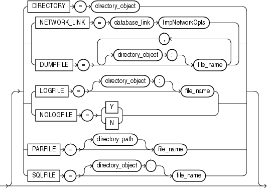

DIRECTORY
Default: DATA_PUMP_DIR
Purpose
Specifies the default location in which the import job can find the dump file set and where it should create log and SQL files.
DIRECTORY=directory_object
The directory_object is the name of a database directory object (not the name of an actual directory). Upon installation, privileged users have access to a default directory object named DATA_PUMP_DIR. Users with access to DATA_PUMP_DIR need not use the DIRECTORY parameter at all.
A directory object specified on the DUMPFILE, LOGFILE, or SQLFILE parameter overrides any directory object that you specify for the DIRECTORY parameter. You must have Read access to the directory used for the dump file set and Write access to the directory used to create the log and SQL files.
Example
The following is an example of using the DIRECTORY parameter. You can create the expfull.dmp dump file used in this example by running the example provided for the Export FULL parameter. See FULL.
LOGFILE=dpump_dir2:expfull.log
This command results in the import job looking for the expfull.dmp dump file in the directory pointed to by the dpump_dir1 directory object. The dpump_dir2 directory object specified on the LOGFILE parameter overrides the DIRECTORY parameter so that the log file is written to dpump_dir2.
See Also:
DUMPFILE
Default: expdat.dmp
Purpose
Specifies the names and optionally, the directory objects of the dump file set that was created by Export.
DUMPFILE=[directory_object:]file_name [, ...]
The directory_object is optional if one has already been established by the DIRECTORY parameter. If you do supply a value here, it must be a directory object that already exists and that you have access to. A database directory object that is specified as part of the DUMPFILE parameter overrides a value specified by the DIRECTORY parameter.
The file_name is the name of a file in the dump file set. The filenames can also be templates that contain the substitution variable, %U. If %U is used, Import examines each file that matches the template (until no match is found) in order to locate all files that are part of the dump file set. The %U expands to a 2-digit incrementing integer starting with 01.
Sufficient information is contained within the files for Import to locate the entire set, provided the file specifications in the DUMPFILE parameter encompass the entire set. The files are not required to have the same names, locations, or order that they had at export time.
Example
The following is an example of using the Import DUMPFILE parameter. You can create the dump files used in this example by running the example provided for the Export DUMPFILE parameter. See DUMPFILE.
> impdp hr/hr DIRECTORY=dpump_dir1 DUMPFILE=dpump_dir2:exp1.dmp, exp2%U.dmp
Because a directory object (dpump_dir2) is specified for the exp1.dmp dump file, the import job will look there for the file. It will also look in dpump_dir1 for dump files of the form exp2<nn>.dmp. The log file will be written to dpump_dir1.

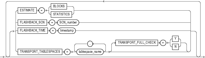

ESTIMATE
Default: BLOCKS
Purpose
Instructs the source system in a network import operation to estimate how much data will be generated.
ESTIMATE={BLOCKS | STATISTICS}
The valid choices for the ESTIMATE parameter are as follows:
  • BLOCKS - The estimate is calculated by multiplying the number of database blocks used by the source objects times the appropriate block sizes.
  • STATISTICS - The estimate is calculated using statistics for each table. For this method to be as accurate as possible, all tables should have been analyzed recently.
The estimate that is generated can be used to determine a percentage complete throughout the execution of the import job.
Restrictions
The Import ESTIMATE parameter is valid only if the NETWORK_LINK parameter is also specified.
When the import source is a dump file set, the amount of data to be loaded is already known, so the percentage complete is automatically calculated.

FLASHBACK_SCN
Default: none
Purpose
Specifies the system change number (SCN) that Import will use to enable the Flashback utility.
FLASHBACK_SCN=scn_number
The import operation is performed with data that is consistent as of the specified scn_number.
If you are on a logical standby system, the FLASHBACK_SCN parameter is ignored because SCNs are selected by logical standby. See Oracle Data Guard Concepts and Administration for information about logical standby databases.
Restrictions
The FLASHBACK_SCN parameter is valid only when the NETWORK_LINK parameter is also specified.
The FLASHBACK_SCN parameter pertains only to the flashback query capability of Oracle Database 10g release 1. It is not applicable to Flashback Database, Flashback Drop, or any other flashback capabilities new as of Oracle Database 10g release 1.
FLASHBACK_SCN and FLASHBACK_TIME are mutually exclusive.
Example
The following is an example of using the FLASHBACK_SCN parameter.
> impdp hr/hr DIRECTORY=dpump_dir1 FLASHBACK_SCN=123456
NETWORK_LINK=source_database_link
The source_database_link in this example would be replaced with the name of a source database from which you were importing data.
FLASHBACK_TIME
Default: none
Purpose
Specifies the time of a particular SCN.
FLASHBACK_TIME="TO_TIMESTAMP()"
The SCN that most closely matches the specified time is found, and this SCN is used to enable the Flashback utility. The import operation is performed with data that is consistent as of this SCN. Because the TO_TIMESTAMP value is enclosed in quotation marks, it would be best to put this parameter in a parameter file. Otherwise, you might need to use escape characters on the command line in front of the quotation marks. See Use of Quotation Marks On the Data Pump Command Line.
If you are on a logical standby system, the FLASHBACK_TIME parameter is ignored because SCNs are selected by logical standby. See Oracle Data Guard Concepts and Administration for information about logical standby databases.
Restrictions
This parameter is valid only when the NETWORK_LINK parameter is also specified.
The FLASHBACK_TIME parameter pertains only to the flashback query capability of Oracle Database 10g release 1. It is not applicable to Flashback Database, Flashback Drop, or any other flashback capabilities new as of Oracle Database 10g release 1.
FLASHBACK_TIME and FLASHBACK_SCN are mutually exclusive.
Example
You can specify the time in any format that the DBMS_FLASHBACK.ENABLE_AT_TIME procedure accepts,. For example, suppose you have a parameter file, flashback_imp.par, that contains the following:
FLASHBACK_TIME="TO_TIMESTAMP('25-08-2003 14:35:00', 'DD-MM-YYYY HH24:MI:SS')"
You could then issue the following command:
> impdp hr/hr DIRECTORY=dpump_dir1 PARFILE=flashback_imp.par NETWORK_LINK=source_database_link
The import operation will be performed with data that is consistent with the SCN that most closely matches the specified time.
See Also:
Oracle Database Application Developer's Guide - Fundamentals for information about using flashback

LOGFILE
Default: import.log
Purpose
Specifies the name, and optionally, a directory object, for the log file of the import job.
LOGFILE=[directory_object:]file_name
If you specify a directory_object, it must be one that was previously established by the DBA and that you have access to. This overrides the directory object specified with the DIRECTORY parameter. The default behavior is to create import.log in the directory referenced by the directory object specified in the DIRECTORY parameter.
If the file_name you specify already exists, it will be overwritten.
All messages regarding work in progress, work completed, and errors encountered are written to the log file. (For a real-time status of the job, use the STATUS command in interactive mode.)
A log file is always created unless the NOLOGFILE parameter is specified. As with the dump file set, the log file is relative to the server and not the client.
Data Pump Import writes the log file using the database character set. If your client NLS_LANG environment sets up a different client character set from the database character set, then it is possible that table names may be different in the log file than they are when displayed on the client output screen.
Example
The following is an example of using the LOGFILE parameter. You can create the expfull.dmp dump file used in this example by running the example provided for the Export FULL parameter. See FULL.
> impdp hr/hr SCHEMAS=HR DIRECTORY=dpump_dir2 LOGFILE=imp.log
 DUMPFILE=dpump_dir1:expfull.dmp
Because no directory object is specified on the LOGFILE parameter, the log file is written to the directory object specified on the DIRECTORY parameter.

REMAP_SCHEMA
Default: none
Purpose
Loads all objects from the source schema into a target schema.
REMAP_SCHEMA=source_schema:target_schema
Multiple REMAP_SCHEMA lines can be specified, but the source schema must be different for each one. However, different source schemas can map to the same target schema. The mapping may not be 100 percent complete, because there are certain schema references that Import is not capable of finding. For example, Import will not find schema references embedded within the body of definitions of types, views, procedures, and packages.
If the schema you are remapping to does not already exist, the import operation creates it, provided the dump file set contains the necessary CREATE USER metadata for the source schema and you are importing with enough privileges. For example, the following Export commands would create the dump file sets with the necessary metadata to create a schema, because the user SYSTEM has the necessary privileges:
> expdp SYSTEM/password SCHEMAS=hr
> expdp SYSTEM/password FULL=y
If your dump file set does not contain the metadata necessary to create a schema, or if you do not have privileges, then the target schema must be created before the import operation is performed. This is because the unprivileged dump files do not contain the necessary information for the import to create the schema automatically.
If the import operation does create the schema, then after the import is complete, you must assign it a valid password in order to connect to it. The SQL statement to do this, which requires privileges, is:
SQL> ALTER USER [schema_name] IDENTIFIED BY [new_pswd]
Restrictions
Unprivileged users can perform schema remaps only if their schema is the target schema of the remap. (Privileged users can perform unrestricted schema remaps.)
For example, SCOTT can remap his BLAKE's objects to SCOTT, but SCOTT cannot remap SCOTT's objects to BLAKE.
Example
Suppose that you execute the following Export and Import commands to remap the hr schema into the scott schema:
> expdp SYSTEM/password SCHEMAS=hr DIRECTORY=dpump_dir1 DUMPFILE=hr.dmp
> impdp SYSTEM/password DIRECTORY=dpump_dir1 DUMPFILE=hr.dmp
REMAP_SCHEMA=hr:scott
In this example, if user scott already exists before the import, then the Import REMAP_SCHEMA command will add objects from the hr schema into the existing scott schema. You can connect to the scott schema after the import by using the existing password (without resetting it).
If user scott does not exist before you execute the import operation, Import automatically creates it with an unusable password. This is possible because the dump file, hr.dmp, was created by SYSTEM, which has the privileges necessary to create a dump file that contains the metadata needed to create a schema. However, you cannot connect to scott on completion of the import, unless you reset the password for scott on the target database after the import completes.
REMAP_TABLESPACE
Default: none
Purpose
Remaps all objects selected for import with persistent data in the source tablespace to be created in the target tablespace.
REMAP_TABLESPACE=source_tablespace:target_tablespace
Multiple REMAP_TABLESPACE parameters can be specified, but no two can have the same source tablespace. The target schema must have sufficient quota in the target tablespace.
Note that use of the REMAP_TABLESPACE parameter is the only way to remap a tablespace in Data Pump Import. This is a simpler and cleaner method than the one provided in the original Import utility. That method was subject to many restrictions (including the number of tablespace subclauses) which sometimes resulted in the failure of some DDL commands.
By contrast, the Data Pump Import method of using the REMAP_TABLESPACE parameter works for all objects, including the user, and it works regardless of how many tablespace subclauses are in the DDL statement.
Restrictions
Data Pump Import can only remap tablespaces for transportable imports in databases where the compatibility level is 10.1 or later.
Example
The following is an example of using the REMAP_TABLESPACE parameter.
> impdp hr/hr REMAP_TABLESPACE=tbs_1:tbs_6 DIRECTORY=dpump_dir1 DUMPFILE=employees.dmp
REUSE_DATAFILES
Default: n
Purpose
Specifies whether or not the import job should reuse existing datafiles for tablespace creation.
REUSE_DATAFILES={y | n}
If the default (n) is used and the datafiles specified in CREATE TABLESPACE statements already exist, an error message from the failing CREATE TABLESPACE statement is issued, but the import job continues.
If this parameter is specified as y, the existing datafiles are reinitialized. Be aware that specifying Y can result in a loss of data.
Example
The following is an example of using the REUSE_DATAFILES parameter. You can create the expfull.dmp dump file used in this example by running the example provided for the Export FULL parameter. See FULL.
> impdp hr/hr DIRECTORY=dpump_dir1 DUMPFILE=expfull.dmp LOGFILE=reuse.log
REUSE_DATAFILES=Y
This example reinitializes datafiles referenced by CREATE TABLESPACE statements in the expfull.dmp file.
SCHEMAS
Default: none
Purpose
Specifies that a schema-mode import is to be performed.
SCHEMAS=schema_name [,...]
If you have the IMP_FULL_DATABASE role, you can use this parameter to perform a schema-mode import by specifying a list of schemas to import. First, the schemas themselves are created (if they do not already exist), including system and role grants, password history, and so on. Then all objects contained within the schemas are imported. Nonprivileged users can specify only their own schemas or schemas remapped to their own schemas. In that case, no information about the schema definition is imported, only the objects contained within it.
Schema-mode is the default mode when you are performing a network-based import.
Example
The following is an example of using the SCHEMAS parameter. You can create the expdat.dmp file used in this example by running the example provided for the Export SCHEMAS parameter. See SCHEMAS.
> impdp hr/hr SCHEMAS=hr DIRECTORY=dpump_dir1 LOGFILE=schemas.log
DUMPFILE=expdat.dmp
The hr schema is imported from the expdat.dmp file. The log file, schemas.log, is written to dpump_dir1.
SKIP_UNUSABLE_INDEXES
Default: the value of the Oracle Database configuration parameter, SKIP_UNUSABLE_INDEXES.
Purpose
Specifies whether or not Import skips loading tables that have indexes that were set to the Index Unusable state (by either the system or the user).
SKIP_UNUSABLE_INDEXES={y | n}
If SKIP_UNUSABLE_INDEXES is set to y, and a table or partition with an index in the Unusable state is encountered, the load of that table or partition proceeds anyway, as if the unusable index did not exist.
If SKIP_UNUSABLE_INDEXES is set to n, and a table or partition with an index in the Unusable state is encountered, that table or partition is not loaded. Other tables, with indexes not previously set Unusable, continue to be updated as rows are inserted.
If the SKIP_UNUSABLE_INDEXES parameter is not specified, then the setting of the Oracle Database configuration parameter, SKIP_UNUSABLE_INDEXES (whose default value is Y), will be used to determine how to handle unusable indexes.
If indexes used to enforce constraints are marked unusable, then the data is not imported into that table.
This parameter is useful only when importing data into an existing table. It has no practical effect when a table is created as part of an import because in that case, the table and indexes are newly created and will not be marked unusable.
Example
The following is an example of using the SKIP_UNUSABLE_INDEXES parameter. You can create the expfull.dmp dump file used in this example by running the example provided for the Export FULL parameter. See FULL.
> impdp hr/hr DIRECTORY=dpump_dir1 DUMPFILE=expfull.dmp LOGFILE=skip.log
SKIP_UNUSABLE_INDEXES=y
SQLFILE
Default: none
Purpose
Specifies a file into which all of the SQL DDL that Import would have executed, based on other parameters, is written.
SQLFILE=[directory_object:]file_name
The file_name specifies where the import job will write the DDL that would be executed during the job. The SQL is not actually executed, and the target system remains unchanged. The file is written to the directory object specified in the DIRECTORY parameter, unless another directory_object is explicitly specified here. Any existing file that has a name matching the one specified with this parameter is overwritten.
Note that passwords are not included in the SQL file. For example, if a CONNECT statement is part of the DDL that was executed, it will be replaced by a comment with only the schema name shown. In the following example, the dashes indicate that a comment follows, and the hr schema name is shown, but not the password.
-- CONNECT hr
Therefore, before you can execute the SQL file, you must edit it by removing the dashes indicating a comment and adding the password for the hr schema (in this case, the password is also hr), as follows:
CONNECT hr/hr
For Streams and other Oracle database options, anonymous PL/SQL blocks may appear within the SQLFILE output. They should not be executed directly.
Example
The following is an example of using the SQLFILE parameter. You can create the expfull.dmp dump file used in this example by running the example provided for the Export FULL parameter. See FULL.
SQLFILE=dpump_dir2:expfull.sql
A SQL file named expfull.sql is written to dpump_dir2.
STATUS
Default: 0
Purpose
Displays detailed status of the job, along with a description of the current operation. An estimated completion percentage for the job is also returned.
STATUS[=integer]
If you supply a value for integer, it specifies how frequently, in seconds, job status should be displayed in logging mode. If no value is entered or if the default value of 0 is used, no additional information is displayed beyond information about the completion of each object type, table, or partition.
This status information is written only to your standard output device, not to the log file (if one is in effect).
Example
The following is an example of using the STATUS parameter. You can create the expfull.dmp dump file used in this example by running the example provided for the Export FULL parameter. See FULL.
> impdp hr/hr NOLOGFILE=y STATUS=120 DIRECTORY=dpump_dir1 DUMPFILE=expfull.dmp
In this example, the status is shown every two minutes (120 seconds).

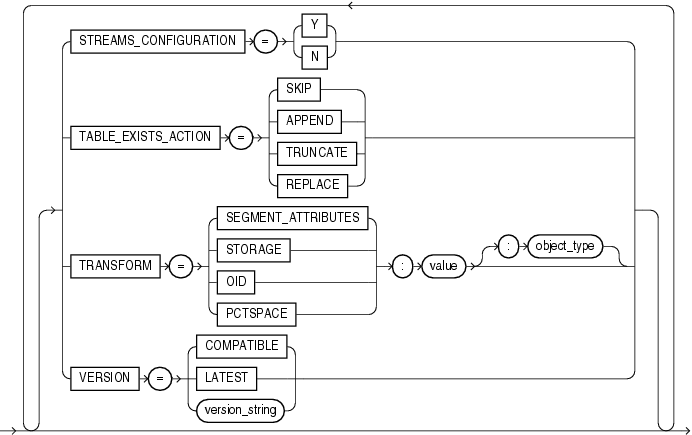

STREAMS_CONFIGURATION
Default: y
Purpose
Specifies whether or not to import any general Streams metadata that may be present in the export dump file.
STREAMS_CONFIGURATION={y | n}
Example
The following is an example of using the STREAMS_CONFIGURATION parameter. You can create the expfull.dmp dump file used in this example by running the example provided for the Export FULL parameter. See FULL.
> impdp hr/hr DIRECTORY=dpump_dir1 DUMPFILE=expfull.dmp STREAMS_CONFIGURATION=n
TABLE_EXISTS_ACTION
Default: SKIP (Note that if CONTENT=DATA_ONLY is specified, the default is APPEND, not SKIP.)
Purpose
Tells Import what to do if the table it is trying to create already exists.
TABLE_EXISTS_ACTION={SKIP | APPEND | TRUNCATE | REPLACE}
The possible values have the following effects:
  • SKIP leaves the table as is and moves on to the next object. This is not a valid option if the CONTENT parameter is set to DATA_ONLY.
  • APPEND loads rows from the source and leaves existing rows unchanged.
  • TRUNCATE deletes existing rows and then loads rows from the source.
  • REPLACE drops the existing table and then creates and loads it from the source. This is not a valid option if the CONTENT parameter is set to DATA_ONLY.
The following considerations apply when you are using these options:
  • When you use TRUNCATE or REPLACE, make sure that rows in the affected tables are not targets of any referential constraints.
  • When you use SKIP, APPEND, or TRUNCATE, existing table-dependent objects in the source, such as indexes, grants, triggers, and constraints, are ignored. For REPLACE, the dependent objects are dropped and re-created from the source, if they were not explicitly or implicitly excluded (using EXCLUDE) and they exist in the source dump file or system.
  • When you use APPEND or TRUNCATE, checks are made to ensure that rows from the source are compatible with the existing table prior to performing any action.
    The existing table is loaded using the external tables access method if the existing tables have active constraints and triggers. However, be aware that if any row violates an active constraint, the load fails and no data is loaded.
    If you have data that must be loaded, but may cause constraint violations, consider disabling the constraints, loading the data, and then deleting the problem rows before reenabling the constraints.
  • When you use APPEND, the data is always loaded into new space; existing space, even if available, is not reused. For this reason, you may wish to compress your data after the load.
Restrictions
  • TRUNCATE cannot be used on clustered tables or over network links.
Example
The following is an example of using the TABLE_EXISTS_ACTION parameter. You can create the expfull.dmp dump file used in this example by running the example provided for the Export FULL parameter. See FULL.
> impdp hr/hr TABLES=employees DIRECTORY=dpump_dir1 DUMPFILE=expfull.dmp
TABLE_EXISTS_ACTION=REPLACE
TABLES
Default: none
Purpose
Specifies that you want to perform a table-mode import.
TABLES=[schema_name.]table_name[:partition_name]
In a table-mode import, you can filter the data that is imported from the source by specifying a comma-delimited list of tables and partitions or subpartitions.
If you do not supply a schema_name, it defaults to that of the current user. To specify a schema other than your own, you must have the IMP_FULL_DATABASE role.
If a partition_name is specified, it must be the name of a partition or subpartition in the associated table.
The use of wildcards with table names is also supported. For example, TABLES=emp% would import all tables having names that start with 'EMP'.
Restrictions
The use of synonyms as values for the TABLES parameter is not supported. For example, if the regions table in the hr schema had a synonym of regn, it would not be valid to use TABLES=regn. An error would be returned.
If you specify more than one table_name, they must all reside in the same schema.
The import of table partitions is not supported when the NETWORK_LINK parameter is used.
Example
The following example shows a simple use of the TABLES parameter to import only the employees and jobs tables from the expfull.dmp file. You can create the expfull.dmp dump file used in this example by running the example provided for the Export FULL parameter. See FULL.
> impdp hr/hr DIRECTORY=dpump_dir1 DUMPFILE=expfull.dmp TABLES=employees,jobs
The following example shows the use of the TABLES parameter to import partitions:
> impdp hr/hr DIRECTORY=dpump_dir1 DUMPFILE=expdat.dmp
TABLES=sh.sales:sales_Q1_2000,sh.sales:sales_Q2_2000
This example imports the partitions sales_Q1_2000 and sales_Q2_2000 for the table sales in the schema sh.
TABLESPACES
Default: none
Purpose
Specifies that you want to perform a tablespace-mode import.
TABLESPACES=tablespace_name [, ...]
Use TABLESPACES to specify a list of tablespace names whose tables and dependent objects are to be imported from the source (full, schema, tablespace, or table-mode export dump file set or another database).
Example
The following is an example of using the TABLESPACES parameter. It assumes that the tablespaces already exist. You can create the expfull.dmp dump file used in this example by running the example provided for the Export FULL parameter. See FULL.
> impdp hr/hr DIRECTORY=dpump_dir1 DUMPFILE=expfull.dmp TABLESPACES=tbs_1,tbs_2,
tbs_3,tbs_4
This example imports all tables that have data in tablespaces tbs_1, tbs_2, tbs_3, and tbs_4.
TRANSFORM
Default: none
Purpose
Enables you to alter object creation DDL for specific objects, as well as for all applicable objects being loaded.
TRANSFORM = transform_name:value[:object_type]
The transform_name specifies the name of the transform. The possible options are as follows:
  • SEGMENT_ATTRIBUTES - If the value is specified as y, then segment attributes (physical attributes, storage attributes, tablespaces, and logging) are included, with appropriate DDL. The default is y.
  • STORAGE - If the value is specified as y, the storage clauses are included, with appropriate DDL. The default is y. This parameter is ignored if SEGMENT_ATTRIBUTES=n.
  • OID - If the value is specified as n, the assignment of the exported OID during the creation of object tables and types is inhibited. Instead, a new OID is assigned. This can be useful for cloning schemas, but does not affect referenced objects. The default value is y.
  • PCTSPACE - The value supplied for this transform must be a number greater than zero. It represents the percentage multiplier used to alter extent allocations and the size of data files.
    Note that you can use the PCTSPACE transform in conjunction with the Data Pump Export SAMPLE parameter so that the size of storage allocations matches the sampled data subset. (See SAMPLE.)
The type of value specified depends on the transform used. Boolean values (y/n) are required for the SEGMENT_ATTRIBUTES, STORAGE, and OID transforms. Integer values are required for the PCTSPACE transform.
The object_type is optional. If supplied, it designates the object type to which the transform will be applied. If no object type is specified then the transform applies to all valid object types. The valid object types for each transform are shown in Table 3-1.
Table 3-1 Valid Object Types For the Data Pump Export TRANSFORM Parameter
SEGMENT_ATTRIBUTES STORAGE OID PCTSPACE
CLUSTER X X   X
CONSTRAINT X X   X
INC_TYPE     X
INDEX X X   X
ROLLBACK_SEGMENT X X   X
TABLE X X X X
TABLESPACE X     X
TYPE     X
Example
For the following example, assume that you have exported the employees table in the hr schema. The SQL CREATE TABLE statement that results when you then import the table is similar to the following:
CREATE TABLE "HR"."EMPLOYEES"
   ( "EMPLOYEE_ID" NUMBER(6,0),
     "FIRST_NAME" VARCHAR2(20),
     "LAST_NAME" VARCHAR2(25) CONSTRAINT "EMP_LAST_NAME_NN" NOT NULL ENABLE,
     "EMAIL" VARCHAR2(25) CONSTRAINT "EMP_EMAIL_NN" NOT NULL ENABLE,
     "PHONE_NUMBER" VARCHAR2(20),
     "HIRE_DATE" DATE CONSTRAINT "EMP_HIRE_DATE_NN" NOT NULL ENABLE,
     "JOB_ID" VARCHAR2(10) CONSTRAINT "EMP_JOB_NN" NOT NULL ENABLE,
     "SALARY" NUMBER(8,2),
     "COMMISSION_PCT" NUMBER(2,2),
     "MANAGER_ID" NUMBER(6,0),
     "DEPARTMENT_ID" NUMBER(4,0)
   ) PCTFREE 10 PCTUSED 40 INITRANS 1 MAXTRANS 255 NOCOMPRESS LOGGING
  STORAGE(INITIAL 10240 NEXT 16384 MINEXTENTS 1 MAXEXTENTS 121
  PCTINCREASE 50 FREELISTS 1 FREELIST GROUPS 1 BUFFER_POOL DEFAULT)
  TABLESPACE "SYSTEM" ;
If you do not want to retain the STORAGE clause or TABLESPACE clause, you can remove them from the CREATE STATEMENT by using the Import TRANSFORM parameter. Specify the value of SEGMENT_ATTRIBUTES as n. This results in the exclusion of segment attributes (both storage and tablespace) from the table.
> impdp hr/hr TABLES=hr.employees \
  DIRECTORY=dpump_dir1 DUMPFILE=hr_emp.dmp \
  TRANSFORM=SEGMENT_ATTRIBUTES:n:table
The resulting CREATE TABLE statement for the employees table would then look similar to the following. It does not contain a STORAGE or TABLESPACE clause; the attributes for the default tablespace for the HR schema will be used instead.
As shown in the previous example, the SEGMENT_ATTRIBUTES transform applies to both storage and tablespace attributes. To omit only the STORAGE clause and retain the TABLESPACE clause, you can use the STORAGE transform, as follows:
  TRANSFORM=STORAGE:n:table
The SEGMENT_ATTRIBUTES and STORAGE transforms can be applied to all applicable table and index objects by not specifying the object type on the TRANSFORM parameter, as shown in the following command:
> impdp hr/hr DIRECTORY=dpump_dir1 DUMPFILE=hr.dmp \
 SCHEMAS=hr TRANSFORM=SEGMENT_ATTRIBUTES:n
TRANSPORT_DATAFILES
Default: none
Purpose
Specifies a list of datafiles to be imported into the target database by a transportable-mode import. The files must already have been copied from the source database system.
TRANSPORT_DATAFILES=datafile_name
The datafile_name must include an absolute directory path specification (not a directory object name) that is valid on the system where the target database resides.
Example
The following is an example of using the TRANSPORT_DATAFILES parameter. Because the TRANSPORT_DATAFILES value is enclosed in quotation marks, Oracle recommends that you use a parameter file to avoid having to use escape characters on the command line. (See Use of Quotation Marks On the Data Pump Command Line.) Assume you have a parameter file, trans_datafiles.par, with the following content:

Exit interactive-command mode CONTINUE_CLIENT
Stop the import client session, but leave the current job running EXIT_CLIENT
Display a summary of available commands HELP
Detach all currently attached client sessions and kill the current job KILL_JOB
Increase or decrease the number of active worker processes for the current job. This command is valid only in the Enterprise Edition. PARALLEL
Restart a stopped job to which you are attached START_JOB
Display detailed status for the current job STATUS
Stop the current job STOP_JOB

Description of impinit.gif follows

ImpModes
Description of impmodes.gif follows
ImpOpts
Description of impopts.gif follows
ImpOpts_Cont
Description of impopts_cont.gif follows
ImpSourceFileOpts
Description of impsourcefileopts.gif follows
