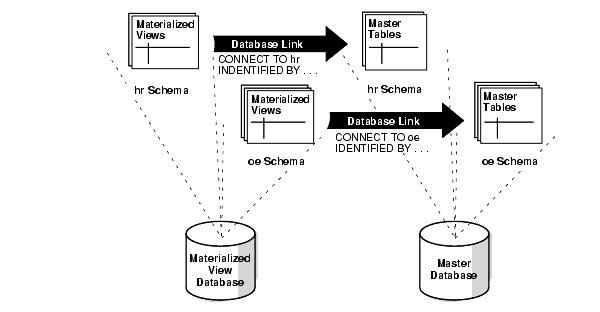

A schema containing a materialized view in a remote database must correspond to the schema that contains the master table in the master database. Therefore, identify the schemas that contain the master tables that you want to replicate with materialized views. After you have identified the target schemas at the master database, create the corresponding accounts with the same names at the remote database. For example, if all master tables are in the sales schema of the ny.world database, then create a corresponding sales schema in the materialized view database sf.world.
See Also:
If you are reviewing the steps in Oracle Database Advanced Replication Management API Reference, then the necessary schemas are created as part of the script described in the instructions for creating a materialized view groupThe defining query of a materialized view can use one or more database links to reference remote table data. Before creating materialized views, the database links you plan to use must be available. Furthermore, the account that a database link uses to access a remote database defines the security context under which Oracle creates and subsequently refreshes a materialized view.
To ensure proper behavior, a materialized view's defining query must use a database link that includes an embedded user name and password in its definition; you cannot use a public database link when creating a materialized view. A database link with an embedded name and password always establishes connections to the remote database using the specified account. Additionally, the remote account that the link uses must have the SELECT privileges necessary to access the data referenced in the materialized view's defining query.
Before creating your materialized views, you need to create several administrative database links. Specifically, you should create a PUBLIC database link from the materialized view site to the master site. Doing so makes defining your private database links easier because you do not need to include the USING clause in each link. You also need private database links from the materialized view administrator to the proxy administrator and from the propagator to the receiver, but, if you use the Replication Management tool's Setup Wizard, then these database links are created for you automatically.
See Also:
The information about security options in Oracle Database Advanced Replication Management API Reference for more informationAfter the administrative database links have been created, a private database link must be created connecting each replicated materialized view schema at the materialized view database to the corresponding schema at the master database. Be sure to embed the associated master database account information in each private database link at the materialized view database. For example, the hr schema at a materialized view database should have a private database link to the master database that connects using the hr username and password.
Figure 6-1 Recommended Schema and Database Link Configuration
For multimaster replication, there must be no Virtual Private Database (VPD) restrictions on the replication propagator and receiver schemas. For materialized views, the defining query for the materialized view cannot be modified by VPD. VPD must return a NULL policy for the schema that performs both the create and refresh of the materialized view. Creating a remote materialized view with a non-NULL VPD policy will not generate an error but might yield incorrect results.

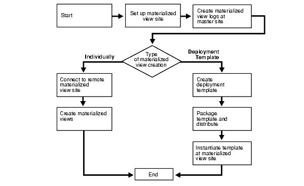

Materialized view environments can be created in several different ways and from several different locations. In most cases, you should use deployment templates at the master site to locally precreate a materialized view environment that will be individually deployed to the target materialized view site.
You can also individually create the materialized view environment by establishing a connection to the materialized view site and building the materialized view environment directly.
See the Replication Management tool's online help for information on using deployment templates to centrally create a materialized view environment using the Replication Management tool.
See the Replication Management tool's online help for information on individually creating the materialized view environment with a direct connection to the remote materialized view site using the Replication Management tool.
Figure 6-2 Flowchart for Creating Materialized Views
The instructions for creating a deployment template in the Oracle Database Advanced Replication Management API Reference manual for information on using deployment templates to centrally precreate a materialized view environment using the replication management API.
The instructions for creating a materialized view group the Oracle Database Advanced Replication Management API Reference manual for information on individually creating the materialized view environment with a direct connection to the remote materialized view site using the replication management API.

If you plan to include materialized view sites in your replication environment, then consider using deployment templates to create the replicated objects at the materialized view sites.
See Also:
Chapter 4, "Deployment Templates Concepts and Architecture" for information about deployment templatesIf you decide to use deployment templates, then you need to prepare your materialized view sites for instantiation. If a deployment template has been designed well, then little preparation is necessary at the remote materialized view site. This section describes the most common preparations that must be performed at the remote materialized view site. After any required preparations have been completed, you are ready to perform either an online or offline instantiation.
Use the following questions to assess which actions are necessary to prepare the remote materialized view site for instantiation:
Does the remote materialized view site have network connectivity to the target master site?
Does the materialized view site have an Oracle8i Database release 8.1.5 or later database?
Has the remote materialized view site been set up to support materialized view replication?
Do the schemas required by the deployment template exist at the materialized view site?
If required database links are not part of the deployment template, then do the required database links from the materialized view site to the master site exist?
Will you use online instantiation or offline instantiation to instantiate the deployment template at the materialized view sites?
Do the rollback segments that might be required by the deployment template exist at the materialized view site and are they online?
The following sections provide guidance for the issues raised by each of these questions.

Each materialized view site needs several users that have special privileges to support a materialized view site. In addition to having the administrative privileges, these users also participate in the propagation and refreshing of data.

While it is advantageous to include the DDL to create all necessary database links for a remote materialized view site in the deployment template, it is not required. If the database link DDL is not in the deployment template, then manually create the database links to the target master site prior to instantiating the deployment template. The database links are required to populate the materialized views during an online instantiation and are required for the proper maintenance of the materialized view environment.

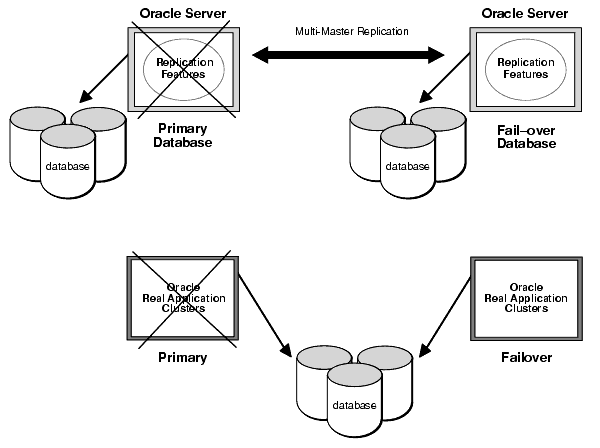

Figure 6-3 Survivability Methods: Replication Or Oracle Real Application Clusters
Oracle Real Application Clusters (RAC) supports fail over to surviving systems when a system supporting an instance of the Oracle server fails. RAC requires a cluster or massively parallel hardware platform, and thus is applicable for protection against processor system failures in the local environment where the cluster or massively parallel system is running.
In these environments, RAC is a good solution for survivability — supporting high transaction volumes with no lost transactions or data inconsistencies in the event of an instance failure. If an instance fails in a RAC environment, then a surviving instance automatically recovers any incomplete transactions. Applications running on the failed system can execute on the fail over system, accessing all data in the database.
RAC does not, however, provide survivability for site failures (such as power outages, flood, fire, or sabotage) that render an entire site, and thus the entire cluster or massively parallel system, inoperable. To provide survivability for site failures, you can use the multimaster replication to maintain a replica of a database at a geographically remote location. In addition, you can use multimaster replication to replicate data between sites running different operating systems or different releases of Oracle or both.
Should the local system fail, the application can continue to execute at the remote site. Using multimaster replication, some administrative procedures might be necessary to recover transactions at the failed site and to prevent data inconsistencies when restarting the failed site.
You can also configure standby database to protect an Oracle database from site failures.See Also:
Oracle Data Guard Concepts and Administration for more information about standby database
