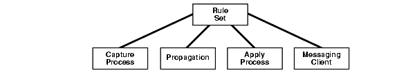

Figure 6-1 illustrates how multiple clients of a rules engine can use one rule set.
Figure 6-1 One Rule Set Can Be Used by Multiple Clients of a Rules Engine
A Streams client performs a task if a message satisfies its rule sets. In general, a message satisfies the rule sets for a Streams client if no rules in the negative rule set evaluate to TRUE
for the message, and at least one rule in the positive rule set evaluates to TRUE
for the message.
"Rule Sets and Rule Evaluation of Messages" contains more detailed information about how a message satisfies the rule sets for a Streams client, including information about Streams client behavior when one or more rule sets are not specified.

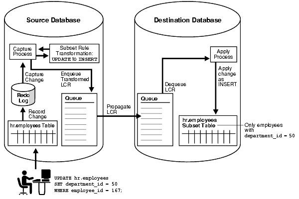

For example, suppose you use a subset rule to specify that a capture process captures changes to the hr.employees
table where the employee's department_id
is 50
using the following subset condition: department_id
50
. Assume that the table at the source database contains records for employees from all departments. If a DML operation changes an employee's department_id
from 80
to 50
, then the capture process with the subset rule converts the update operation into an insert operation and captures the change. Therefore, a row LCR that contains an INSERT
is enqueued into the capture process queue. Figure 6-2 illustrates this example.
Similarly, if a captured update changes an employee's department_id
from 50
to 20
, then a capture process with this subset rule converts the update operation into a DELETE
operation.

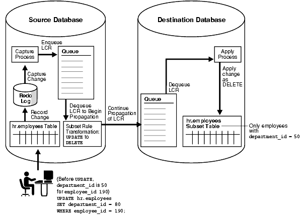

When a subset rule is in the rule set for a propagation, an update operation can be converted into an insert or delete operation when a row LCR is propagated.
For example, suppose you use a subset rule to specify that a propagation propagates changes to the hr.employees
is 50
50
. If the source queue for the propagation contains a row LCR with an update operation on the hr.employees
table that changes an employee's department_id
from 50
to 80
, then the propagation with the subset rule converts the update operation into a delete operation and propagates the row LCR to the destination queue. Therefore, a row LCR that contains a DELETE
is enqueued into the destination queue. Figure 6-3 illustrates this example.
Figure 6-3 Row Migration During Propagation
from 80
to 50
, then a propagation with this subset rule converts the update operation into an INSERT
operation.

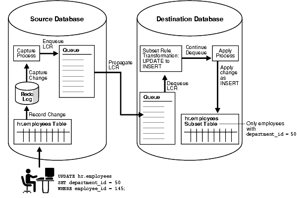

When a subset rule is in the rule set for an apply process, an update operation can be converted into an insert or delete operation when a row LCR is applied.
For example, suppose you use a subset rule to specify that an apply process applies changes to the hr.employees
is 50
50
. Assume that the table at the destination database is a subset table that only contains records for employees whose department_id
is 50
. If a source database captures a change to an employee that changes the employee's department_id
from 80
to 50
, then the apply process with the subset rule at a destination database applies this change by converting the update operation into an insert operation. This conversion is needed because the employee's row does not exist in the destination table. Figure 6-4 illustrates this example.
from 50
to 20
, then an apply process with this subset rule converts the update operation into a DELETE
operation.

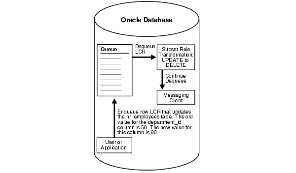

When a subset rule is in the rule set for a messaging client, an update operation can be converted into an insert or delete operation when a row LCR is dequeued.
For example, suppose you use a subset rule to specify that a messaging client dequeues changes to the hr.employees
table when the employee's department_id
is 50
50
. If the queue for a messaging client contains a user-enqueued row LCR with an update operation on the hr.employees
from 50
to 90
, then when a user or application invokes a messaging client with this subset rule, the messaging client converts the update operation into a delete operation and dequeues the row LCR. Therefore, a row LCR that contains a DELETE
is dequeued. The messaging client can process this row LCR in any customized way. For example, it can send the row LCR to a custom application. Figure 6-5 illustrates this example.
Figure 6-5 Row Migration During Dequeue by a Messaging Client
Similarly, if a user-enqueued row LCR contains an update that changes an employee's department_id
from 90
to 50
, then a messaging client with this subset rule converts the UPDATE
operation during dequeue.
