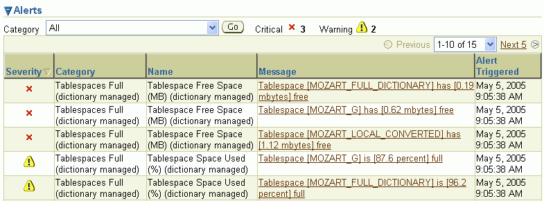

You view alerts by accessing the home page of Enterprise Manager Database Control.
You can also view alerts for locally managed tablespaces with the DBA_OUTSTANDING_ALERTS view. See "Viewing Alert Data" for more information.

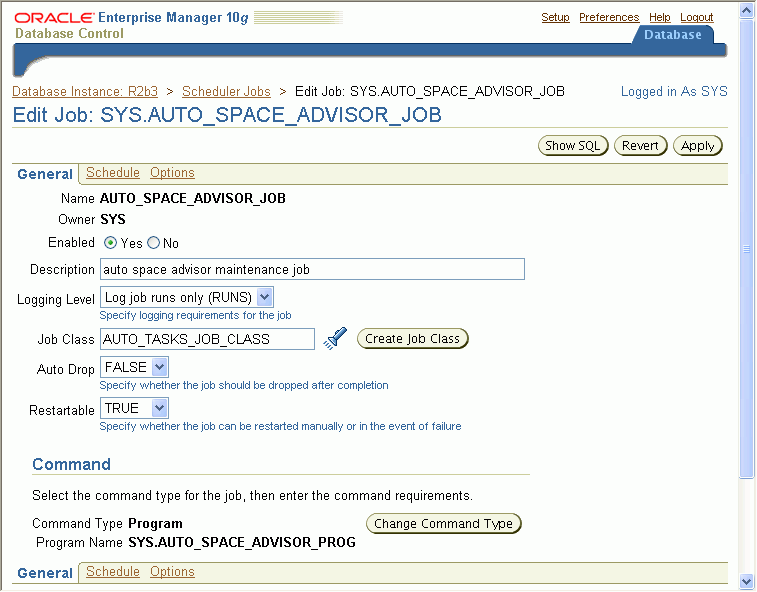

The Automatic Segment Advisor is started by a Scheduler job that is configured to run during the default maintenance window. The default maintenance window is specified in the Scheduler, and is initially defined as follows:
Weeknights, Monday through Friday, from 10:00 p.m. to 6:00 a.m. (8 hours each night)
Weekends, from Saturday morning at 12:00 a.m. to Monday morning at 12:00 a.m. (for a total of 48 hours)

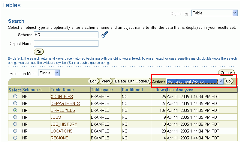

Using the Run Segment Advisor command on a schema object display page.
For example, if you display a list of tables on the Tables page (in the Administration section of Enterprise Manager Database Control), you can select a table and then select the Run Segment Advisor command from the Actions menu.
This method enables you to include the schema object's dependent objects in the Segment Advisor run. For example, if you select a table and select the Run Segment Advisor command, Enterprise Manager displays the table's dependent objects, such as partitions, index segments, LOB segments, and so on. You can then select dependent objects to include in the run.

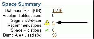

On the database Home page, under the Space Summary heading, click the numeric link next to the title Segment Advisor Recommendations.

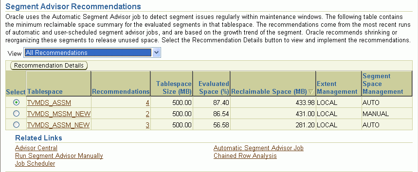

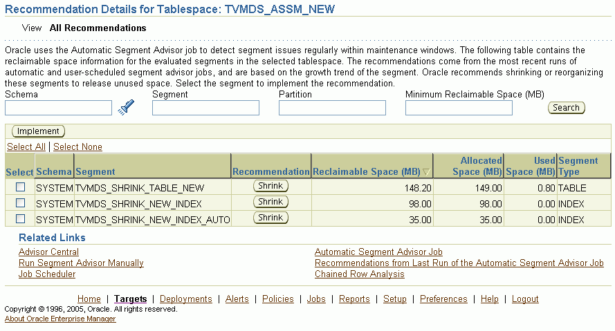

The Segment Advisor Recommendations page appears. Recommendations are organized by tablespace.
Figure 14-3 Segment Advisor Recommendations page
If any recommendations are present, click in the Select column to select a tablespace, and then click Recommendation Details.
The Recommendation Details page appears. You can initiate the recommended activity from this page (shrink or reorganize).
Tip:
The list entries are sorted in descending order by reclaimable space. You can click column headings to change the sort order or to change from ascending to descending order.To view Segment Advisor results with EM—Last Automatic Segment Advisor run:
The Segment Advisor Recommendations page appears. (See Figure 14-3.)
In the View drop-down list, select Recommendations from Last Automatic Run.
The Recommendation Details page appears. (See Figure 14-4.) You can initiate the recommended activity from this page (shrink or reorganize).

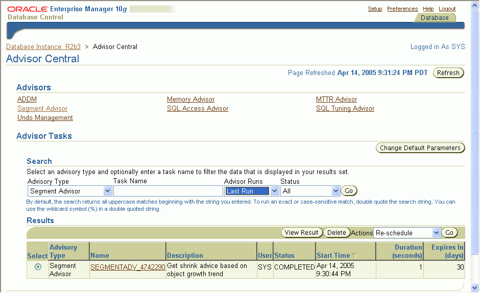

Start at the Advisor Central page.
If you ran the Segment Advisor with the Enterprise Manager wizard, the Advisor Central page appears after you submit the Segment Advisor task. Otherwise, to get to this page, on the database Home page, under Related Links, click Advisor Central.
Check that your task appears in the list under the Results heading. If it does not, complete these steps (See Figure 14-2):
In the Search section of the page, under Advisor Tasks, select Segment Advisor in the Advisory Type list.
Enter the task name. Or, in the Advisor Runs list, select Last Run.
Click Go.
Your Segment Advisor task appears in the Results section.
Check the status of the job. If it is not COMPLETED, click the Refresh button at the top of the page until your task status shows COMPLETED. (Do not use your browser's refresh icon.)
Click the task name.
The Segment Advisor Task page appears, with recommendations organized by tablespace.
Select a tablespace in the list, and then click Recommendation Details.
To view row chaining findings
Under the Related Links heading, click Chained Row Analysis.
The Chained Row Analysis page appears, showing all segments that have chained rows, with a chained rows percentage for each.

The Automatic Segment Advisor is run by a Scheduler job. As such, you can use Enterprise Manager or PL/SQL package procedure calls to modify job attributes to suit your needs. The following are examples of modifications that you can make:
Disable or enable the job
Change the job schedule
Adjust system resources consumed by the job
You can call DBMS_SCHEDULER package procedures to make these changes, but the easier way to is to use Enterprise Manager.
To configure the Automatic Segment Advisor job with Enterprise Manager:
Log in to Enterprise Manager as user SYS or as a user with the following privileges:
ALTER privilege on the Automatic Segment Advisor job SYS.AUTO_SPACE_ADVISOR_JOB
MANAGE SCHEDULER system privilege
Under the Related Links heading, click the link entitled Automatic Segment Advisor Job.
The Automatic Segment Advisor Job page appears.
Click Configure.
The Edit Job page appears. This is the generic Scheduler page that enables you to modify job attributes.
Modify job attributes as needed, including enabling or disabling the job. Click the Help link at the top of the page for information on the Scheduler and on modifying job attributes.
Modify the job schedule, job resource consumption, or other job attributes using the generic Scheduler pages in Enterprise Manager.
To adjust the job schedule, modify the window group SYS.MAINTENANCE_WINDOW_GROUP or its member windows.
To adjust system resources consumed by the job, either modify the job class AUTO_TASKS_JOB_CLASS, associating it with a different resource consumer group, or modify the resource consumer group AUTO_TASK_CONSUMER_GROUP.
