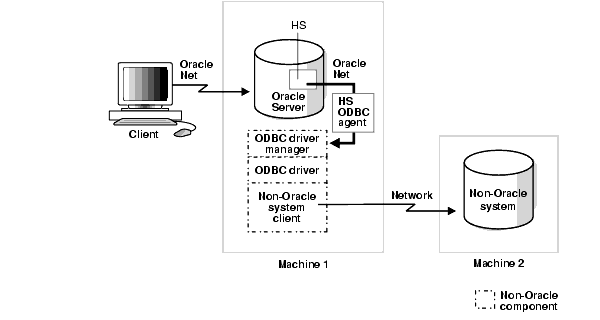

Figure 7-1 shows an example of a configuration in which an Oracle and non-Oracle database are on separate machines, communicating through a Heterogeneous Services ODBC agent.
Figure 7-1 Oracle and Non-Oracle Systems on a Separate Machines
In this configuration:
A client connects to the Oracle database server through Oracle Net.
The Heterogeneous Services component of the Oracle database server connects through Oracle Net to the Heterogeneous Services ODBC agent.
The agent communicates with the following non-Oracle components:
An ODBC driver manager
An ODBC driver
A non-Oracle client application
This client connects to the non-Oracle data store through a network.

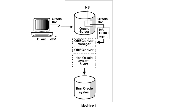

Figure 7-2 shows an example of a configuration in which an Oracle and non-Oracle database are on the same machine, again communicating through a Heterogeneous Services ODBC agent.
Figure 7-2 Oracle and Non-Oracle Systems on the Same Machine
An ODBC driver
The driver then allows access to the non-Oracle data store.
