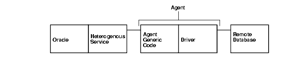

At a high level, Oracle heterogeneous connectivity process architecture is structured as shown in Figure 2-1.
Figure 2-1 Oracle Heterogeneous Connectivity Process Architecture
The Heterogeneous Services component in the Oracle database server talks to a Heterogeneous Services agent process which, in turn, talks to the non-Oracle system. We can conceptually divide the code into three parts:
The Heterogeneous Services component in the Oracle database server.
Most of the processing related to heterogeneous connectivity is done in this module.
Agent generic code.
This is code in the agent that is generic to all Heterogeneous Services products. This consists, for the most part, of code to communicate with the database and multithreading support.
The driver.
This is the module that communicates with the non-Oracle system. It is used to map calls from the Heterogeneous Services onto the native API of the non-Oracle system and it is non-Oracle system specific.
A Heterogeneous Services agent is the process through which an Oracle server connects to a non-Oracle system. This agent process that accesses a non-Oracle system is called a gateway. Access to all gateways goes through the Heterogeneous Services component in the Oracle server and all gateways contain the same agent-generic code. Each gateway has a different driver linked in that maps the Heterogeneous Services to the client API of the non-Oracle system.
The agent process consists of two components. These are agent generic code and a non-Oracle system-specific driver. An agent exists primarily to isolate the Oracle database server from third-party code. In order for a process to access the non-Oracle system, the non-Oracle system client libraries have to be linked into it. In the absence of the agent process, these libraries would have to be directly linked into the Oracle database and problems in this code could cause the Oracle server to go down. Having an agent process isolates the Oracle server from any problems in third-party code so that even if a fatal error takes place, only the agent process will end.

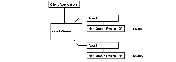

Using Heterogeneous Services, you can access several non-Oracle systems from a single Oracle database. This is illustrated in Figure 2-2, which shows two non-Oracle systems being accessed.
Both agents upload configuration information, which is stored as part of the Heterogeneous Services data dictionary information on the Oracle database server.
Although it is possible to store data dictionary information at one level of granularity by having completely separate definitions in the Heterogeneous Services data dictionary for each individual instance, this can lead to an unnecessarily large amount of redundant data dictionary information. To avoid this, Oracle organizes the Heterogeneous Services data dictionary by two levels of granularity, called class and instance.
A class pertains to a specific type of non-Oracle system. For example, you may want to access the class of Sybase database systems with your Oracle database server. An instance defines specializations within a class. For example, you may want to access several separate instances within a Sybase database system. Each class definition (one level of granularity) is shared by all the particular instances (a second level of granularity) under that class. Further, instance information takes precedence over class information, and class information takes precedence over server-supplied defaults.
For example, suppose that the Oracle database server accesses three instances of Sybase and two instances of Ingres II. Sybase and Ingres II each have their own code, requiring separate class definitions for the Oracle database server to access them. The Heterogeneous Services data dictionary therefore would contain two class definitions, one for Sybase and one for Ingres II, with five instance definitions, one for each instance being accessed by the Oracle database server.
Note that instance level capability and data dictionary information are session-specific and hence are not stored in the Heterogeneous Services data dictionary of the Oracle database server. However, instance level initialization parameters can be stored in the database.

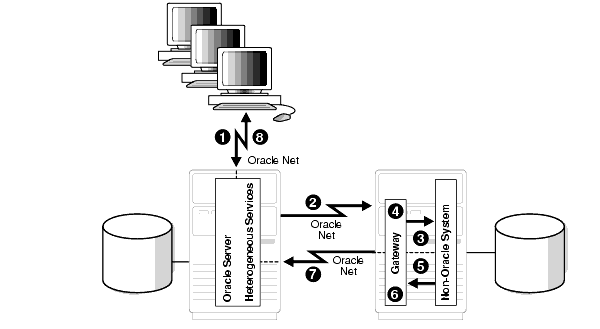

Figure 2-3 shows a typical gateway process flow. The steps explain the sequence of events that occur when a client application queries the non-Oracle database system database through the gateway.
The client application sends a query over Oracle Net to the Oracle database server.
Heterogeneous Services and the gateway converts the Oracle SQL statement into a SQL statement understood by the non-Oracle database system.
The Oracle database server sends the query over to the gateway using Oracle Net.
For the first transaction in a session, the gateway logs into non-Oracle database system using a username and password that is valid in the non-Oracle system.
The gateway retrieves data using non-Oracle database system SQL statements.
The gateway converts retrieved data into a format compatible with the Oracle database server.
The gateway returns query results to the Oracle database server, again using Oracle Net Services.
The Oracle database server passes the query results to the client application using Oracle Net. The database link remains open until the gateway session is finished or the database link is explicitly closed.
