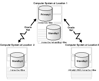

The three basic configuration options are illustrated in Figure 2-1. These include:
A standby database on the same system as the primary database that uses a different directory structure than the primary system. This is illustrated in Figure 2-1 as Standby1.
If you have a standby database on the same system as the primary database, you must use a different directory structure. Otherwise, the standby database attempts to overwrite the primary database files.
A standby database on a separate system that uses the same directory structure as the primary system. This is illustrated in Figure 2-1 as Standby2. This is the recommended method.
A standby database on a separate system that uses a different directory structure than the primary system. This is illustrated in Figure 2-1 as Standby3.
if any database in the Data Guard configuration uses ASM, OMF, or both, then every database in the configuration should use ASM, OMF, or both, respectively. See Chapter 12 for a scenario describing how to set up OMF in a Data Guard configuration.Figure 2-1 Possible Standby Configurations
Table 2-1 describes possible configurations of primary and standby databases and the consequences of each. In the table, note that the service name defaults to the concatenation of the DB_UNIQUE_NAME and DB_DOMAIN initialization parameters. You must specify a unique value for the DB_UNIQUE_NAME initialization parameter when more than one member of a Data Guard configuration resides on the same system. Oracle recommends that the value of the DB_UNIQUE_NAME initialization parameter always be unique, even if each database is located on a separate system.
Table 2-1 Standby Database Location and Directory Options
| Standby System | Directory Structure | Consequences |
Same as primary system |
Different than primary system (required) |
Separate system |
Separate system |
Different than primary system |
