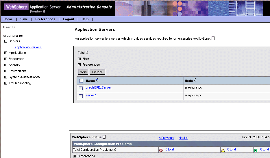

Log in to the WebSphere Console and verify that oracleBPELServer is installed under Servers > Application Servers.

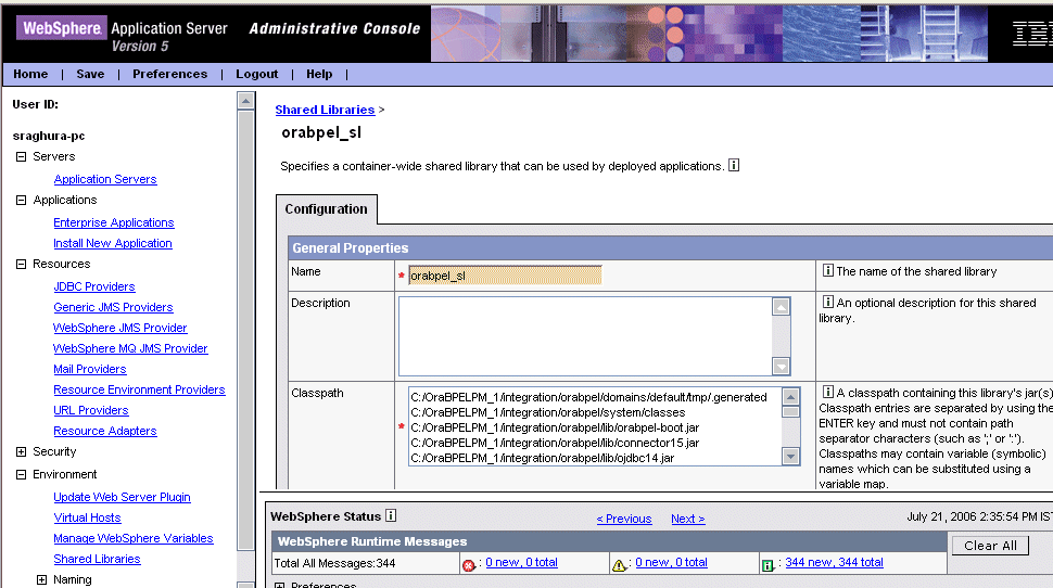

Verify that the orabpel_sl shared library has been created under Environment > Shared Libraries.

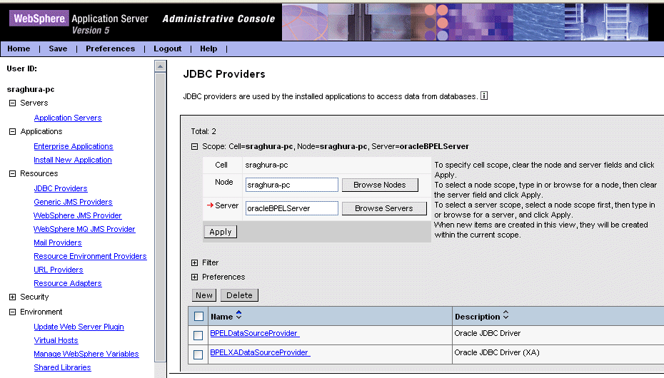

Verify that BPELDataSourceProvider and BPELXADataSourceProvider are created for oracleBPELServer under Resources > JDBC Providers.
Test the database connectivity of the created data sources under Resources > JDBC Providers > BPELDataSourceProvider and Resources > JDBC Providers > BPELXADataSourceProvider.

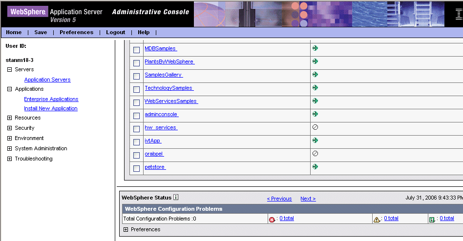

Verify that the orabpel and hw_services application enterprise archives (EARs) are installed under Applications > Enterprise Applications.
