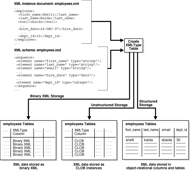

As part of registering an XML schema, Oracle XML DB also performs several tasks that facilitate storing, accessing, and manipulating XML instances that conform to the XML schema. These steps include:
Mapping XML Schema data types to Oracle XML DB storage. When XML schema-based data is stored, its storage data types are derived from the XML Schema data types using a default mapping and, optionally, using mapping information that you specify using XML schema annotations. For binary XML storage, XML Schema types are mapped to binary XML encoding types. For object-relational storage, XML schema registration creates the appropriate SQL object types for the structured storage of conforming documents.
Creating default tables. XML schema registration generates default XMLType tables for all global elements. You can use XML-schema annotations to control the names of the tables, and to provide column-level and table-level storage clauses and constraints for use during table creation.
After XML schema registration, documents that reference the XML schema using the XML Schema instance mechanism can be processed automatically by Oracle XML DB. For XML data that is stored object-relationally, XMLType tables and columns can be created that are constrained to the global elements defined by the XML schema.

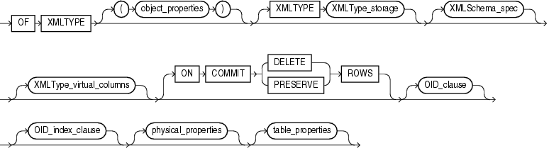

Using Oracle XML DB, developers can create XMLType tables and columns that are constrained to a global element defined by a registered XML schema. After an XMLType column has been constrained to a particular element and a particular XML schema, it can contain only documents that are compliant with the schema definition of that element. You constrain an XMLType table column to a particular element and XML schema by adding appropriate XMLSCHEMA and ELEMENT clauses to the CREATE TABLE operation.
Figure 6-1 shows the syntax for creating an XMLType table:
Figure 6-1 Creating an XMLType Table

The data associated with an XMLType table or column that is constrained to an XML schema can be stored in different ways:
Decomposed and stored object-relationally (structured storage)
Stored as text, using a single CLOB column (unstructured storage)
Stored as binary XML, using a single binary-XML column (binary XML storage)

Structured storage is the default XMLType storage model. With structured storage, collections are mapped into SQL varray values. An XML collection is any element that has maxOccurs > 1, allowing it to appear multiple times. By default, the entire contents of such a varray is serialized using a single LOB column. This storage model provides for optimal ingestion and retrieval of the entire document, but it has significant limitations when it is necessary to index, update, or retrieve individual members of the collection.
You can override the way in which such a varray is stored, forcing the members of the collection to be stored as a set of rows in an ordered collection table. You do this by adding an explicit VARRAY STORE AS clause to the CREATE TABLE statement. You can also add STORE AS clauses for any LOB columns that will be generated by the CREATE TABLE statement. The collection and the LOB column must be identified using SQL object-relational notation.
Example 6-22 shows how to create an XMLType table and a table with an XMLType column, where the contents of the XMLType instance are constrained to a global element defined by a registered XML schema, and the contents of the XMLType instance are stored using SQL objects.

Example 6-22 also shows how to specify that the collection of Action elements and the collection of LineItem elements are each to be stored as a set of rows in ordered collection tables, and how to specify LOB storage clauses for the LOB that will contain the content of the Notes element.
When you store XML data using structured storage, typical relational constraints can be specified for elements and attributes that occur only once in an XML document. Example 6-22 shows how to use object-relational notation to define a unique constraint and a foreign key constraint when creating the table.

Figure 6-2 shows how Oracle XML DB creates XML schema-based XMLType tables using an XML document and a mapping specified in an XML schema. Depending on the storage method specified in the XML schema, an XML instance document is stored either as a binary XML or CLOB value in a single XMLType column, or using multiple object-relational columns.
Figure 6-2 How Oracle XML DB Maps XML Schema-Based XMLType Tables
