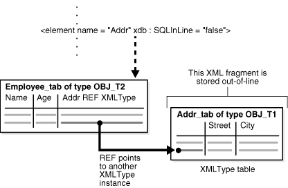

Figure 8-1 illustrates the mapping of complexType to SQL for out-of-line storage.
Figure 8-1 Mapping complexType to SQL for Out-Of-Line Storage
Example 8-3 Setting SQLInline to False for Out-Of-Line Storage
In this example, attribute xdb:SQLInline of element Addr is set to false. The resulting SQL object type, obj_t2, has a column of type XMLType with an embedded REF attribute. The REF attribute points to another XMLType instance of SQL object type obj_t1 in table addr_tab. Table addr_tab is stored out of line. It has columns street and city.

Table emp_tab holds all of the employee information, and it contains an object reference that points to the address information that is stored out of line, in table addr_tab.
The advantage of this model is that it lets you query the out-of-line table (addr_tab) directly, to look up address information. Example 8-4 illustrates querying table addr_tab directly to obtain the distinct city information for all employees.

| 4 | TABLE ACCESS FULL | EMP_TAB_REFLIST | 32 | 640 | 2 (0)| 00:00:01 | | 5 | TABLE ACCESS BY INDEX ROWID| EMP_TAB | 1 | 29 | 1 (0)| 00:00:01 | |* 6 | INDEX UNIQUE SCAN | SYS_C005567 | 1 | | 0 (0)| 00:00:01 |
We can improve performance by creating an index on the REF values in the intermediate table, emp_tab_reflist. This lets Oracle XML DB query the address table, obtain an object reference (REF) to the relevant row, join it with the intermediate table storing the list of REF values, and join that table back with the employee table.
You can create an index on REF values only if the REF is scoped or has a referential constraint. A scoped REF column stores pointers only to objects in a particular table. The REF values in table emp_tab_reflist point only to objects in table addr_tab, so we can create a scope constraint and an index on the REF column, as shown in Example 8-10.
Example 8-10 XPath Rewrite for an Out-Of-Line Collection, with Index on REFs
ALTER TABLE emp_tab_reflist ADD SCOPE FOR (COLUMN_VALUE) IS addr_tab;
CREATE INDEX reflist_idx ON emp_tab_reflist (COLUMN_VALUE);
The explain-plan fragment for the same query as in Example 8-9 shows that index reflist_idx is picked up  — compare with Example 8-9.
|   4 |    TABLE ACCESS BY INDEX ROWID| EMP_TAB_REFLIST |     1 |    20 |     1   (0)| 00:00:01 |
|*  5 |     INDEX RANGE SCAN          | REFLIST_IDX     |     1 |       |     0   (0)| 00:00:01 |
|   6 |   TABLE ACCESS BY INDEX ROWID | EMP_TAB         |       |       |            |          |
|*  7 |    INDEX UNIQUE SCAN          | SYS_C005567     |     1 |       |     0   (0)| 00:00:01 |
In some cases, where the more selective predicates in the query are on the employee table, you might want to set XML schema attribute storeVarrayAsTable to false, in order to store the varray of REF values in line in table emp_tab. Storing the varray in line effectively forces any query involving the two tables emp_tab and addr_tab to always be driven from emp_tab. There is then no way to efficiently join back from the address table. This means that this approach is not appropriate when the number of employees is large, because it involves a full table scan of table emp_tab, which can be expensive.

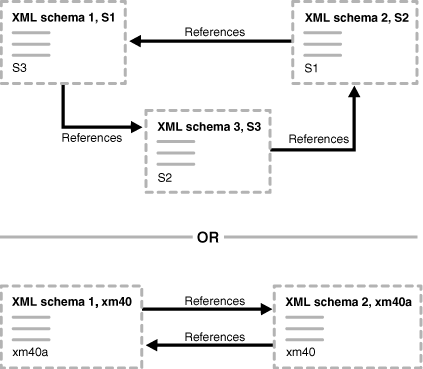

By default, XML schema URL names are always referenced within the scope of the current user. In other words, when database users specify XML schema URLs, they are first resolved as the names of local XML schemas owned by the current user.
If there are no such XML schemas, then they are resolved as names of global XML schemas.
If there are no global XML schemas either, then Oracle XML DB raises an error.
To permit explicit reference to XML schemas in these cases, Oracle XML DB supports the notion of fully qualified XML schema URLs. In this form, the name of the database user owning the XML schema is also specified as part of the XML schema URL, except that such XML schema URLs belong to the Oracle XML DB namespace:
http://xmlns.oracle.com/xdb/schemas/<database-user>/<schemaURL-minus-protocol>
Example 8-11 Using a Fully Qualified XML Schema URL
For example, consider the global XML schema with the following URL:
http://www.example.com/po.xsd
Assume that database user QUINE has a local XML schema with the same URL:
Another user can reference the local XML schema owned by QUINE as follows:
http://xmlns.oracle.com/xdb/schemas/QUINE/www.example.com/po.xsd
Similarly, the fully qualified URL for the global XML schema is:
http://xmlns.oracle.com/xdb/schemas/PUBLIC/www.example.com/po.xsd

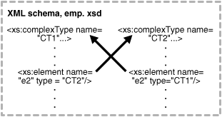

SQL object types do not allow cycles. Cycles in an XML schema are broken while generating the object types, by introducing a REF attribute at the point where the cycle would be completed. Thus, part of the data is stored out of line, but it is still retrieved as part of the parent XML document.
Example 8-21 XML Schema: Cycling Between complexTypes
XML schemas permit cycling between definitions of complexTypes. Figure 8-3 shows this example, where the definition of complexType CT1 can reference another complexType CT2, whereas the definition of CT2 references the first type CT1.
XML schemas permit cycling between definitions of complexTypes. This is an example of cycle of length two:
DECLARE
  doc VARCHAR2(3000) :=
    '<xs:schema xmlns:xs="http://www.w3.org/2001/XMLSchema"
                xmlns:xdb="http://xmlns.oracle.com/xdb">
       <xs:complexType name="CT1" xdb:SQLType="CT1">
         <xs:sequence>
           <xs:element name="e1" type="xs:string"/>
           <xs:element name="e2" type="CT2"/>
         </xs:sequence>
       </xs:complexType>
       <xs:complexType name="CT2" xdb:SQLType="CT2">
         <xs:sequence>
           <xs:element name="e2" type="CT1"/>
         </xs:sequence>
       </xs:complexType>
     </xs:schema>';
BEGIN
  DBMS_XMLSCHEMA.registerSchema('http://www.oracle.com/emp.xsd', doc);
END;
SQL types do not allow cycles in type definitions. However, they do support weak cycles, that is, cycles involving REF (reference) attributes. Cyclic XML schema definitions are mapped to SQL object types in such a way that cycles are avoided by forcing SQLInline = "false" at the appropriate points. This creates a weak SQL cycle.
For the preceding XML schema, the following SQL types are generated:
CREATE TYPE ct1 AS OBJECT (SYS_XDBPD$  XDB.XDB$RAW_LIST_T,
                           "e1"        VARCHAR2(4000),
                           "e2"        REF XMLType) NOT FINAL;
CREATE TYPE ct2 AS OBJECT (SYS_XDBPD$  XDB.XDB$RAW_LIST_T,
                           "e2"        CT1) NOT FINAL;
Figure 8-3 Cross Referencing Between Different complexTypes in the Same XML Schema

In the top half of the illustration, an example of indirect cyclical references between three XML schemas is shown.
In the bottom half of the illustration, an example of cyclical dependencies between two XML schemas is shown. This simpler example is next presented with details.
Figure 8-5 Cyclical References Between XML Schemas
Example 8-23 Cyclic Dependencies
An XML schema that includes another XML schema cannot be created if the included XML schema does not exist.
